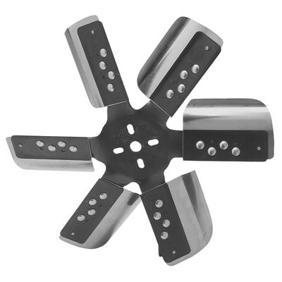

    Just to define "closed center" vs. "open center" flex fans here are some images.
    flex fan closed center.jpg This is what I call a "closed center" flax fan, and this one happened to be a Hayden unit... Terrible! These flow air at the tips, but virtually nothing in the center of the fan. These also have a tendency to build a "wall" at the outlet of the fan shroud when you are traveling at speed, which limits how much air can leave the shroud.
    flex fan open center.jpg This is what I call an "open center" flex fan. Much like the rigid fan HRP was talking about, this one promotes an even airflow all the way across the fan's diameter. Much, Much, Much more efficient.

    The fan as currently explained as an "Open center" is exactly what I'm running. Its like the Derale and Hayden flex fans! By howdy they do pull the air. That other fan is exactly what Walker sells and recommends. Didn't work for my application so it hangs now on the wall with some others. I had a "40 Ford running a 327 with a Walker and was having some cooling issues. They went away after covering the top of the inside grille area and going to the Derale Flex fan. Thanks for your info.

    I resolved the air flow with a much better fan, I used the Hayden Flex fan that can run to 10,000 rpms and is an open center type. At any rate, the air flow is solved at running around town because that fan really does pull the air thru the radiator and condenser. There is an inch all the way around the shroud to the fan. Thanks for the info.
