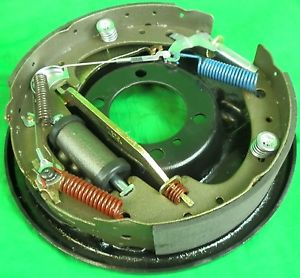

  1. Anyone ever mount a set of 11"x2.25" drum brakes (including all internals AND backing plates) from a Ford 9" to a set of early Ford front hubs/spindles? Is it doable, easy, or? Reason I ask is that John's Industries makes brand new finned aluminum Buick-style drum brake assemblies with all modern (2006 Ford) internals but they are 11" and designed exclusively for big bearing housing ends.
    They are not exactly cheap but really not out of the ballpark from some of the other alternatives (Lincolns).
    For two grand (plus adapting up front) you could have modern, 4 wheel drums with the Buick look - no hidden discs.
    Thanks,
    Steve

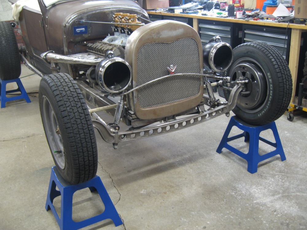

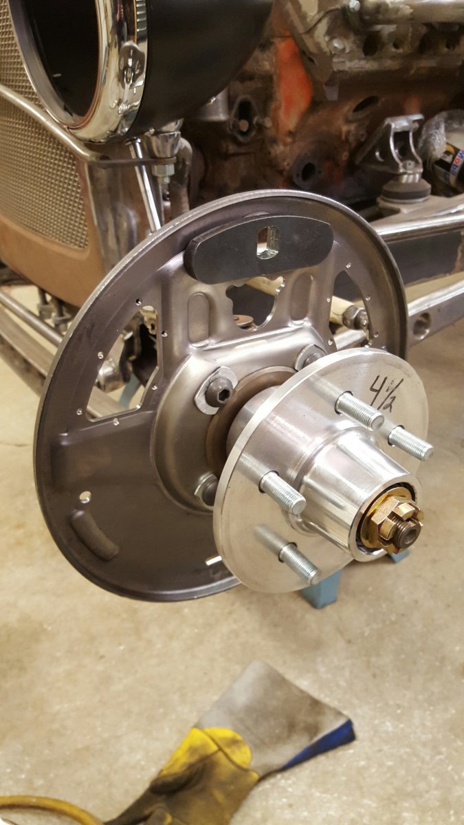

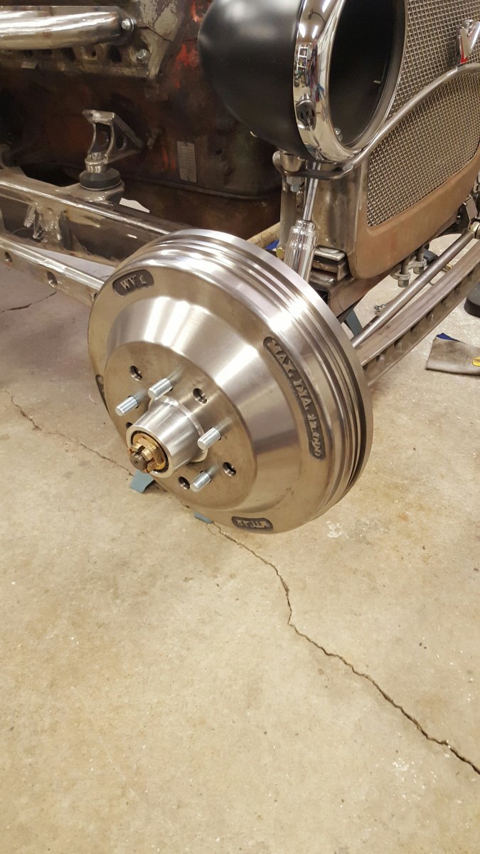

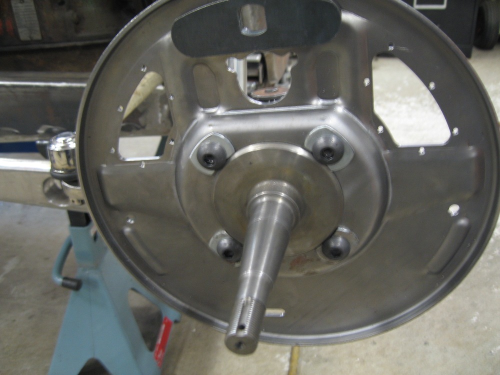

    I'm telling you, this is the way to go. http://www.mtcarproducts.com/productsgrid.html
    20160207_114145_resized (2).jpg 20160207_114131_resized_1 (2).jpg brakes 004 (2).jpg brakes 006 (2).jpg

    Yes, that is true. However, there is an easier way to get fins. The MT products backing plates and internals can be used with Finned Buick drums.
    From their info:
    We offer a full line of backing plate kits that will fit early Ford spindles from 1928 to 1948 and rear axles from 1928 to 1948, also small and large bearing Ford 9" rear ends. The backing plates include the hardware, wheel cylinders, and shoes. Backing plates are available in 1"3/4 (for use with original 1937-1948 drums) or 2" shoes for use with our Lincoln style drums or Finned Buick drums.
    Buy the proper backing plates and hubs then a nice set of Finned aluminum Buick drums and away you go.
    An alternative to trying to make rear brake backing plates work.
    Just trying to show a possibly easier path. :)
    http://www.mtcarproducts.com/Brakes.html
    So, I too could have fins. As far as visual appeal , that is a matter of opinion.
    I think that the visual appeal of the radial fins on the Lincoln drums is spot on.
    Smooth and subtle.
