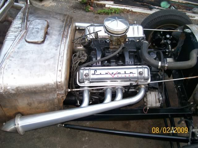

    http://[​IMG][ got mine cleaned up a bit ,running great[​IMG][/IMG]
