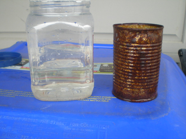

    Two months ago I was using Mol***es to remove rust from my old body panels. A neighbor complained about the smell and I had to shut it down. A fellow HAMBer (oldcarguygazok) from OZ, mentioned that the Ozrodders are starting to use Citric Acid. I got on their site for information and started the search for citrus. The best price I could find locally was $115 for 50 pounds. From what I've been able to find on the OZrodders site, 50 pounds should be close to what I need for my 300 gallon tank. Mol***es was costing me $100 a batch. So, its close cost wise and if you factor in the lack of smell and how much cleaner it is, its a no brainer. I've included some pictures showing a rusty can I put in a test batch. The test batch is not of the correct ratio (It's pretty strong), but was to see how the citrus would dissolve in the cold. The pictures show the can at the start, at 24 hours, at 48 hours and 72 hours. Yah, I know, Its not a door, but I couldn't get it in the jar. Part of the test was to see if it would work a low temps (its been mid 30's - mid 40's). Tonight its going to drop below freezing and I'm curious if the acidity affects the freeze point.

    What do you think of Citric Acid for rust removal ??????
    I was going to try soon for my rear fenders and grill shell.
    Sounds good dollar wise and smells good also?

    I have used citric acid powder mixed with hot water to dissolve the power and it worked very well. So far, I have only done smaller parts and some hardware but it comes out looking amazingly clean... like it just came out of the blast cabinet! I was blown away at how the rust was totally gone!
    However, the parts I have done are only rusty... supposedly it does not clean off any grease or dirty grunge... only rust. There are several websites that discuss the mixing ratios and the temp of the water to use. It seems that keeping the water warm / hot is part of the key to good rust removal... and I stirred the mixture every 30 minutes or so. I have used an old crockpot and that really seems to work the quickest versus ambient temp water. The best part is that it is NOT harmful to anything else. Totally biodegradable so it can just be tossed out after it starts to loose its strength and wont hurt your skin if it touches you.

    I did my dropped axle, leaf springs, spindles and all related front suspension pieces from my Dodge about 2 months ago using Citric Acid bought off of E-bay. The seller offers it in various weight bags and has free shipping. I bought a 5 lb bag to begin and with an 8 ozs to 1 gallon ratio, it works very well and is cost effective. Do a search on Ebay for citric acid and you'll find the seller I'm referring to.

    Acid washes are ok, but they do remove some metal in the process, plus you have to fully neutralize the acid to stop the process. Do a search (on HAMB and the internet) for electrolytic rust removal.
    It's clean, odor free, relatively safe (except for the hydrogen gas), environmentally friendly, inexpensive, and works amazingly.

    In the past, I have used phosphoric acid because it only attacks the rust and doesn't seem to harm the metal. It also leaves a protective coating that prevents rust for quite a long time. You still have to neutralize before painting though or you could have adhesion problems. Also, it's darned expensive.
    Does citric acid it require immediate neutralizing? I know some acids (like muriatic) clean the rust off but then it actually promotes new rust formation.
    How long before it stops working and you have to make a new batch?
