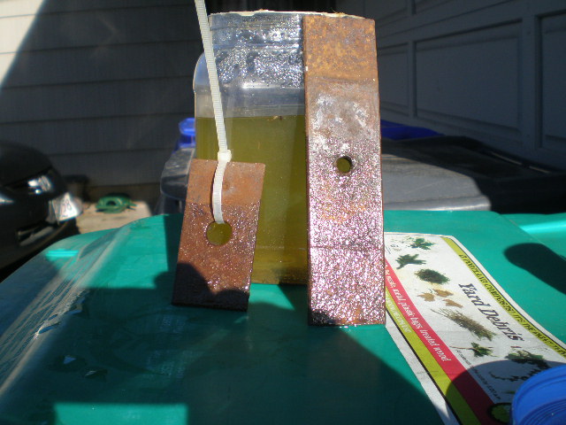

    In my original post I mentioned my concern about cold weather. I put two new pieces of rusty stuff in the jar yesterday to see how it works in the cold. Last night it dropped down to 23 degrees. This morning the jar was full of a very light slush. Too soon to see progress on the rust removal front, but I'm pleased resistance to freezing. Its supposed to drop to 20 tomorrow with a high of only 33 and the rest of the week is the same. I'll check it tomorrow.

    The following before and after pictures show some '30's spring parts that have been in the mix for 3 days and a model A roof bracket thats been soaking for 1 1/2 days. sorry, the before picture is a mating part that wouldn't fit the jar, but was in the same condition. These parts have been in a slushy mixture in sub freezing temps almost the whole time. I'm coming to the conclusion that temperatures have minimal effect on how it works. The temps are going to dip to 15 degrees tonight. I'll see if it freezes.
    Norm

    Day four for the spring parts and two and a half for the bracket. The mix seems to become semi solid at about 20-22 degrees and as far as I can tell still works pretty well. Four days seems to be about what it takes for "normal" rust. That's about a third of the time it took with mol***es. A far cry from what we started with.
