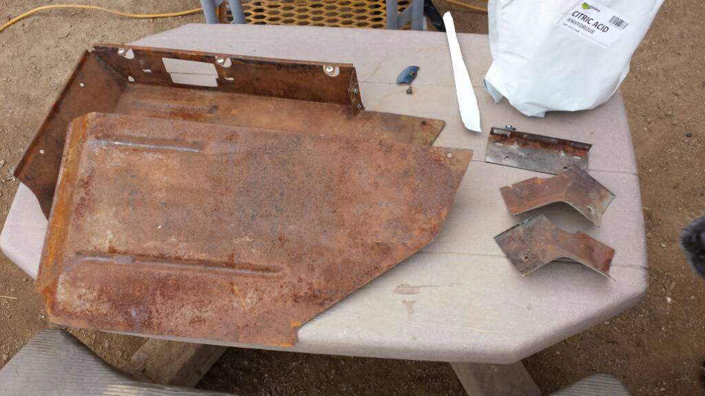

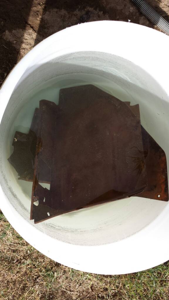

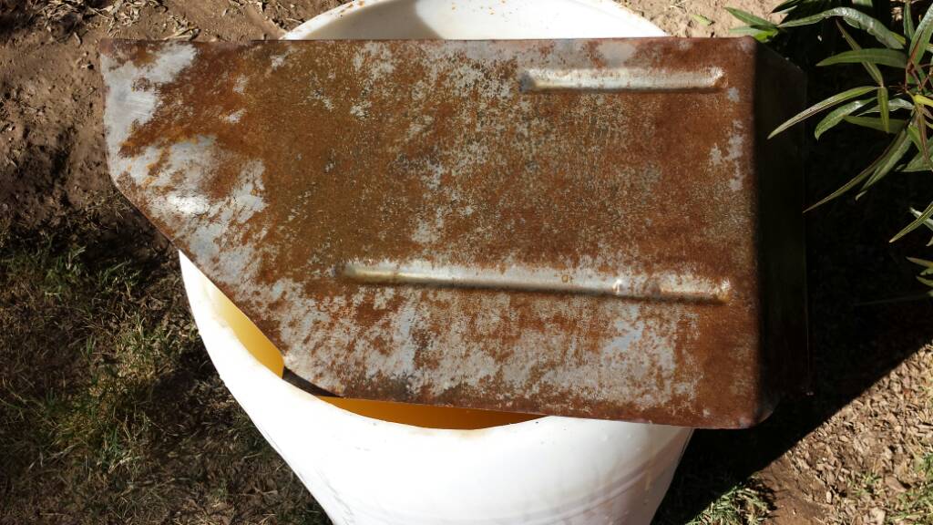

    So after following this for a while now I decided I'd give it a try. So I bought a 5 lb bag off ebay for about 18 bucks and I'm using a 25-30 drum that I cut the top off of and I filled it 3/4 and used a little more than half of my 5 pound bag. Here's the results

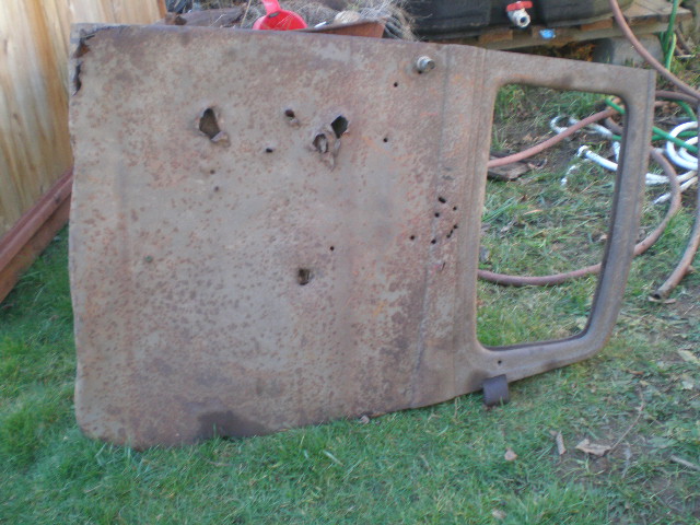

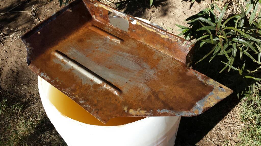

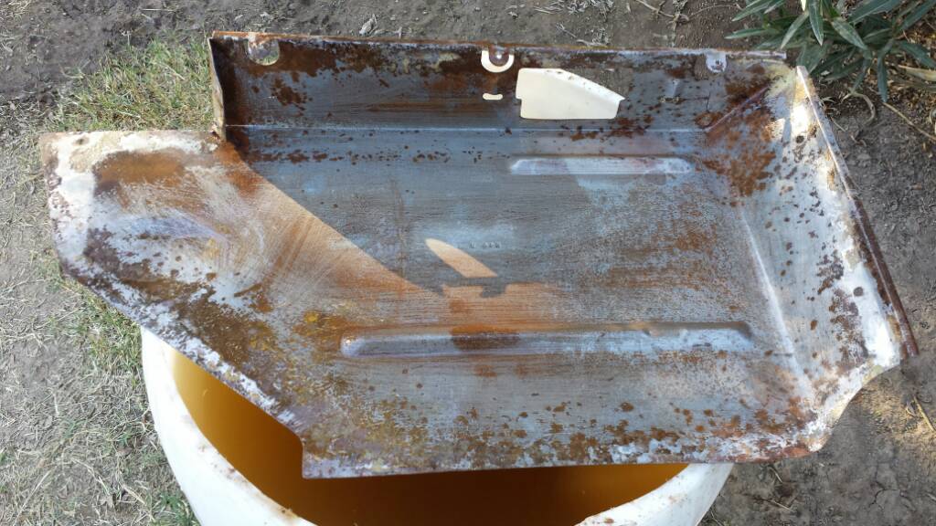

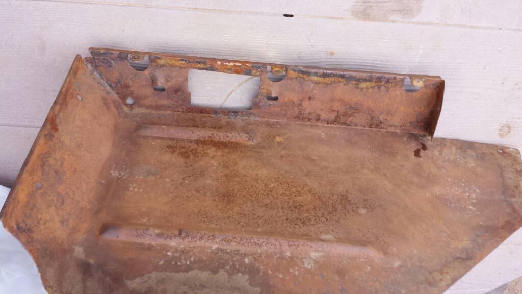

    Here's what my rear door panel backings looked like before I started. There heavily pitted in some places.

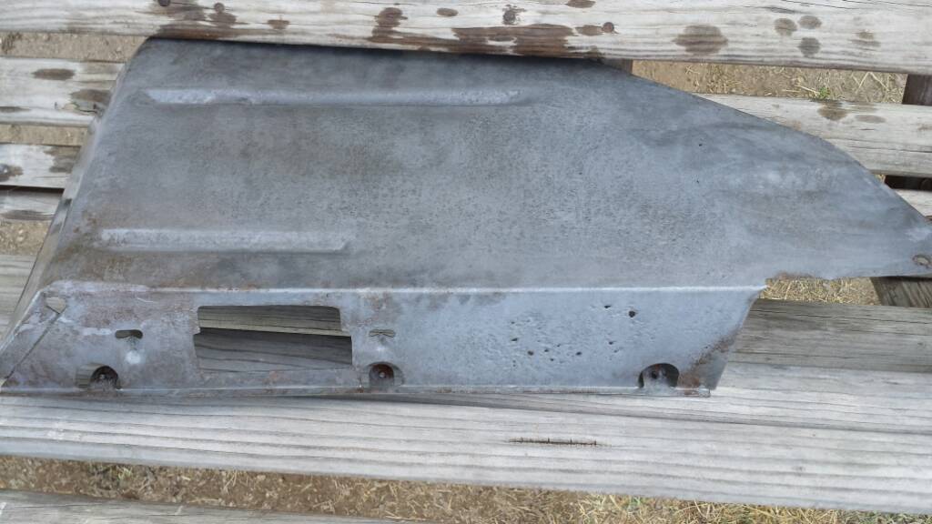

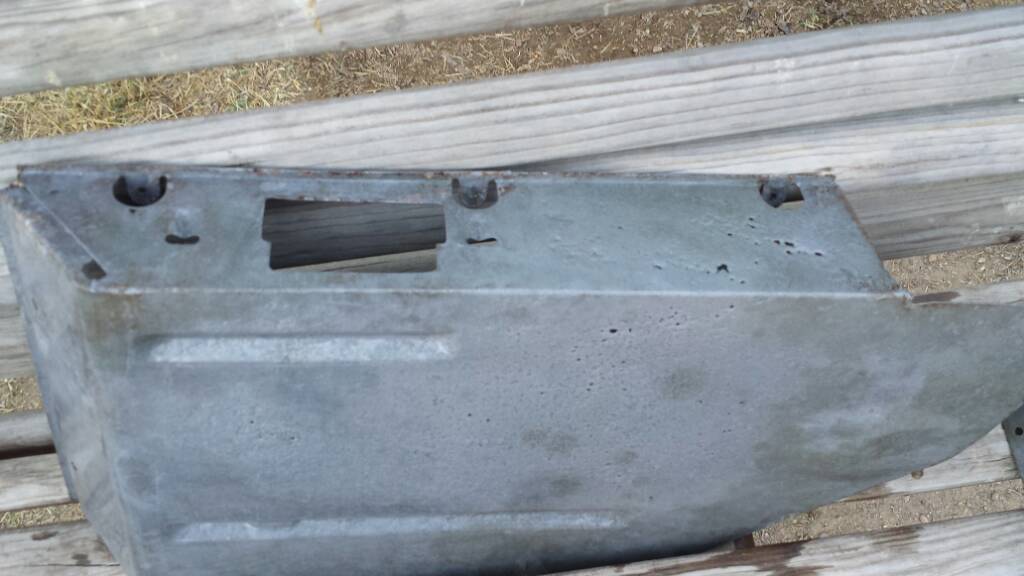

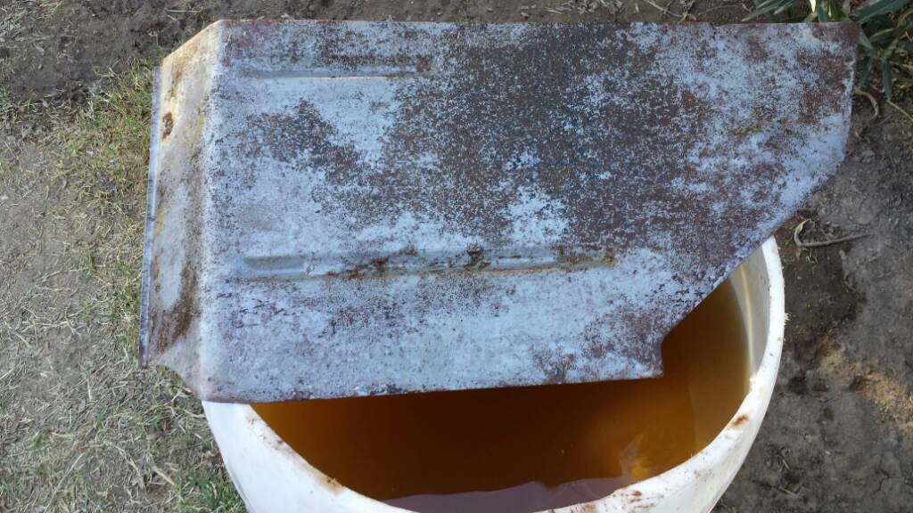

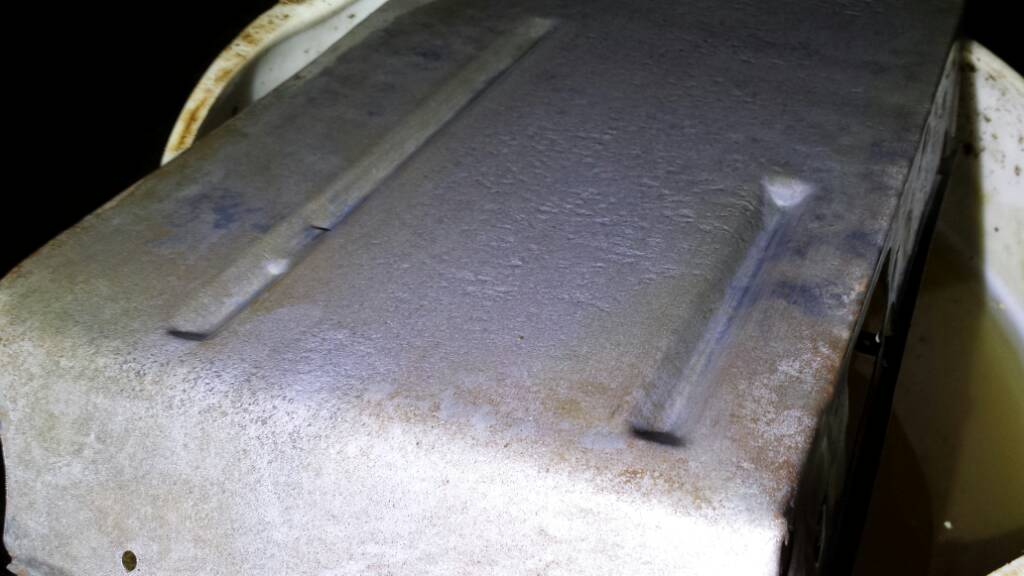

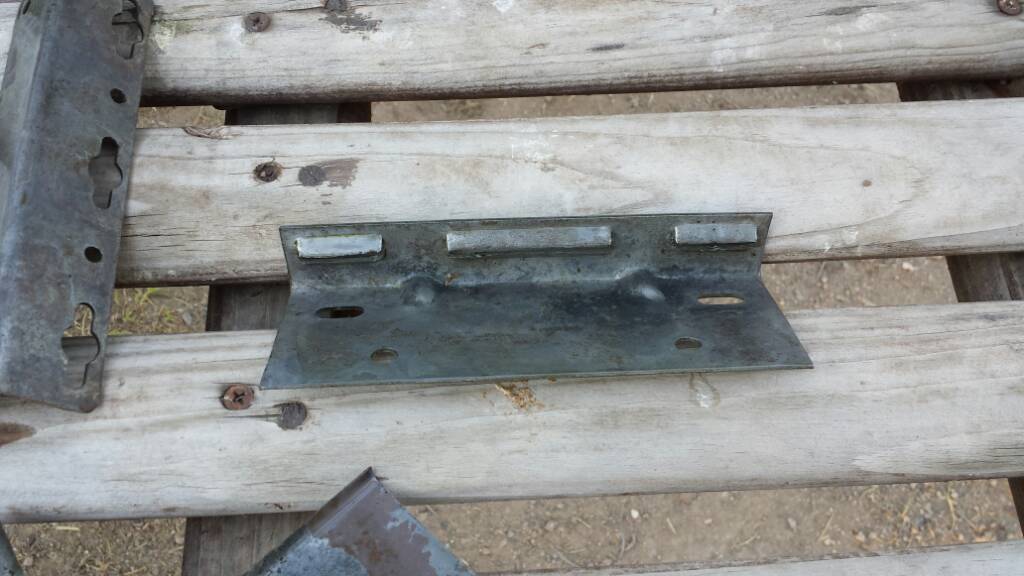

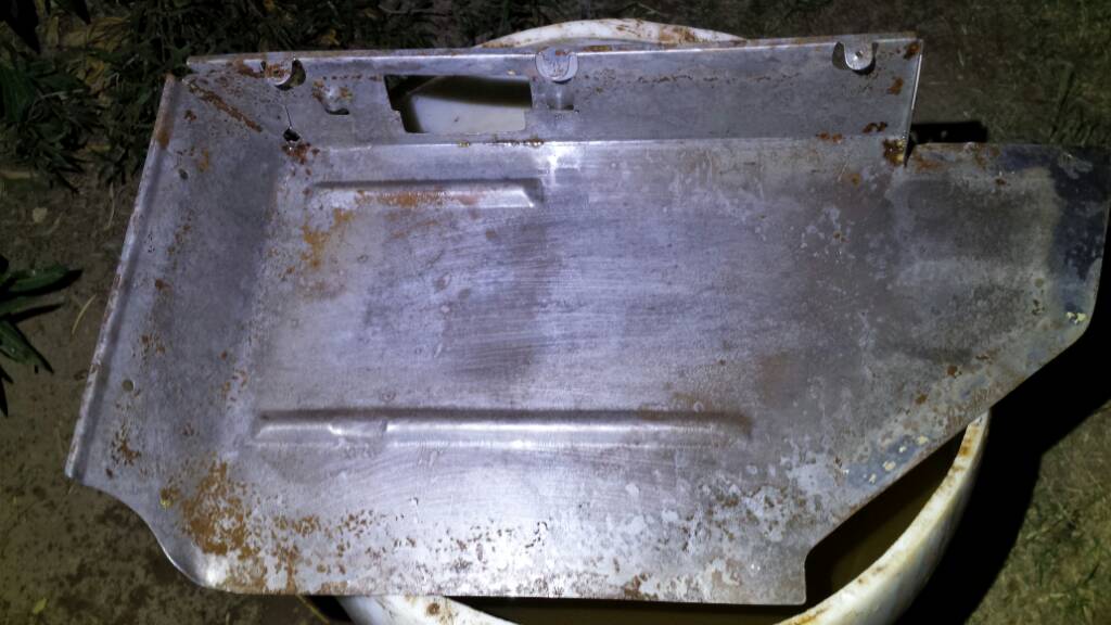

    The first two pics are after 3 hours of soaking and a quick wire brushing and the last two are after 5 or 6 hours and another wire brushing not bad for there first day!

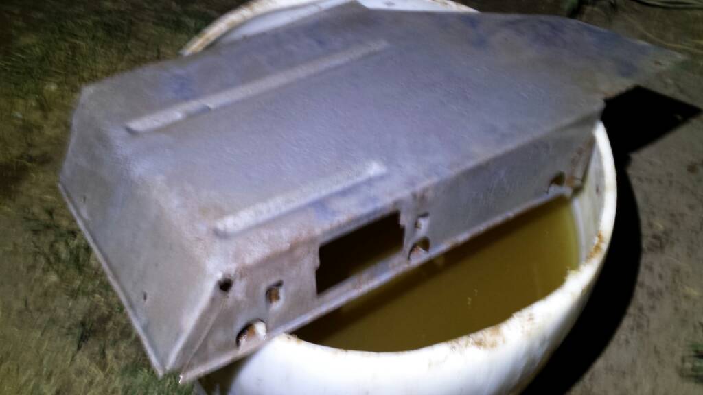

    Day two there almost done!

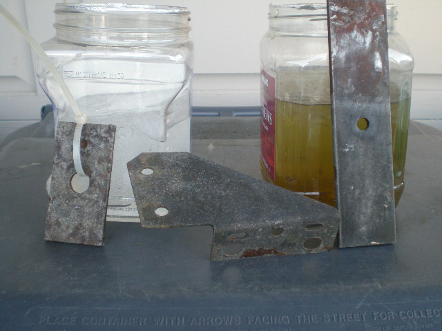

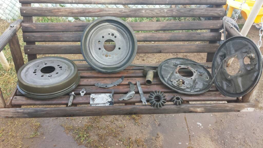

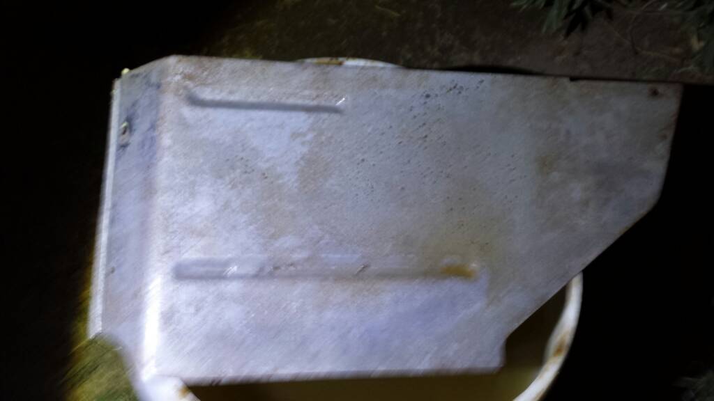

    Day 3 only a few stubborn spots remain! If I were in a hurry I'd use my mini da to get the last remaining spots. I threw an old Carter carb in there today I forgot to take s pic of it but I'm eager to see how it turns out
    In pic 4 you can see that it doesn't remove paint like others have said only rust.

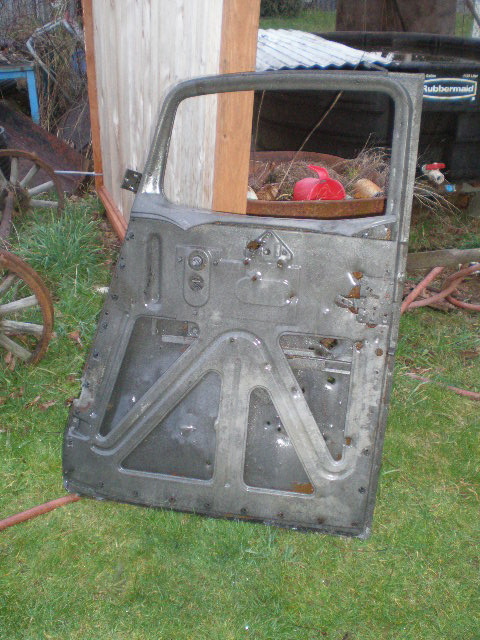

    I tried citric acid on a truck bed that had heavy scale rust and it worked really well.
    This is after 24 hrs
    And this is after 50hrs
    I still had to wire wheel some of the heavier bits but it lifted alot easier after the acid. I just ran a bead of silicone along the back the same height as the sides and filled it in with water and acid.

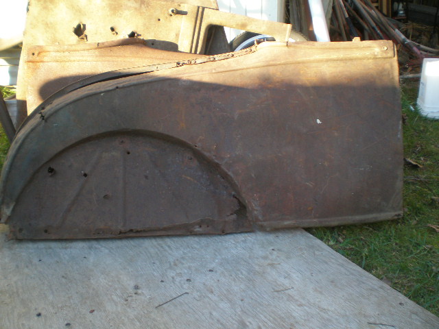

    The sun was shining, the birds were singing and I decided it was time kill some rust. Wasn't sure how the citrus would dissolve, but I needn't have worried. I put about two quart size scoops of the powder into a five gallon bucket and sprayed it with the hose (with nozzle). I think dissolving it in small batches works better than trying to dissolve it in the tank. My tank is 300 gallons and I'm using 50 pounds of citrus. I tested the ph level with the tank Half full and it was 2.2 after the tank was full it was 2.6. I'm thinking that should be great. Loaded the thank with with two '33 Willys doors and three '29 model a roadster quarter panels. I'll check progress in four days. Low temps have been running mid thirties.
