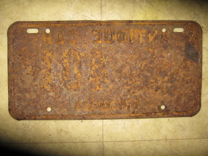

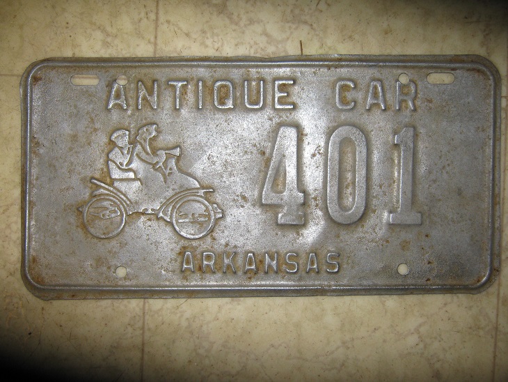

  30. oldwood
    Joined: Mar 13, 2010
    Posts: 1,056
    oldwood
    from arkansas
    I used Vinegar to clean this plate. I got in a hurry and should have soaked it longer but I neutralized it in hot water with dishwashing soap and towel dried and into a warm oven. This is an early '57-'58 Arkansas plate vs. a later plate. The #'s are different.
