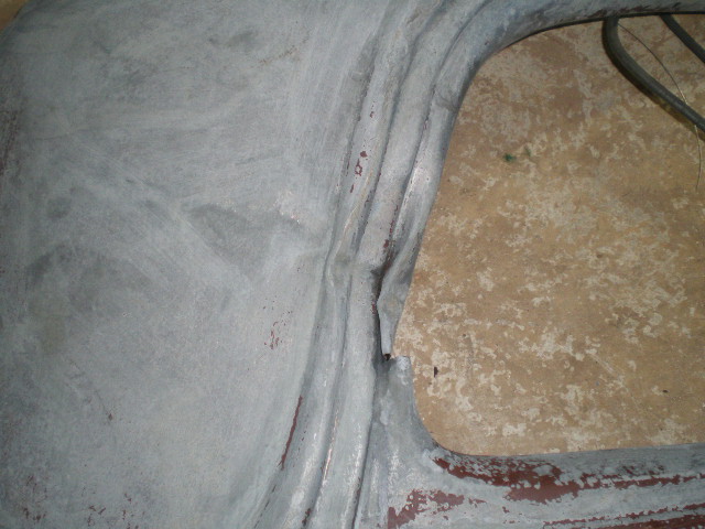

    It's been six? months since I last posted and I've cleaned two bodies plus a bunch of other parts. I'm still using the same batch of citrus and I haven't noticed any slowing of it's action. I'm using a weed sprayer with baking soda to neutralize and another sprayer with Prep-n-Etch to hold off the rust. Here are some of the results.
    Norm

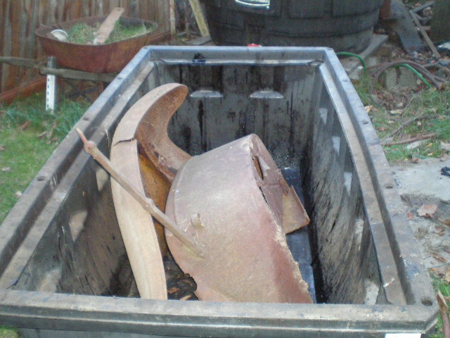

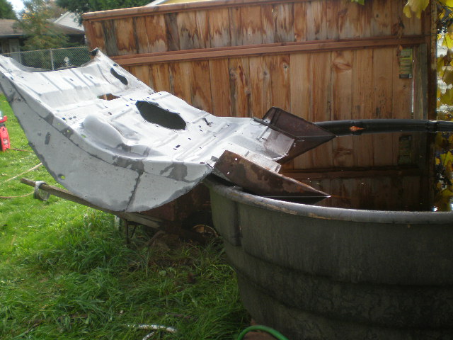

    PC030612.JPG PC030611.JPG Three weeks after I pulled that floor panel out of the citrus I put some model A fenders into the tank.
    Five days later (the standard time), they were only half clean. three days later no better. I checked the mix with my PH meter and it reads 4.8. Four weeks earlier it was 2.8. I thought this stuff was going to go on forever. It was a good run anyway. Cleaned close to two four door bodies plus other ***orted parts for $105. Time for another batch. Found my next tank on an online auction it's a containment tank for controlling oil tank spills. It's 77" x 36" x 36' deep. 275 gallon capacity, but a bit spendy if bought new.
    Norm
    Donald A. Smith likes this.
