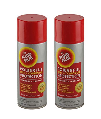

    Totally forgot I just bought a can of this for an OT outboard motor. Screenshot_20220524-164056_Amazon Shopping.jpg

    I cleaned mine up in Evaporust and blasted them with Fluid Film.

    I do too. Works great on squeaky door hinges.

    X2 on Fluid Film.. outstanding product.
