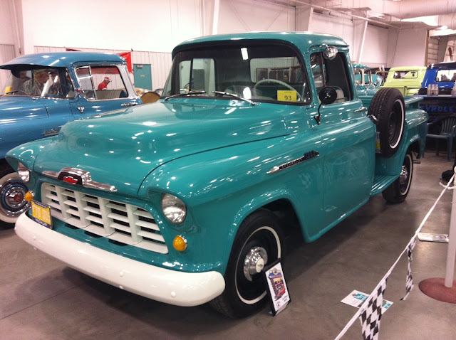

    The POR15 I applied to the undersides of the 1956 Chevrolet truck is still performing well and looking great 3 years later. The truck won 1st Place at the huge Draggins Car Show here in SK, I'm sure partly due to the great OEM "suede" look you get by just brushing POR15 on surfaces.
