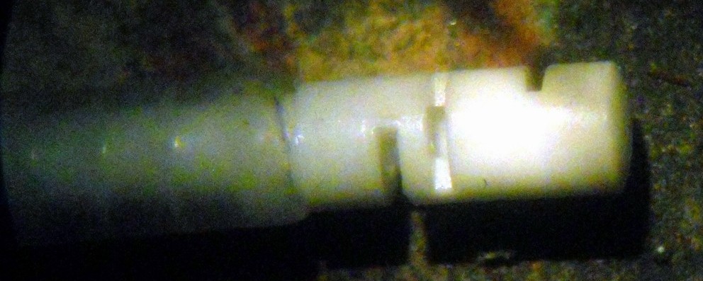

    Just bot the SEM wand since it was under $4 locally.
    Interesting nozzle:
    • It is a small plastic cylinder with a hole bored into it
    • There are 4 "nozzles" located at 90 deg intervals
    • Nozzle is a thin slot cut 1/2 through the cylinder.
    My guess is that a thin fluid will produce nearly a 180 fan from a nozzle while thicker fluids will have reduced fan spread.
    With 4 nozzles, there can be overlap which is OK and if there is not, 4 nozzles still do a pretty good distribution job.
    It also looks like the can spray cap that is included with the nozzle will fit 3M Rust Fighter I spray cans.
    I suspect this nozzle will work good with my "linseed oil pump spray can" setup too.
    Looks like its a great value - not like the 3M wand that is almost 10X the cost (!)

    Here is a pic of the $4 SEM wand. You can see 3 of the 4 slot style nozzles. Very basic. Slot cut to center of the tube. 4 slots at 90 deg angles. Will report how good it works. Rust Preventer Spray Wand SEM.jpg
