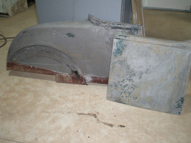

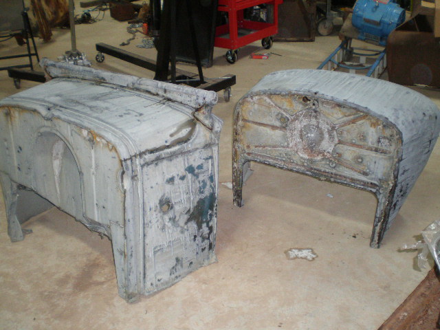

    Hi ... If you want to speed the process up you can hang a couple a pipes in opposite corners and connect 12v battery charger on low...you must keep inspecting the parts every couple of hours or they will disintergrate....I used this method on my T parts (my avatar) took less than a day for same results as 6-10 days just laying in the bath......this is probally safer if you cant watch the derusting processs.....
  18. morac41
    Joined: Jul 23, 2011
    Posts: 531
    morac41
    Hi There is a photo of the cowl in "my albums" ...Track T ... have a look there is a photo with the cowl ..photo called ..setting up...this was before I dumped it in the tank .... another where the cowl is ***embled with doors and tub sections after being in the tank....Cheers Doug

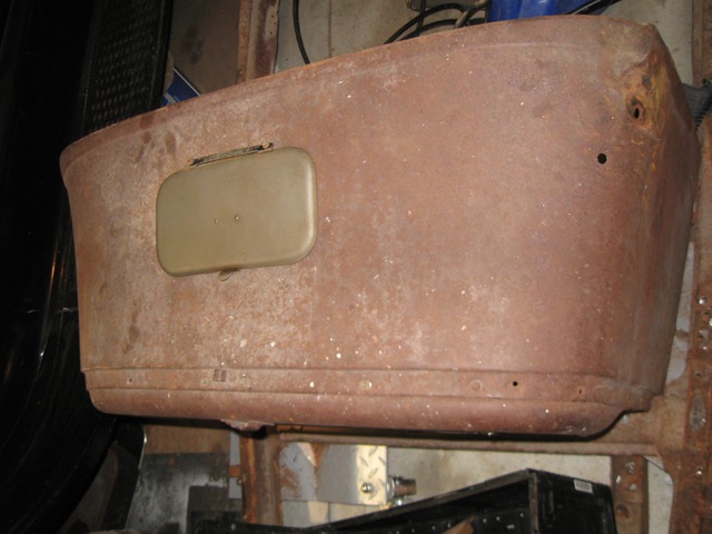

    from Nebraska
    I"m a believer Been soaking my car for 1 1/2 weeks and it takes rust and it blasts off with a pressure washer. But it flashes quick and you need to get something on it quick. Bought WD 40 in a fog can hit it wipe it down, then steel wool and a rag. the smellier it get the better it works. And the deer like it too! The gas lid is on my spare cowl, its in the tank along with 4 '27 wires.

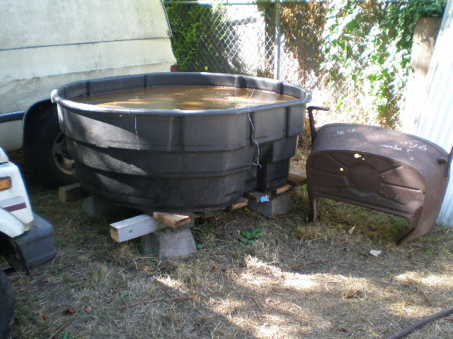

    NORSON
    Heres my setup. I have a 300 gal. stock tank. I fill it with 10 - 3 1/2 gal pails of mol***es @ $10 each and top it off with water. I can get 3 or 4 loads of parts cleaned before it starts to loose it's effectiveness. When I pull the parts from the tank, I hose them off with water (a pressure washer would be better) then brush them with a mix of 3 to 1 of prep and etch (from home depot). I also use a weed killer sprayer to spay the etch into cavities. The etch kills the flash rust and protects the parts from rusting. Etch is used to prepare a surface for painting. The tank would be better if it was square. 48"x60" by three foot tall would be about right. I've been doing this for about three years. all I know I learned from Jimmy B.
    Norm

    NORSON
    An additional note. I wash the parts off on the gr*** in my backyard as well as applying the prep and etch. I drain the used fluid into the sewer. It doesn't kill the gr*** or the dogs. When it gets old and starts to turn black it starts to get ripe then it time to change it. Norm
