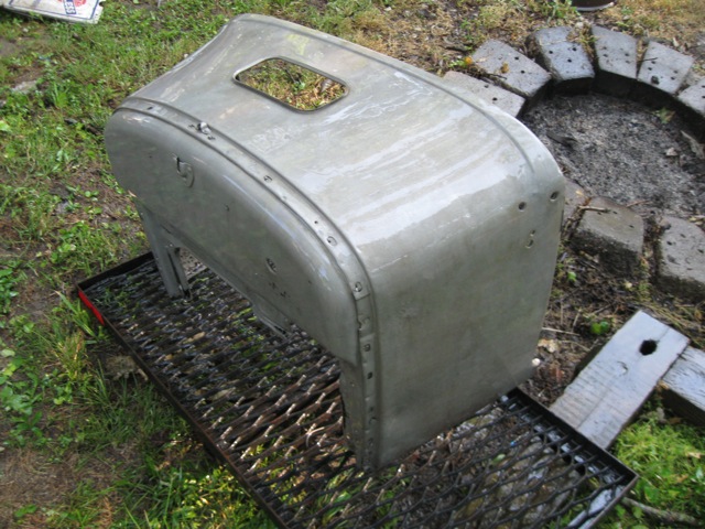

    The flash rust can be stopped and reversed by using Prep and Etch. Some of the parts shown in my previous post are still rust free after two years in storage. It is phosphoric acid and it can also be used to remove rust. Mol***es will remove all the rust but will not eat into the metal.

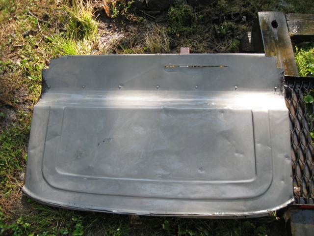

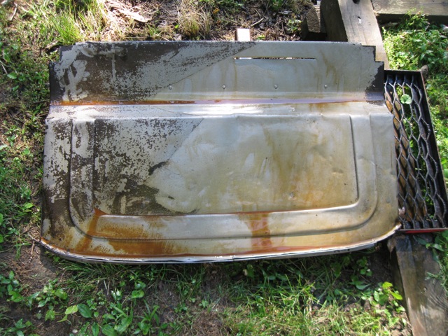

    Here are a couple of more pics, this is what i took out last night I gave some stuff 14 days. Last night our humidity was down around 70% made it much easier to dry. Went from rusty gold to platinum:D
  4. rottenleonard
    Joined: Nov 7, 2008
    Posts: 1,996
    rottenleonard
    Wow that is impressive! You would think that with what the chemical dippers charge to do a car body there would be a mol***as dipping business probability. This looks like a better deal as you are not thinning out the remaining metal.

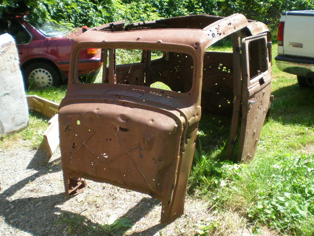

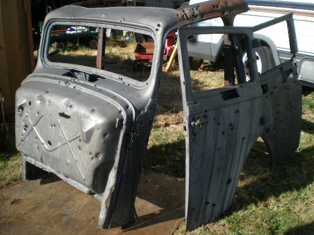

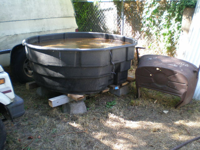

    Put fresh batch of mol***es in the stock tank (300 gals.) and loaded with some Willys parts on the 15th. Pulled the parts today, hosed them off and treated them with phosphoric acid. At ten days the parts were totally rust free. Put in new batch of parts and will see how long it takes this time. I like the idea of adding air to the mix. It may rejuvenate the mixture. What sort of air supply was used. Norm

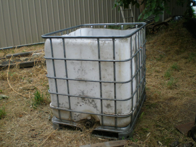

    My dip is an old organic fertiliser container made out of heavy duty plastic with a tap at the bottom they come with a heavy duty stainless steel frame around the outside it's about 5 foot square I got it from a turf farm near me. Holds about 100 litres .To agitate the mixture i have an air gun with a length of copper pipe that reaches to the bottom of the container,couple of bursts with low pressure does the job or stir with a long handled shovel been using mol***es for rust removal for about 15 years.

    Your tank sounds similar to the ones we have here, but ours are smaller. The are the size of our standard shipping pallet. 37" x 45" by 37" tall or 94m x 114m x 94m. I'm thinking about splicing two together (45" x 70" approx.). That would be about 500 gal. It would be easier if I could find a larger standard container.
