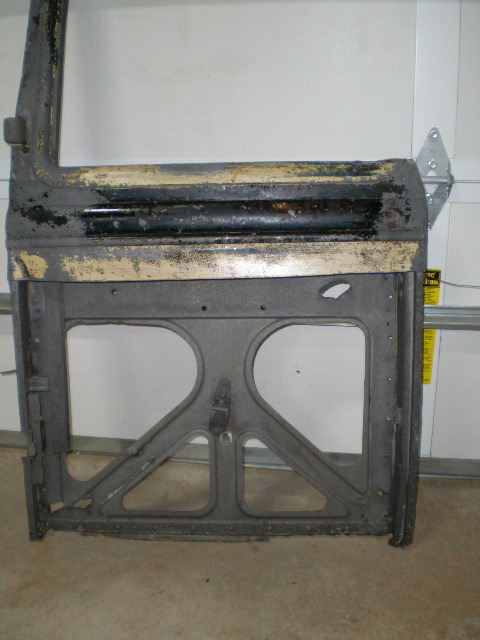

    cool I will ad more pics of other parts I did . Im looking for a 110v high pressure pump, so I can set up a box large enough to do my complete es*** sedan! can someone post a pic of their mix before use? I made mine somewhere around 5:1, it was black before I placed anything in it. Also what is the best mix ratio for powder? I can get that in 55 pound bags vrs 8.00 a gallon.

    Yes, it is black to start but once it becomes used up I find that it turns a different black and the smell is even different once it has eaten the rust.
    I have had a batch on the go for a couple of months now and it just stopped working.
    mikeey rat I agree.. it is cheap and effective. I just didn't want to read after that someone said oh just do this simple thing and it's good to go again.
