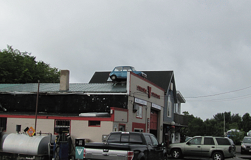

    I p***ed through the area today (Saturday).
    I went to the Co-op entrance in the back and the girl had no idea about the stuff. :(
    Ah well.
    Neat to see the Austin Mini on top of the garage next door for advertizing.

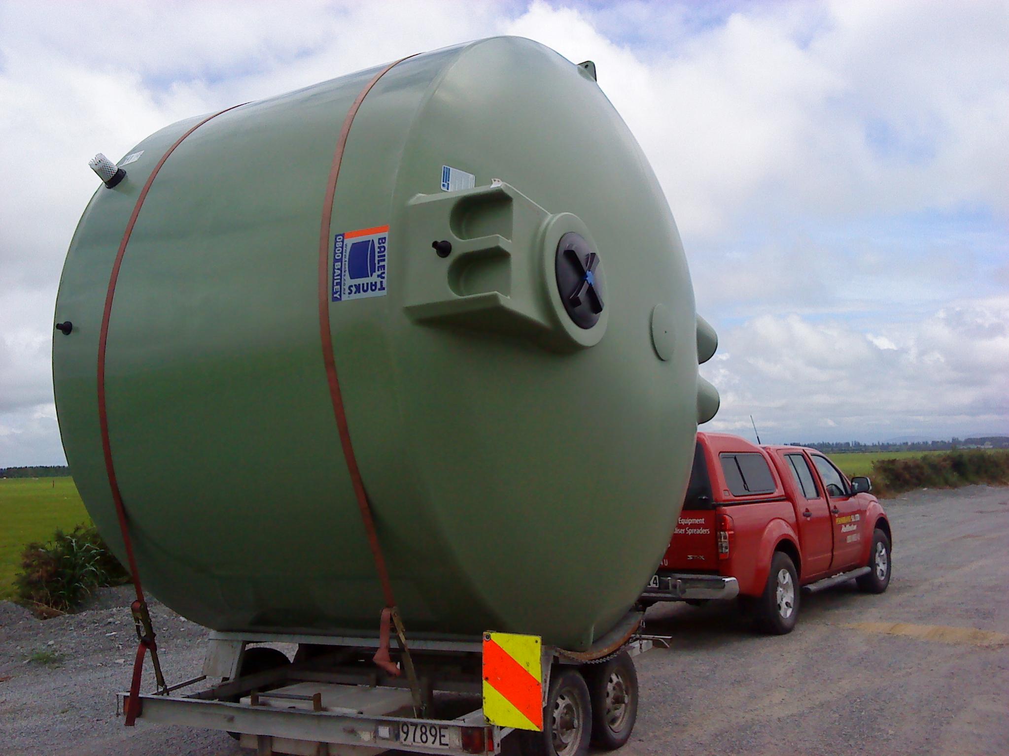

    This is a 25000 l/t tank ,holds 30 tonnes Mol***es I sell , put the whole car in this ;)

    dadseh
    I'll have some of what Kuztom is smokin!
