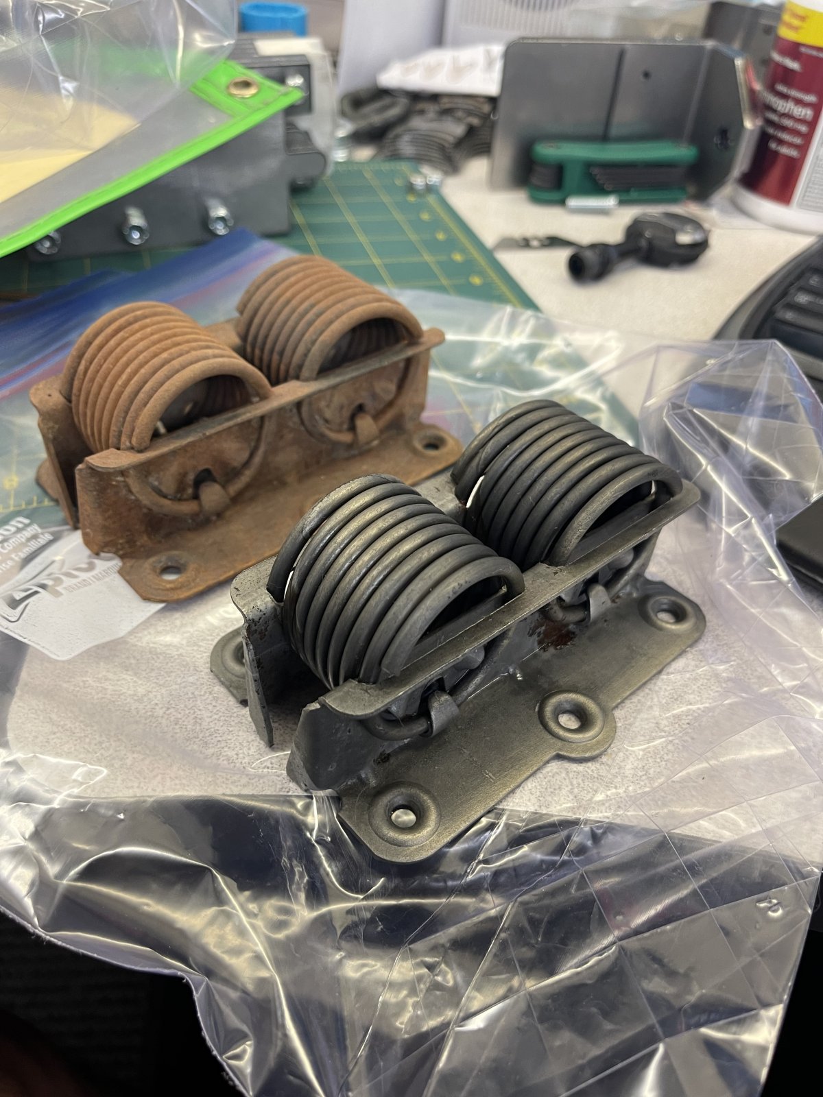

    I came across this video on youtube. Looked interesting enough to give it a try. I was pretty surprised at the results for common household stuff - and I was quite skeptical dropping the first part in.
    Beyond Ballistics did a fantastic job here!
    The '57 Chevy truck door hinge was in the solution for basically 24 hours.
    The rocking chair spring was in for 15-16 hours and is next to the control group "twin".
    I think all in the cost of the supplies is less than a couple of bucks per mixture.

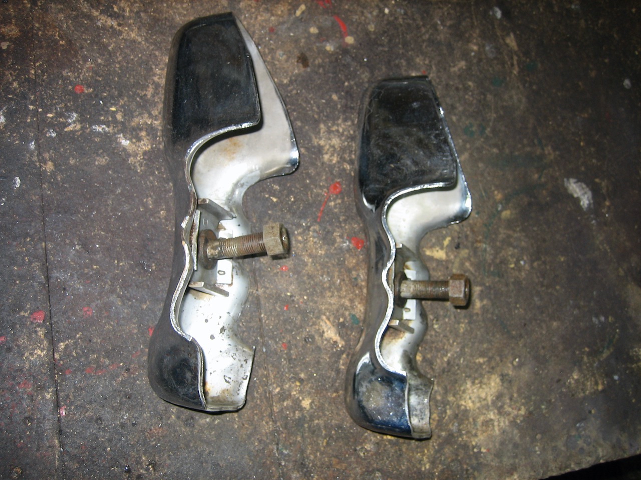

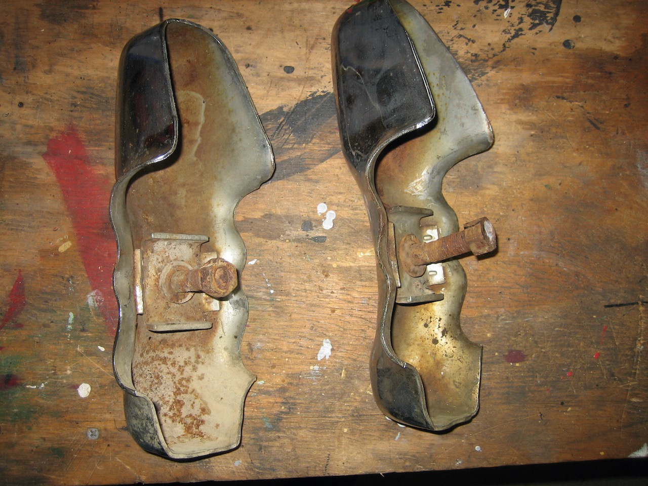

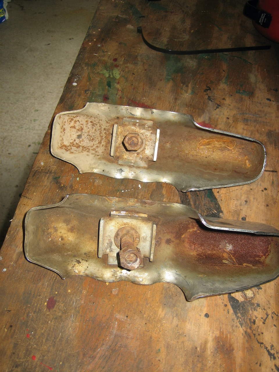

  4. j hansen
    Joined: Dec 22, 2012
    Posts: 12,816
    j hansen

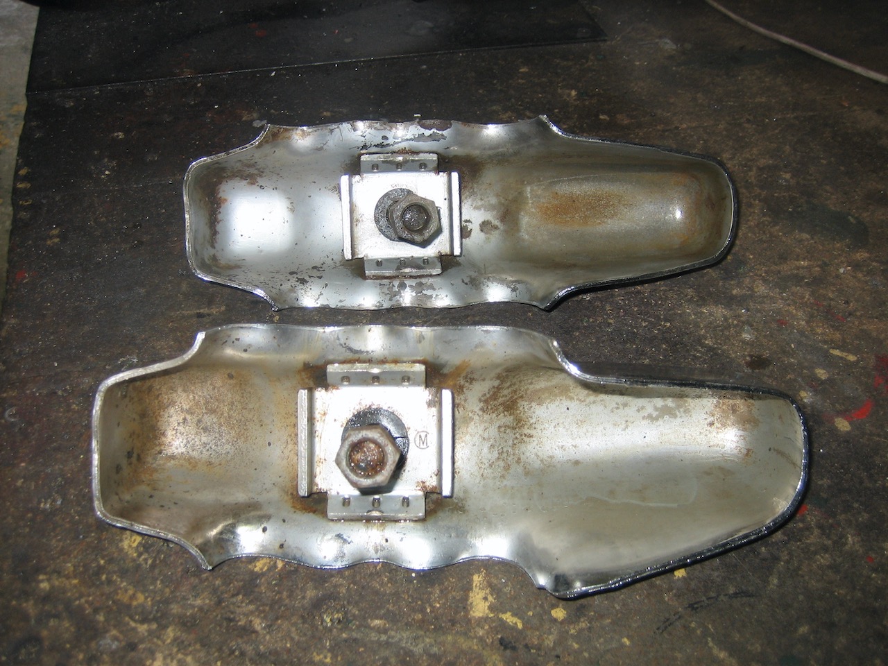

    Metoo,,,,,,,this is after 24 hour soak.
    If you want better result,,,,,leave it in longer.

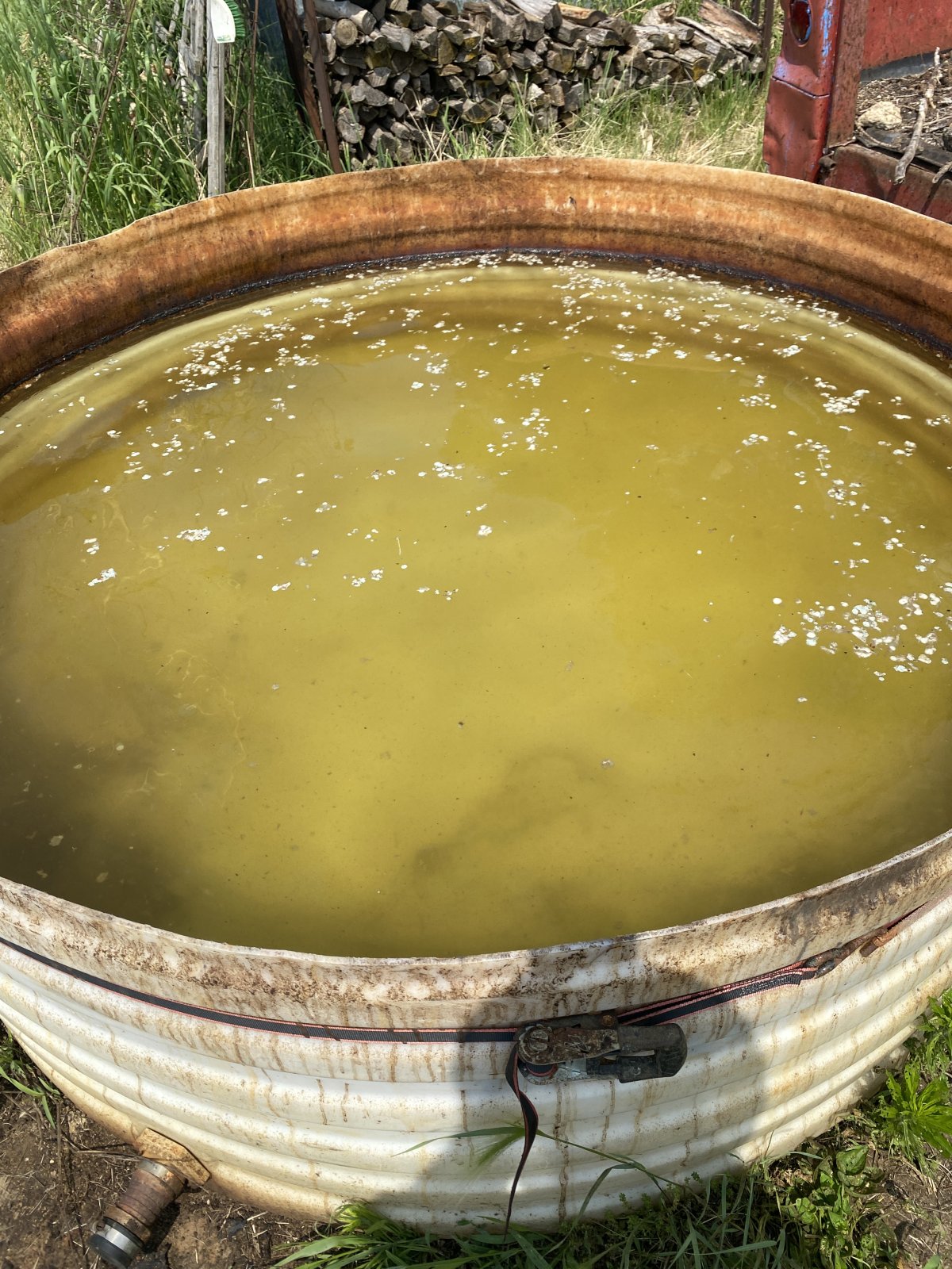

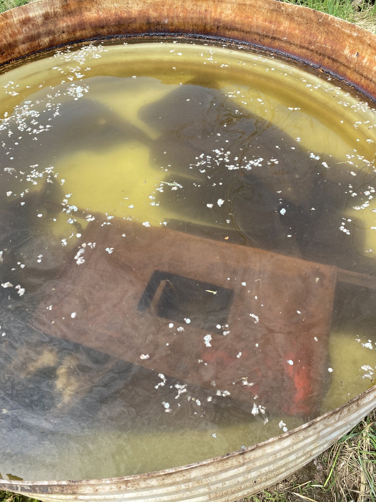

  5. alchemy
    Joined: Sep 27, 2002
    Posts: 23,465
    alchemy
    Here’s a whole Iowa swimming pool full of citric acid and water, soaking some vintage tin. Comes out spotless (after a power wash).
  6. xnology
    Joined: Aug 21, 2010
    Posts: 44
    xnology
    from Idaho
    That is awesome! What’s the mix ratio water/citric acid for that tub?

  15. alchemy
    Posts: 23,465
    alchemy
    Our rusty hot tub had 400 gallons of water and one 50 pound pail of citric acid powder. We soaked the parts about two weeks per session. The mix lasted about half the summer before it lost potency.
    Budget36 and 69fury like this.

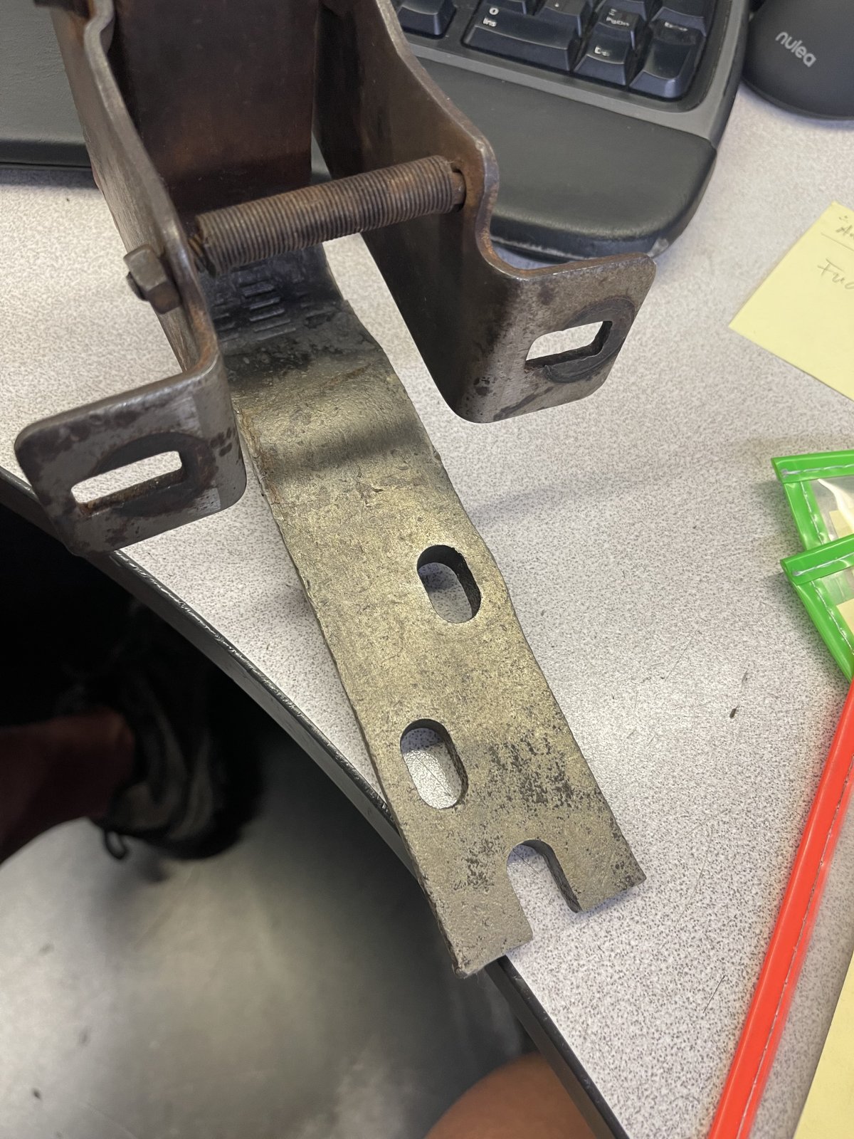

  21. If your'e worried about electrical connections for an electrolysis bath, they should only be low-voltage DC (like from a battery charger), which won't zap you. I have run one of these for many years using an old solar panel and bicarb soda, with any old piece of s**** mild unplated steel as an anode.
