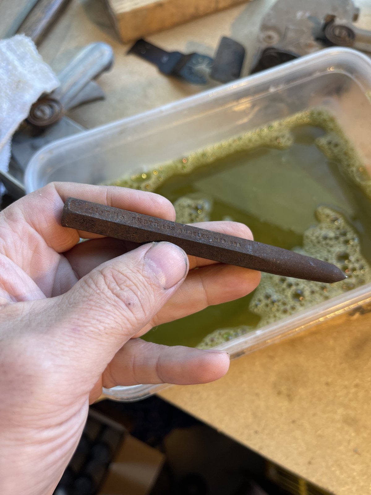

    Washing soda IS ddifferent than baking soda. The ratio of citric acid to soda is this in the BB video:
    100g citric acid to 40g washing soda. 1:0.4
    Or
    100g citric acid to 63g baking soda. 1:1
    Edit corrected baking soda amount.
    I don’t know the difference, but there is one. They are both supposed to work. I don’t know if either is specifically better. I was out of washing soda so in my personal test it has been the 1:1 ratio for baking soda. Works like a champ.

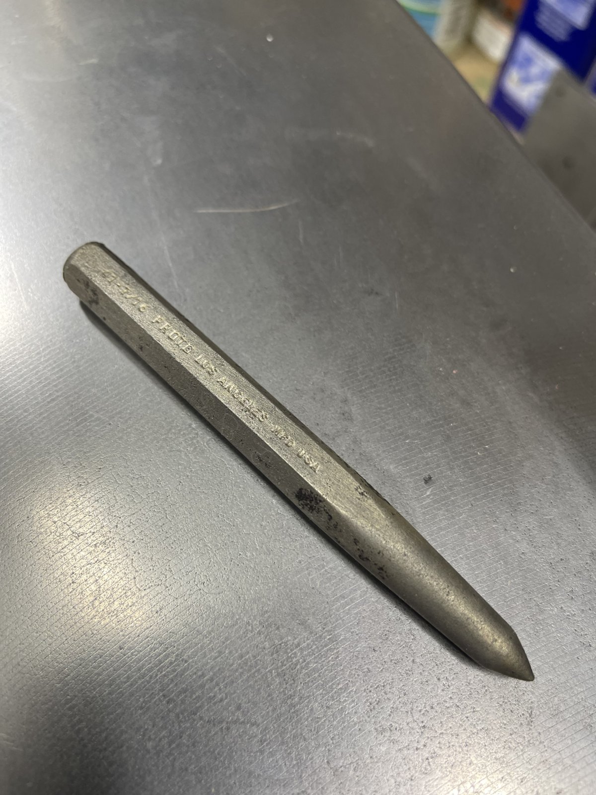

    An old PROTO center punch - not perfect, but I can throw it back in for a day and see if the rest comes off.

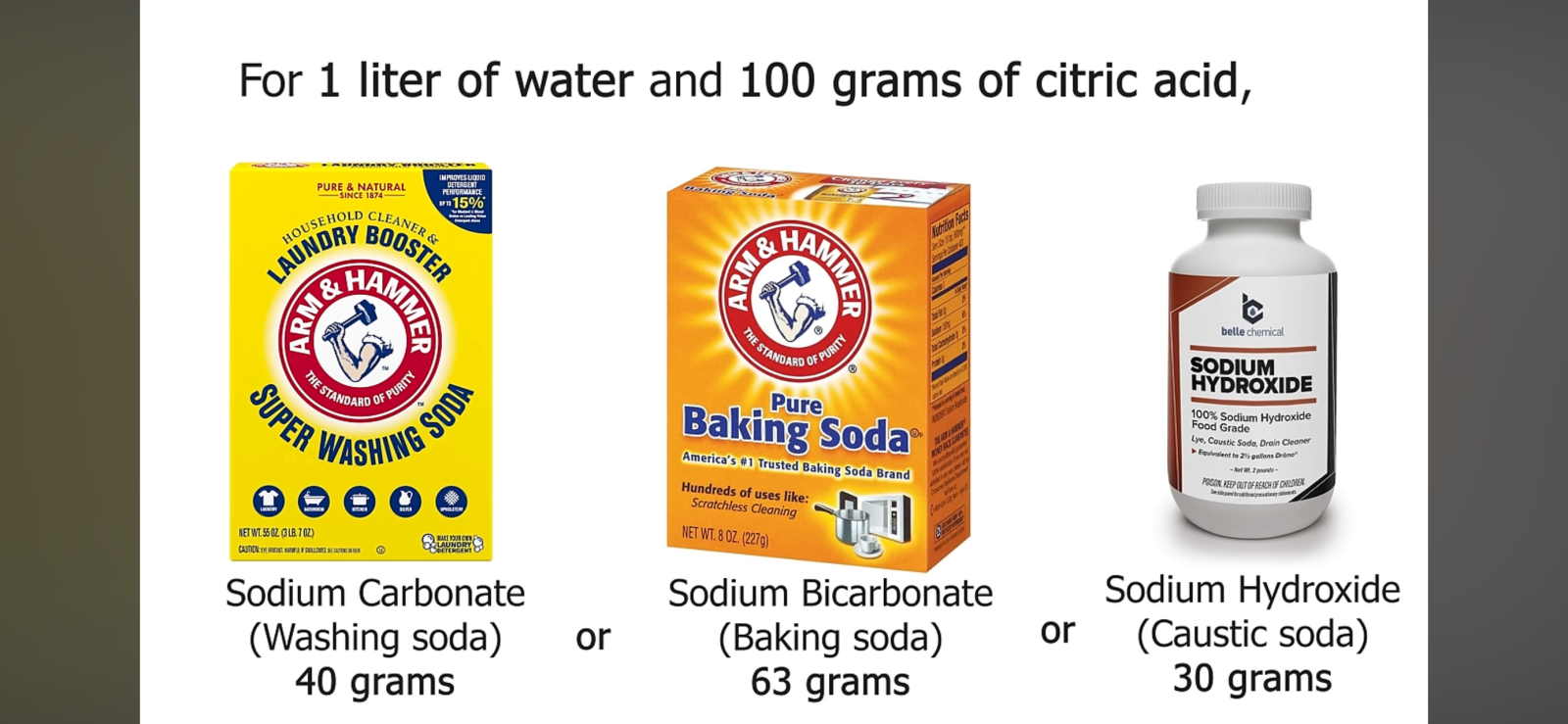

    Screenshot from the video.
  13. Harv
    Joined: Jan 16, 2008
    Posts: 1,567
    Harv
    from Sydney
    That video advice is good science. There is nothing magic about "baking" or "washing" sodas. They are just a means of raising pH without the citric acid making any nasty byproducts. They each have different strengths, so you use more or less of them. Caustic soda does the same, again with a different strength.

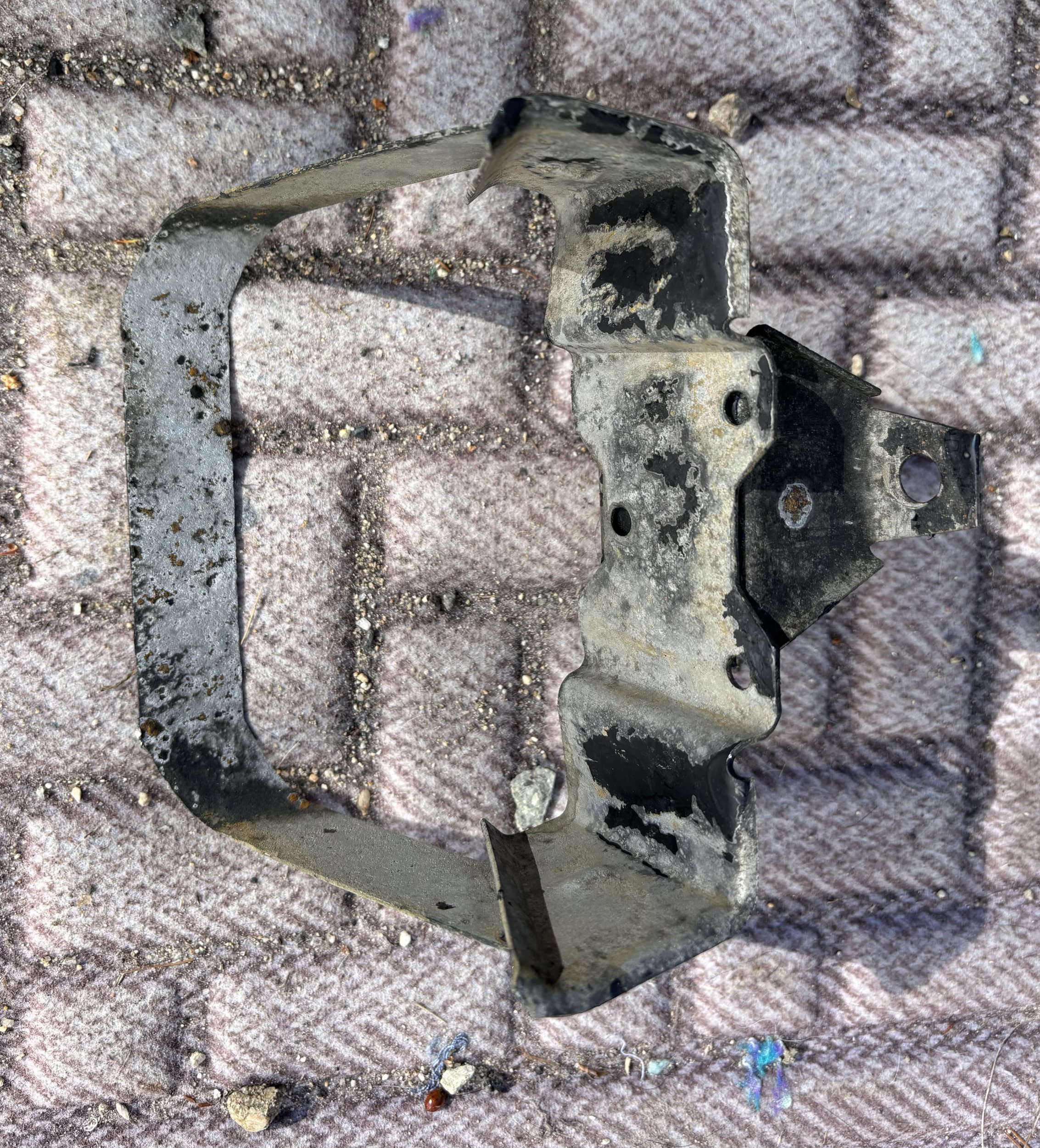

    Working on an 04 VW - definitely not HAMB worthy, but my kid needs the car… put a corroded shock top in and added some lug and brake bolts. For once I can win at hide and seek!
    After an hour or so, the edges getting worked on showed up in the top of the soup!

    24 hours in the bath. Zero prep, just rinsed off with the hose afterwards. 3 liters of water, 300g citric acid, 120g washing soda, and a healthy squirt of dish soap.
