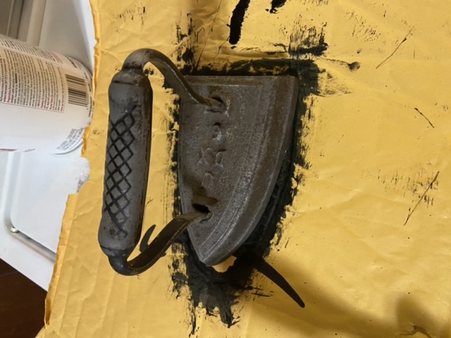

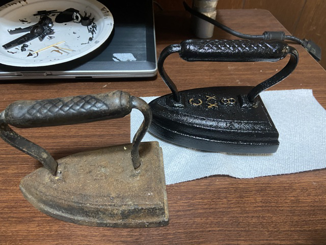

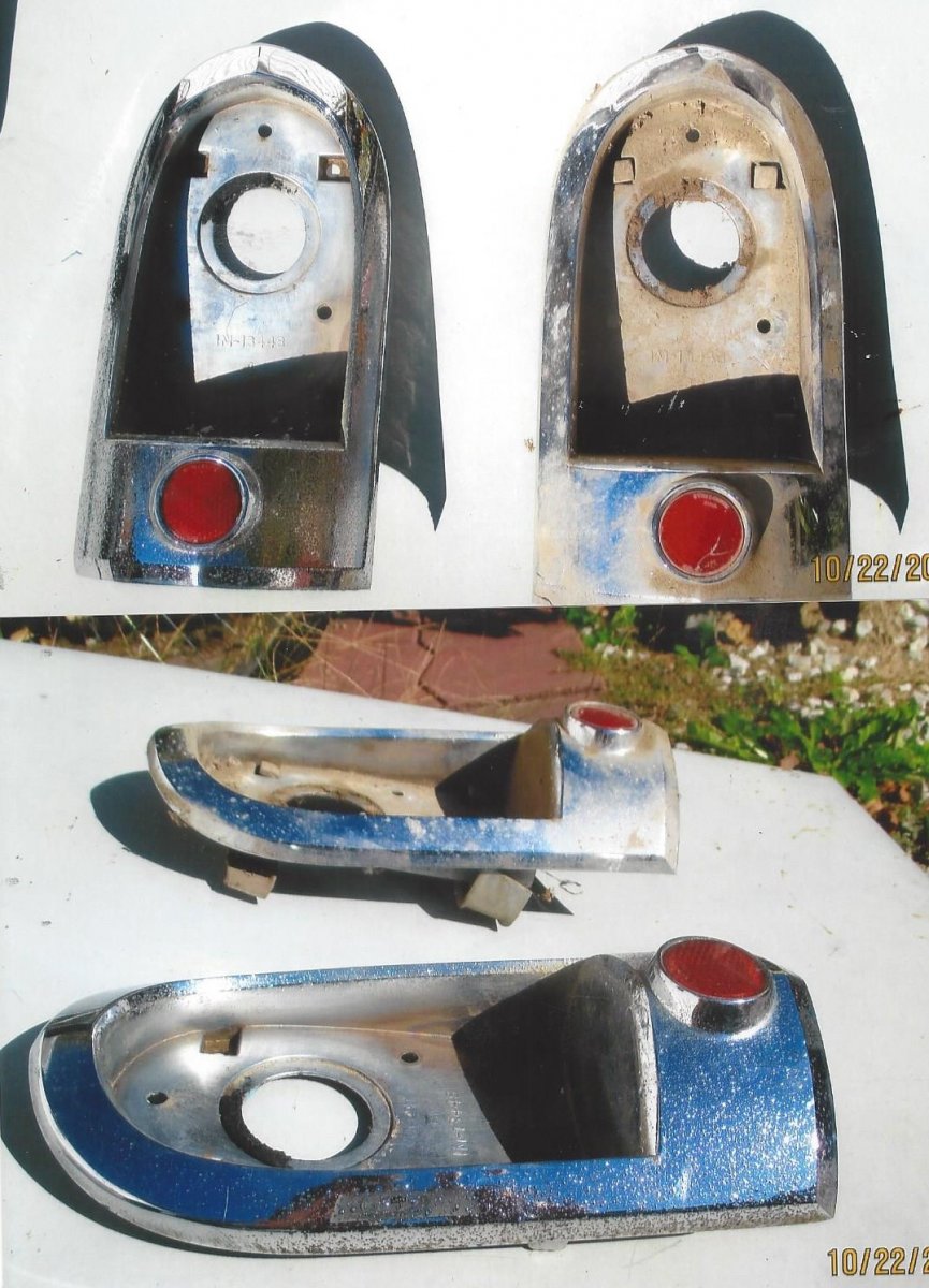

    I just redid some sad irons I found at an estate sale.
    Front iron before evaporust
    Same iron after evaporust (2 hour soak)
    I was a skeptic but it actually works pretty well. It is not for use on anything but steel and care should be taken not to soak for too long. You can reuse evaporust over and over. I ran the used evaporust through a coffee filter after I was done to get all the junk out of it.
