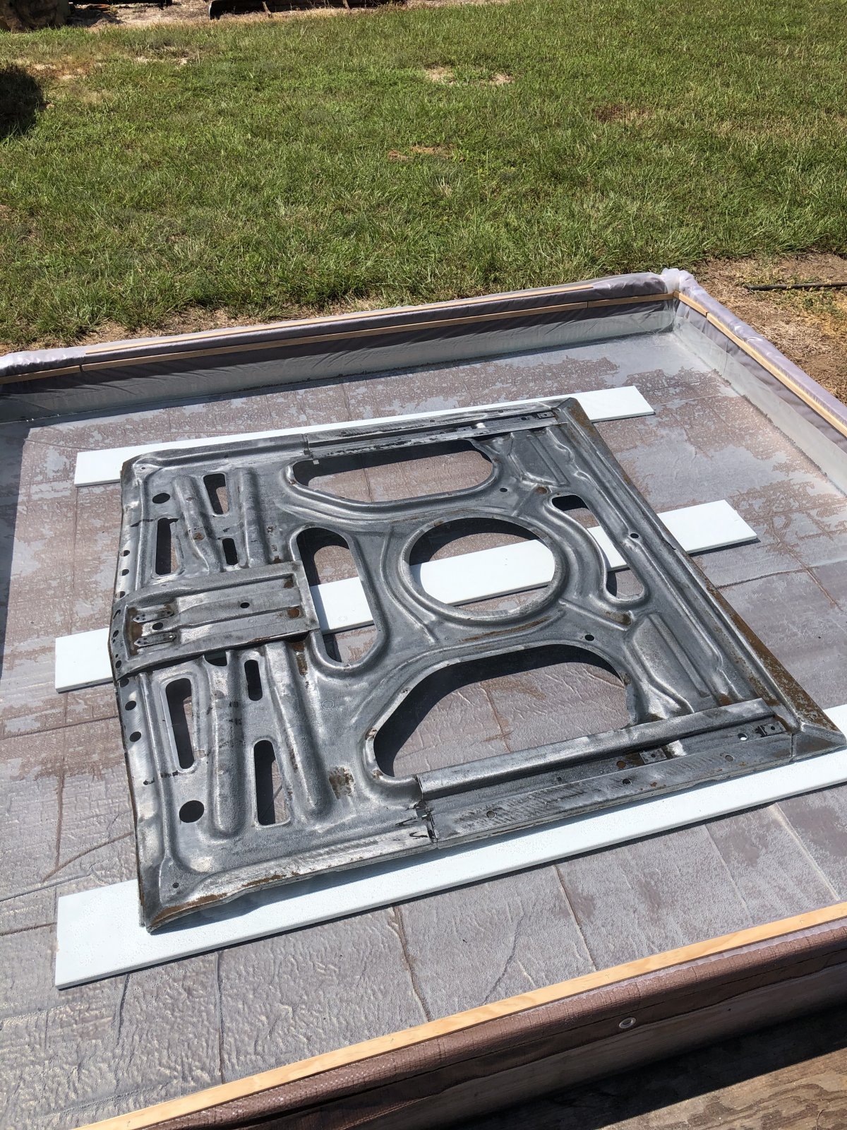

  13. ronzmtrwrx
    Joined: Sep 9, 2008
    Posts: 1,524
    ronzmtrwrx
    Citric acid all the way. 524F6CF6-1454-44DF-98C0-A21DA6A0BFEE.jpeg 943E5123-CEDC-4180-B831-8D8740EA3281.jpeg I like it because it’s not messy and it’s relatively cheap. I heard good things about mol***es, but have never tried it.
