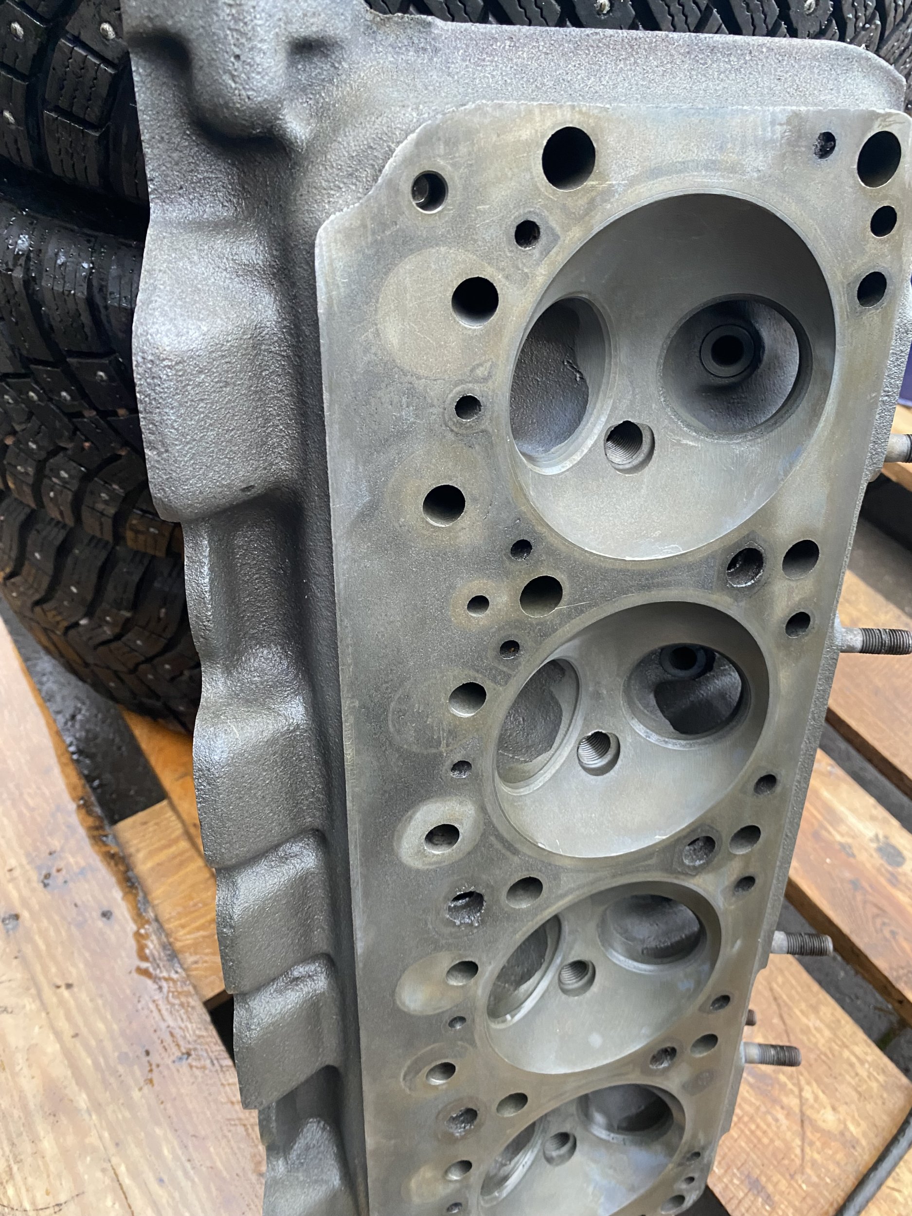

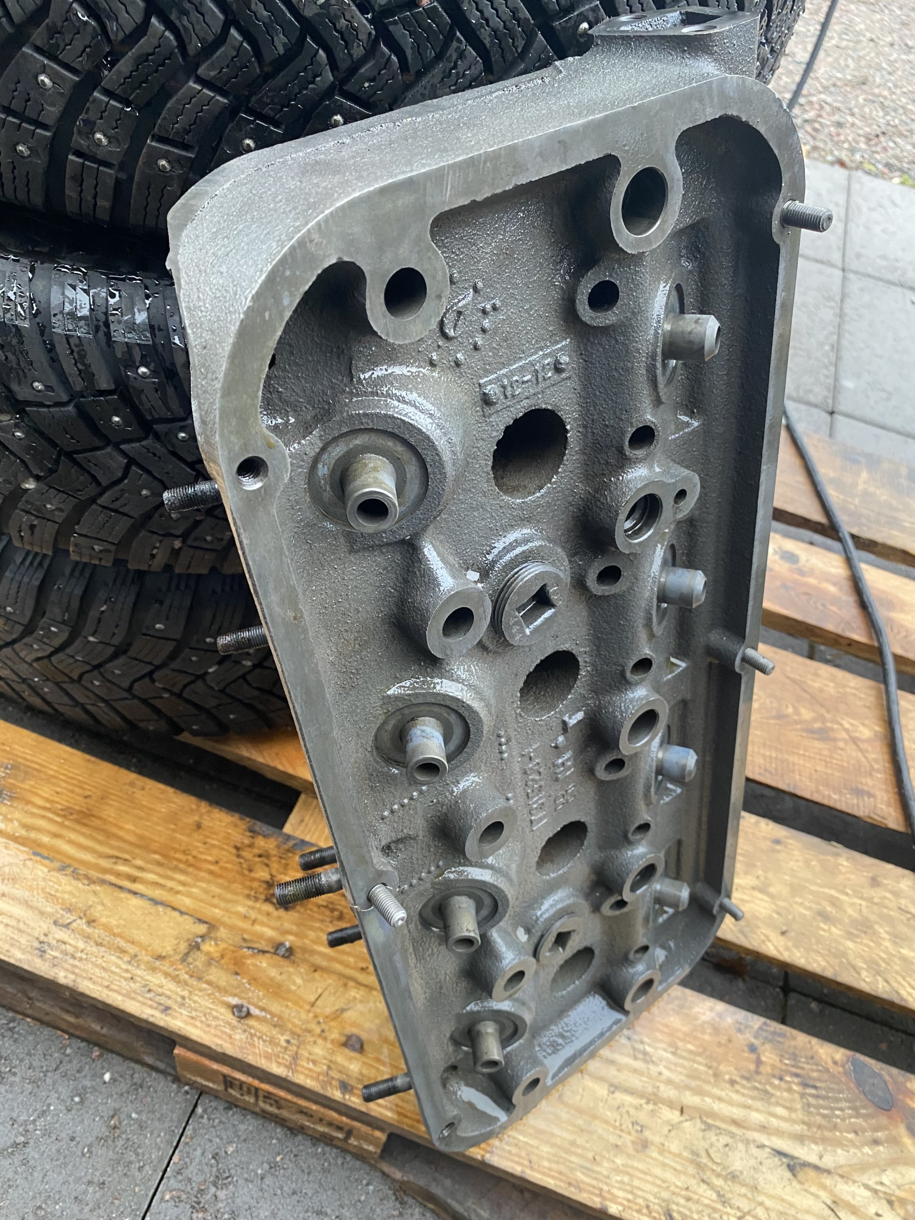

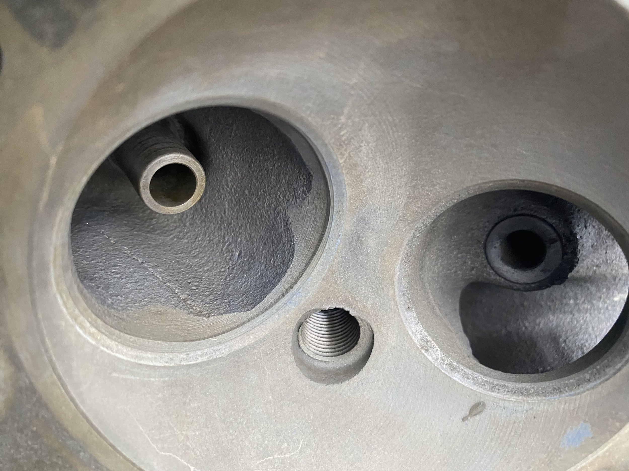

  7. 3w Hank
    Joined: Jan 29, 2022
    Posts: 1,070
    3w Hank
    Todays citrus accid works on 392 heads.
    But its allot of work, 2-3 hotbath with soda then accid.
    Laser is fast but waterjackets is the case so the okd work must go on.

  17. 3w Hank
    Posts: 1,070
    3w Hank
    Clean cast irion is just so nice !
    -This came up today, and one near got a tear in eye, Ha !
    Problem I has if not a warm summer day and sun is shining and 30C and superhot water pressuare and direct blow off it get very fast darker especially if I’m using citrus accid.
    Good fresh caustic is better but a bath don’t last long, but it do last long to remove dirt, grease, paint but say after 2-3 dipp it will not remove the rust.
    -Tom, a question, how does the metal react after the method you show ?
    Is it critical on day/time of year and if you use cold or warm water ?
    Most metal/parts that I can use a brush I use my machine ( but hard do it on a block, well Ok a hand machine )
    But I know, after brush it keeps rust away ( atleast in my shop )

  20. 3w Hank
    Posts: 1,070
    3w Hank
    I’m not talking about time here.
    To clean parts is always a bad business if one like to get rich.
    I do it as I like it, so one can say I pay to clean.
    It’s not possible to explain to many customer how much time it is to clean a ex a V8 block and to remove all plugs etc. If one tell a price they all say, Ok I do it myself, so I heard this at decades.
    Then when I get parts ( before machine ) few or non get it clean.
    Back in my days we had a big bath ( big as for trucks diesels ) always hot 7 days/week and all parts went down there if customer like it or not. I guess boss added in price but it was most industrial $ but my work there was racing parts and clean/linebore/balance.
    ( same as I do now but that shop is closed, owner is dead and all machines long gone )
    -When I use caustic I use 150 F and for the citric I use that cold and 1/10 and 1 day in bath.
    If parts is clean but has some rust the citric will remove all rust.
    But the issue I has over the years is as explanined if not a very hot day and hot water pressuare the surface goes darker direct.
    Its supernice out of bath but at fall and cold water its still clean but not the ’new cast irion look’.
    When I do cranks etc in shop I can use caustic to clean up before grinding but it can be rust on ends etc.
    Normal customers dont care but therefore I bought a laser cleaner as I care.
