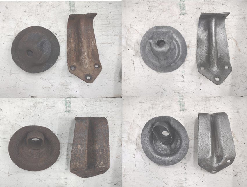

    Most rust removers, at the ones I've used, are phosphoric acid based. I had good luck with KrudKutters rust remover and bought it in gallon jugs to save on price over just buying it in the spray bottles. Now it seems they don't offer it in gallon jugs. My son is a dairy farmer and he used all kinds of chemicals to clean his milking equipment. One is milk stone remover and acid rinse. It's mostly phosphoric acid, more acid than most other rust removers so it has a little more bite than the weaker rust removers. I bought it at the local farm supply store for $20 a gallon, less than half the price at other places.
    I soaked two really rusty parts of the sidemount brackets for my '37 Buick and the parts came out rust free. I had to soak them for about two days, rinsed them water and ran a cup brush on m angle grinder to finish cleaning them off but they came out really clean.

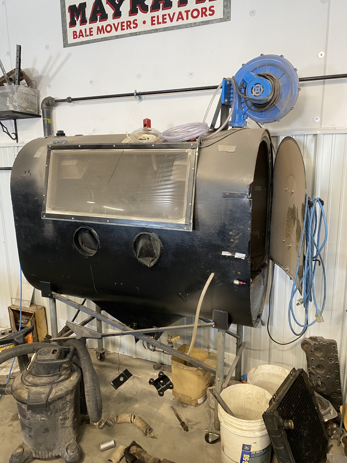

    IMG_0058.jpeg Excuse the mess around it. Heating oil tank was free. My father had a couple laying in s**** pile. Gloves and gun I had. A few bucks for angle iron, plexigl***, weatherstripping, pipe, casters, expanded metal for grate, 2 halogen lights, and sheet metal for sump. Works great and roomy!

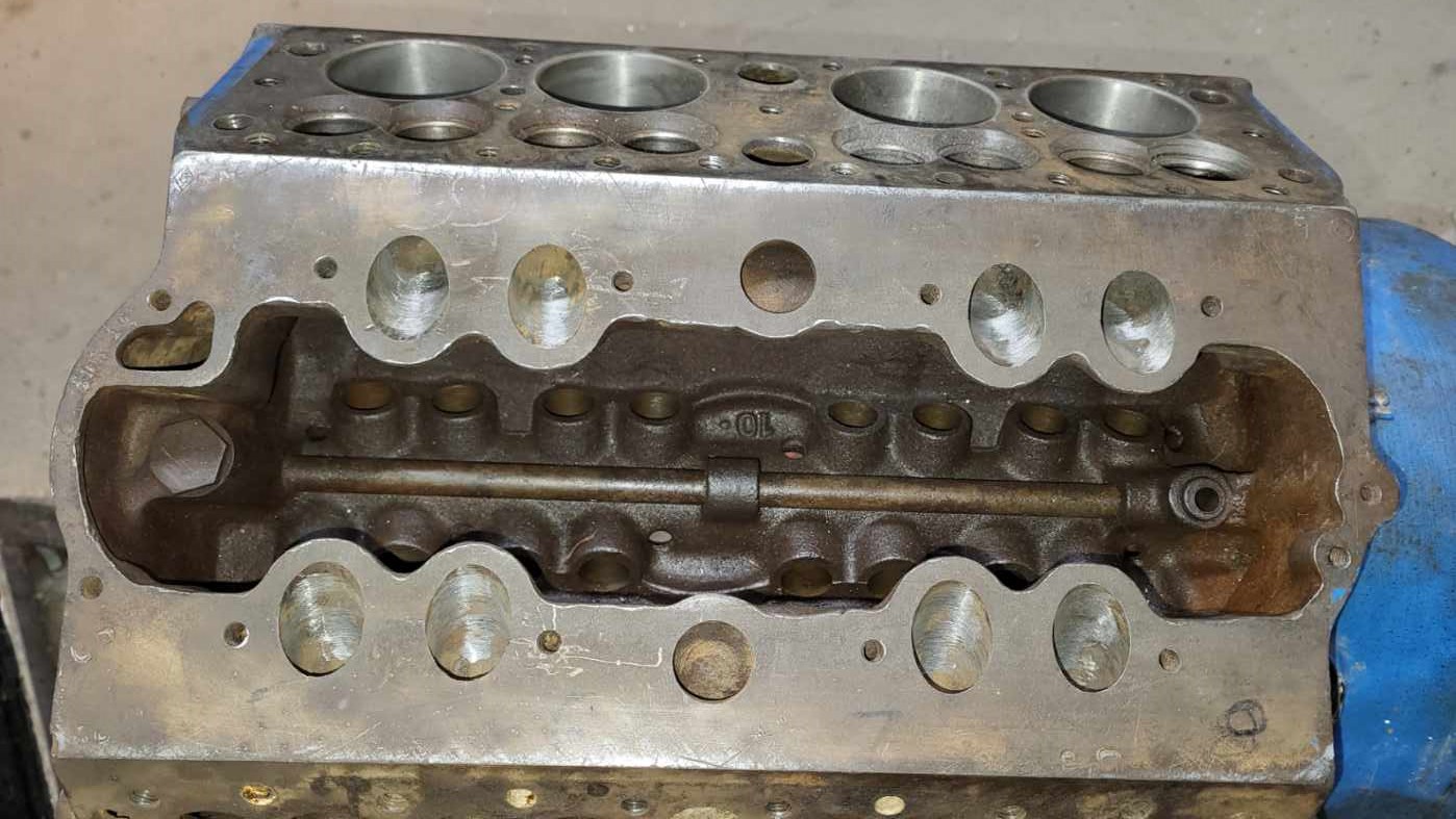

    I'm working on a V8 60, and before I did anything with the block, I wanted to try the electrolysis process. I dismantled the water pumps and mixed up the washing soda solution and immersed them for less than an hour. I need a better DC supply, but I'm happy with the result.
    The engine was rebuilt 40 years ago and never run, but shed stored as a short block. I believe it has been set up for a boat, so the water jacket was a mess. I made some rubber head gaskets and filled it with Evaporust. There was some improvement, but since the flash rust in the valley and crankcase was so extensive, I thought I should immerse it completely. That led to the electrolysis experiment. The photos make it look better than it is.
