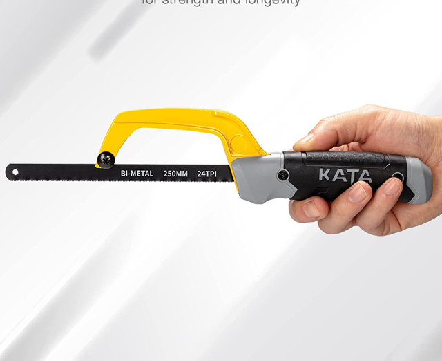

    That’s a tuff one. I’d bet the threaded shaft would just break off even if you could get a good grab on the nut.
    I’d look for my trusty short small handled hack saw like this. 67EA4C6E-C86D-4EC0-BD38-7126CA257738.jpeg

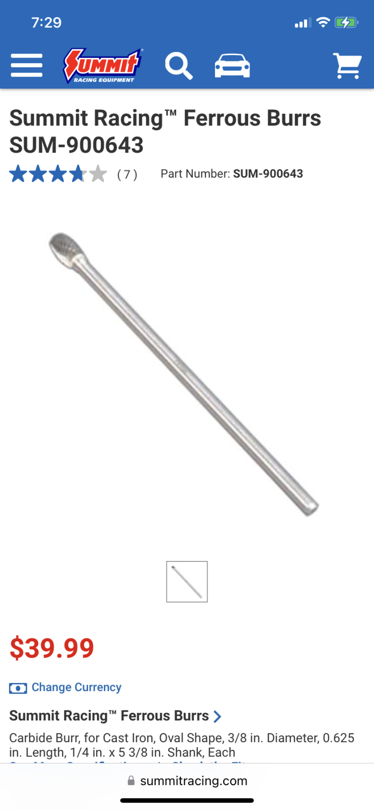

    what about a king burr on an extension
    I’ve also seen flexible burrs , never used one .
    Just ideas .

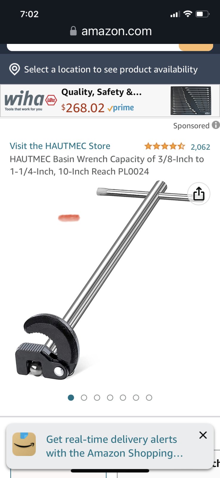

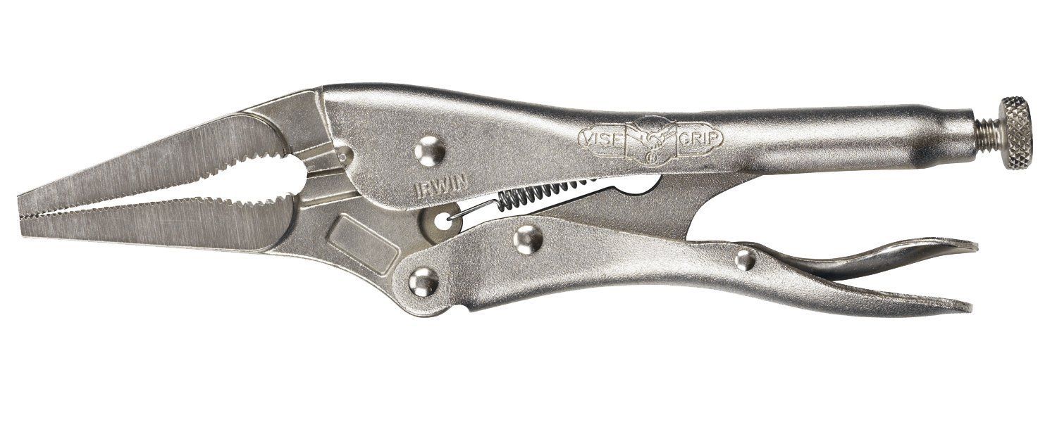

    I’ve used these countless times to reach hard to access fasteners. I have two pair of them one is around 6” and the other around 4” in length.
    Paul likes this.

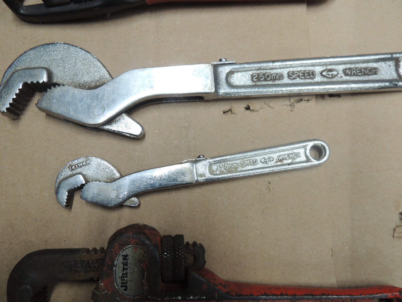

  22. I'd be using one of these from my collection, if it was me.

  24. Paul
    Joined: Aug 29, 2002
    Posts: 16,843
    Paul
    Editor
    like RmK57 said,
    and they come in longer sizes too
    williebill and scotts52 like this.

    I have tried needle nose vise grips as well. The problem is I can’t reach this nut with them, so even the longer, fancier versions won’t work because the space is so tight. All very good suggestions though…I appreciate the input.
