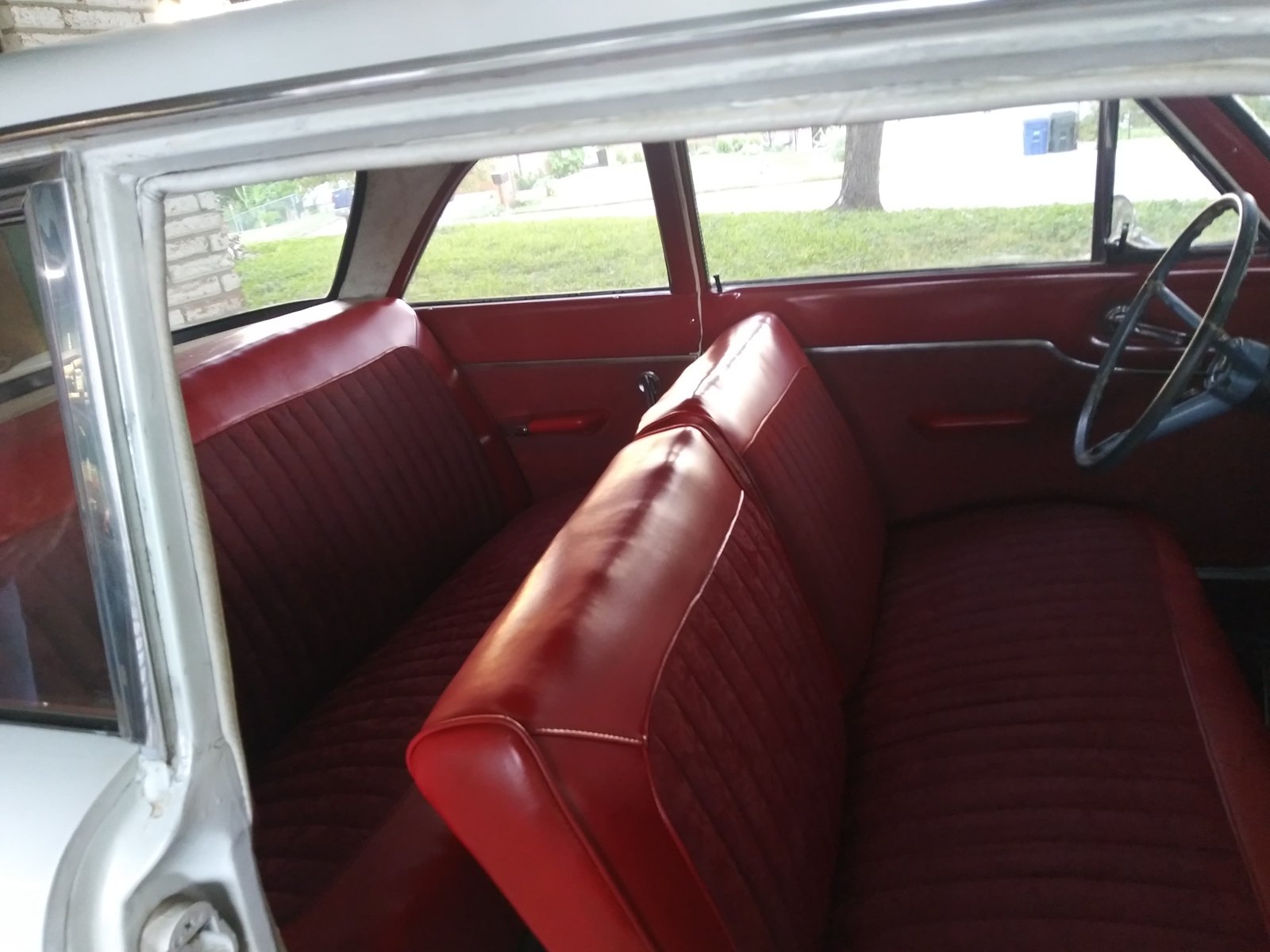

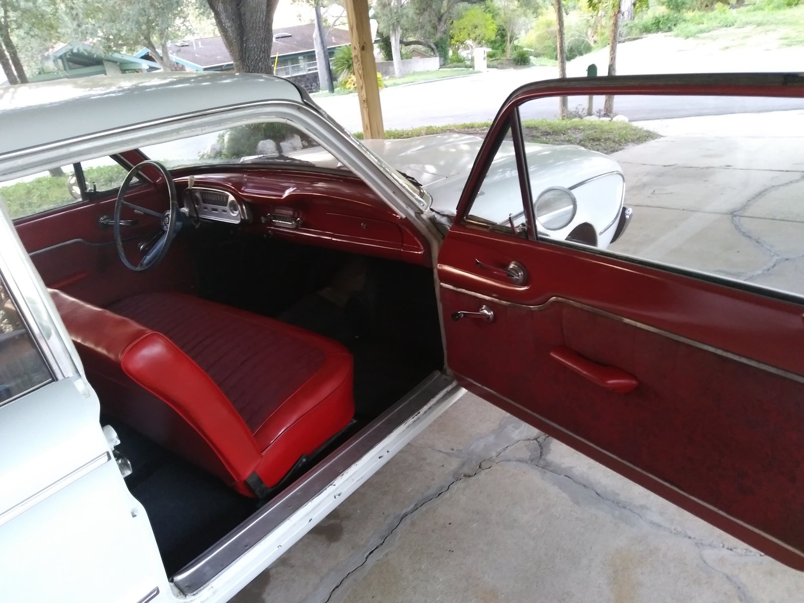

  7. My brother used Dupli-color Vinyl & Fabric spray paint to turn his 1961 Falcon 2dr bench seats and door panels from original blue to red. His seats weren't in bad shape, but they were faded and sun burnt. It looked amazing when fresh, and even after a year of almost daily driving and the Texas heat, it has held up pretty decent. The vinyl wasn't stiff or any easier to scratch than the original, and the cloth was as soft as original. The coverage was quite amazing to be honest, going from that dull faded blue to the bright deep red. After a year, the seat bottoms really need a another coat, but everything else has held up great.
    Also, we were on a rod run last spring, and I was worried the red paint would end up all over my back and *** after riding around all day, but there wasn't any red stains on my shirt, just a sweaty back.

    Well that Falcon is encouraging. What I’m considering doing has a lot more nap to it than the fabric inserts of the Falcon however...
