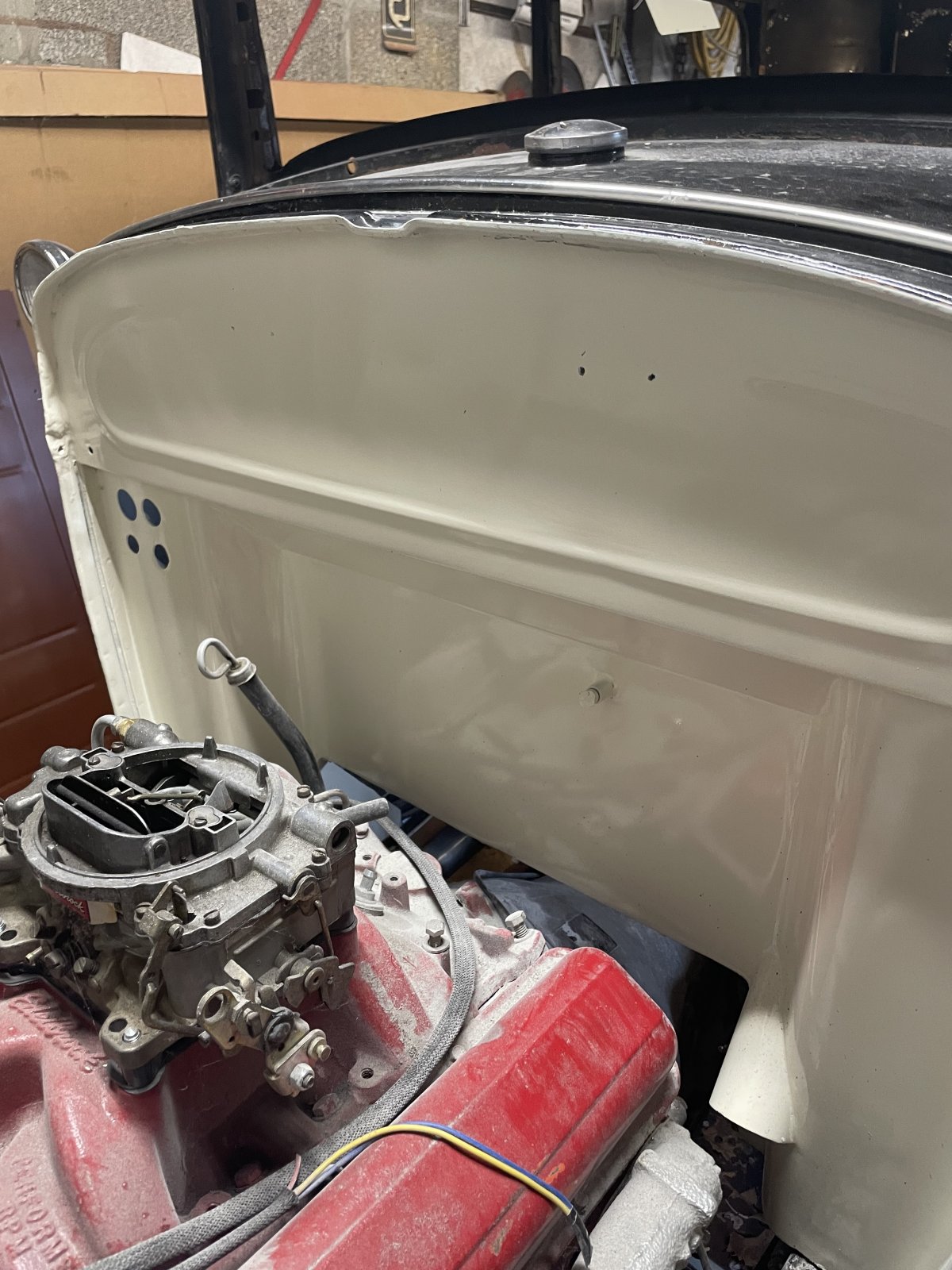

    I used that topside paint (oyster) on my firewall. Mixed it with majic hardener and some reducer.. it flowed super well and dried hard. The cars not on the road yet, so I can’t be certain if it’s durability.
    But right now it looks killer.
    treb11 and alanp561 like this.
