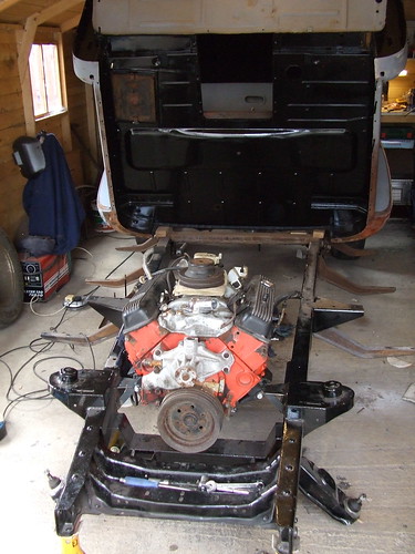

  22. 50scotbolt
    Joined: Jan 15, 2009
    Posts: 627
    50scotbolt
    I totally agree, you can get some great results with a brush.
    Unless you are looking for a 100 point resto finish,brushing is more than adequate.
    Spraying POR is just plain nasty!
    Here's my floor earlier on in my build.(Brushed)[​IMG]
