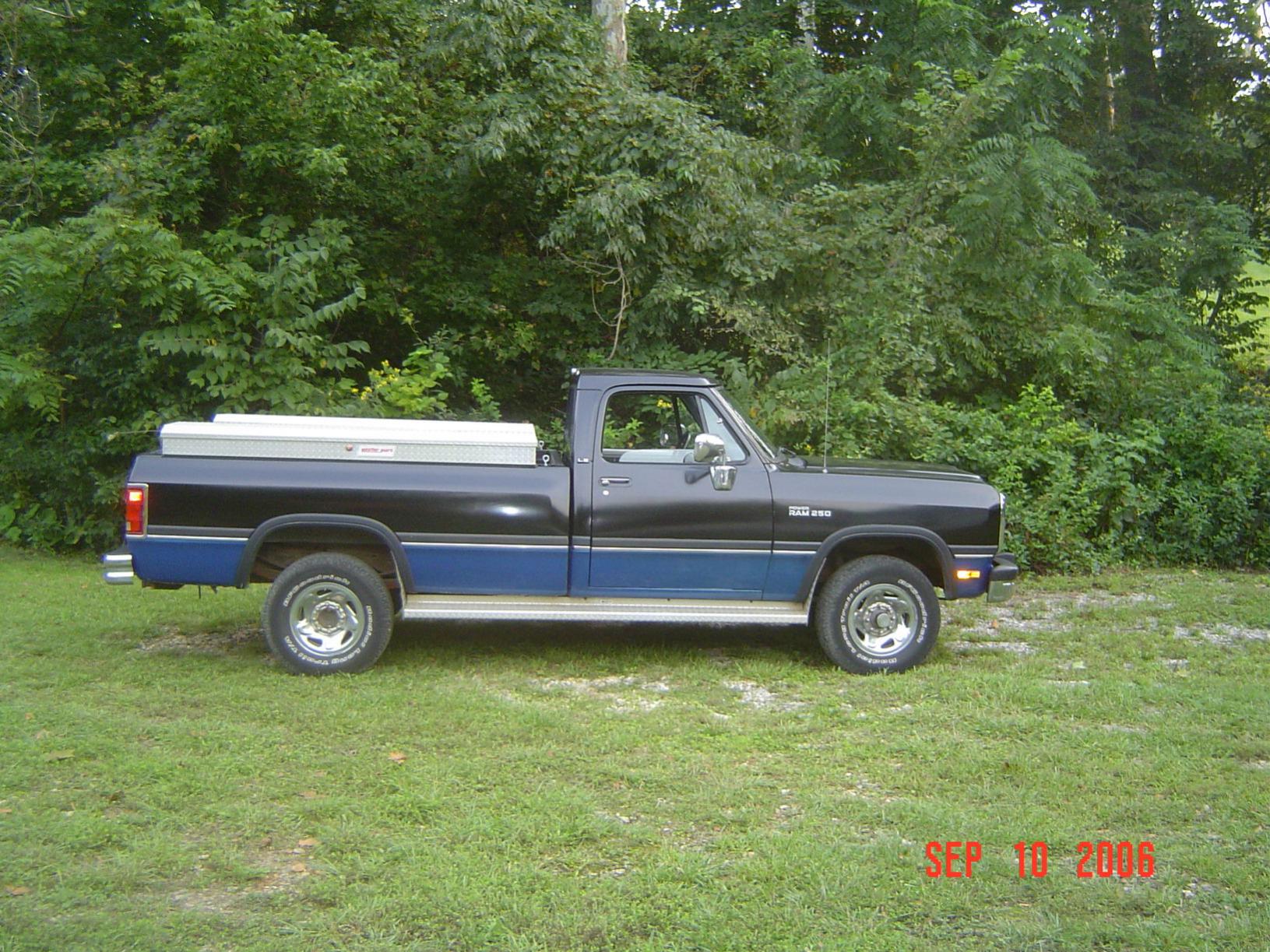

    I love my cheap Rustoleum paint job on my O/T work truck! I just did the top half of my two tone Dodge. I went from flaking and peeling silver with brown rust showing on the hood and top to a gloss black that has mellowed into a pretty good looking finish, probably between "semi gloss" or "satin" in 3 years. Used a spray can for the hard to reach areas and thinned the paint with mineral spirts for use with a 4" foam roller for the large surface areas.
