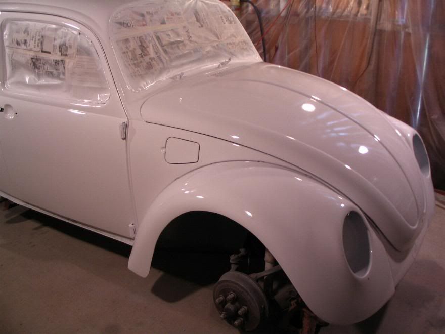

  1. Here's my job I just did this morning. I know the car might not be HAMB-approved to some, but I figured it's okay since it's an actual I/Gas drag car...
    I set up a makeshift spray booth in one corner of my garage using plastic sheeting. I had 10 clip-on work lights in various spots all around the car at different angles, each with 100-watt bulbs in them. Also, I scored 4 box fans from the thrift store and put them under the partially-open garage door facing out. Seal up the space to the sides of the fans as well, so you don't have any open spaces.
    I'm not going to get into the bodywork here. There's plenty of other info about bodywork everywhere. So, after all the bodywork, patching and such, and masking, I sanded everything with 180 grit, tack-ragged it, then wiped everything down with acetone...
    I used Rust-Oleum clean metal white primer (2 qts), thinned only about 5-10% with acetone. I discovered acetone dries quicker than mineral spirits, so that was what I used for the primer. I sanded the primer with 400 grit, tack-ragged it, and wiped it down again, then repeated the spray-sand-tack-wipe process...
    Right before paint, I got everything ready, and my brandy-new spray gun I got off ebay (bad move, I know) would absolutely not spray! I took it apart, made sure it was clean, popped it back together, and nothing. I am still clueless.
    So, I scooted off to Harbor Freight for a new gun. Yeah, I know, there's way better guns out there than HF krap, but hey, I'm using Rust-Oleum, this is supposed to be a BUDGET job! Besides, I didn't have 150+ bones to drop on a halfway decent gun. I got a good deal on a 2-gun gravity-feed HVLP set, one big gun and one detail gun, with extra nozzles and a cleaning set for 50 bucks. What the hell, I grabbed it. They were actually pretty decent. But, by the time I got back home, it was dark and the cold night air was going to hamper any thought of spraying until the next day.
    So, after letting everything sit overnight, I tacked and wiped it down one more time before doing the deed.
    I used Rust-Oleum Professional gloss white in a gallon can, thinned with about 10% mineral spirits. I used mineral spirits instead of acetone this time, because I wanted any orange peel that might occur to settle down before flash-drying. Worked like a charm. I had 2 water separators inline, one is 20 feet from the compressor, and one last-chance inline filter right by the gun. I also have a mini-regulator and gauge at the gun. I set it to 30psi. Set up my gun, and went to town...
    Now, I have done my fair share of paint jobs. I used to work in a body shop doing prep, and they'd let me use the booth after hours when I needed to paint. I gotta say, the Rusto is not bad to work with. It's comparable to any basic single-stage enamel I have ever used. Laid on nice, great coverage, and not much of the orange-peel I hear about everyone else having. As it sits, it's nice and glossy, and I have heard it holds up extremely well over the years.
    I'll let this sit at least a few days, maybe longer since I did not use a hardener. Once this is cured, I plan on hitting it with some 400-grit and doing a second coat, then color-sanding if necessary and buffing. But, you get the idea. Overall I couldn't be happier with the job.

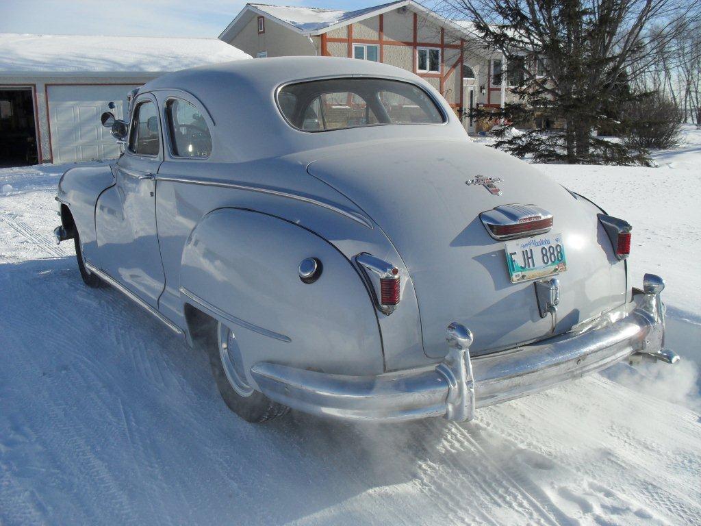

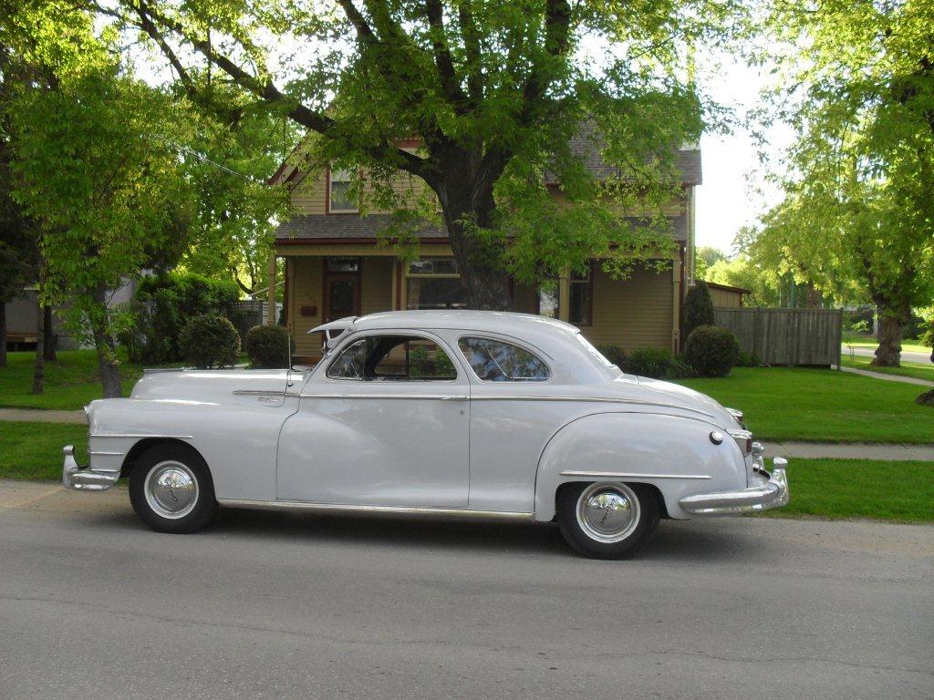

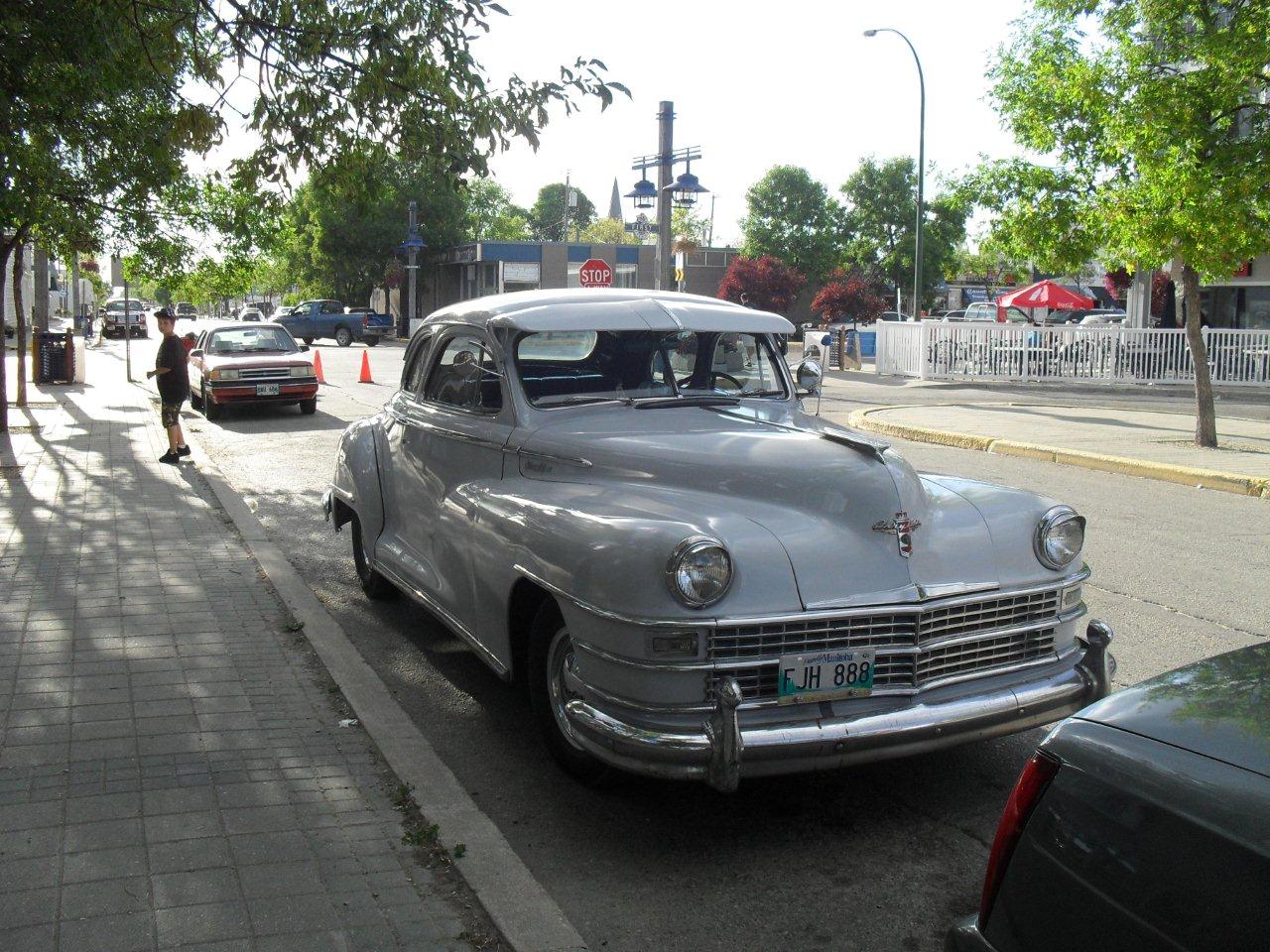

    Here are pics of a 47 Chrysler I used to own, painted with rusto type enamel, lots of paint on for cut and polish, but this baby was good and shiny for years just sold her this spring.

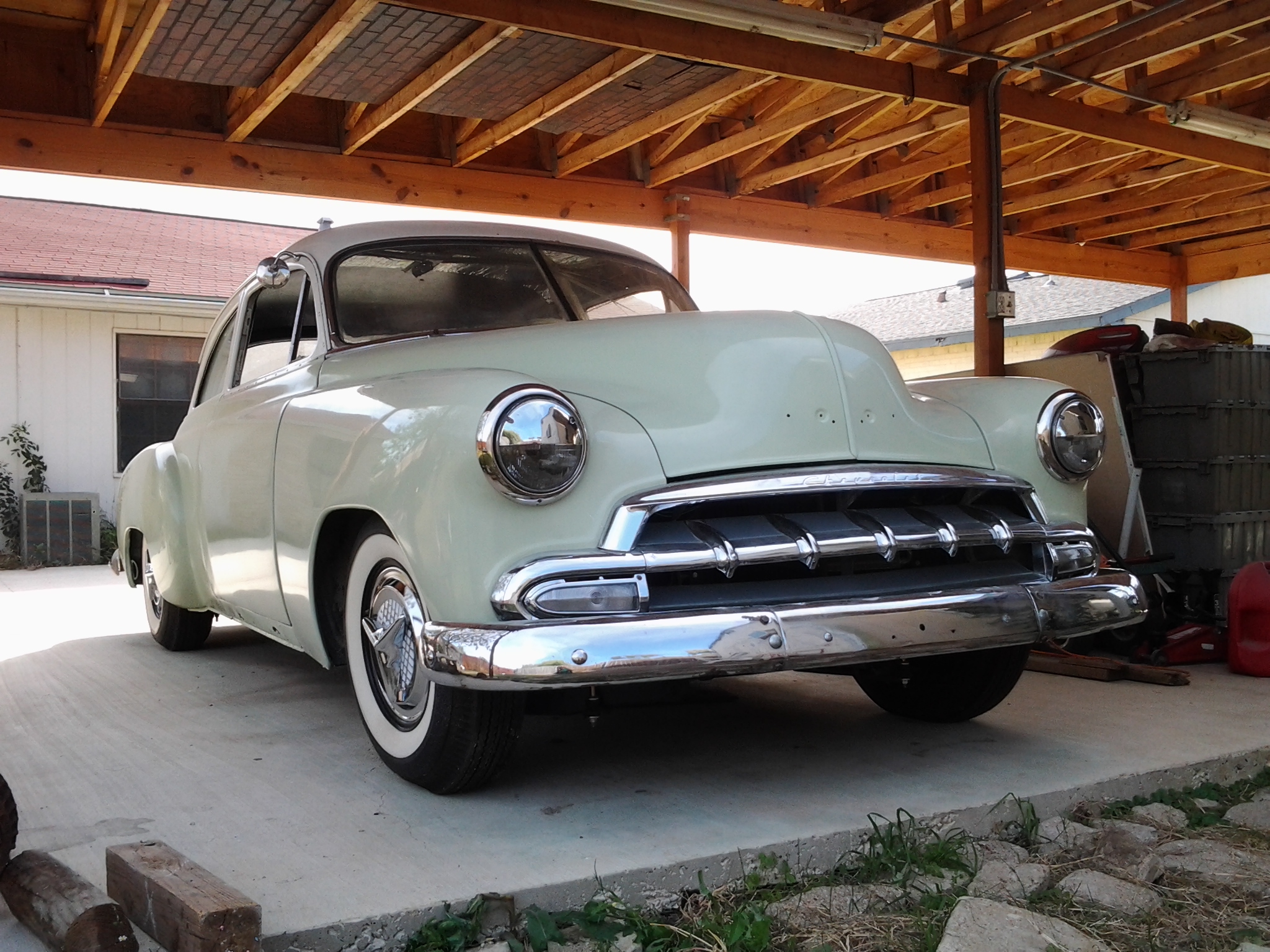

    Yes at first I was planning use rustoleum paint but when I saw that rattle can celery color I just went for it.
