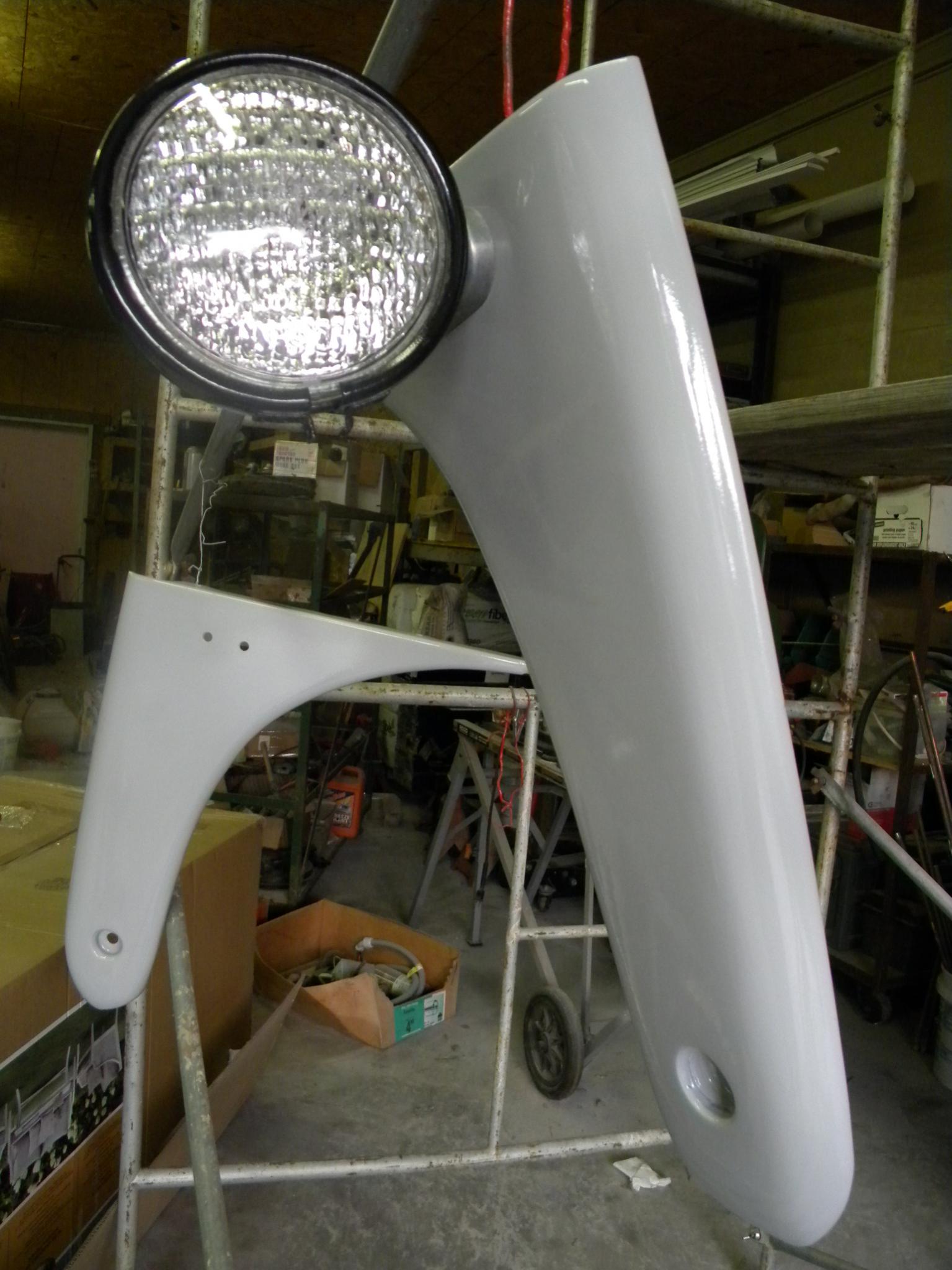

    Just an update...sprayed the hood and used Nason acrylic enamel reducer with the rustoleum paint. Shot the first coats yesterday and it went on kinda rough, **** scuffed and recoated this morning paint went on well and flowed out smoothly. Only problem is that I now have a fly hanging around the garage with ford tractor gray legs...

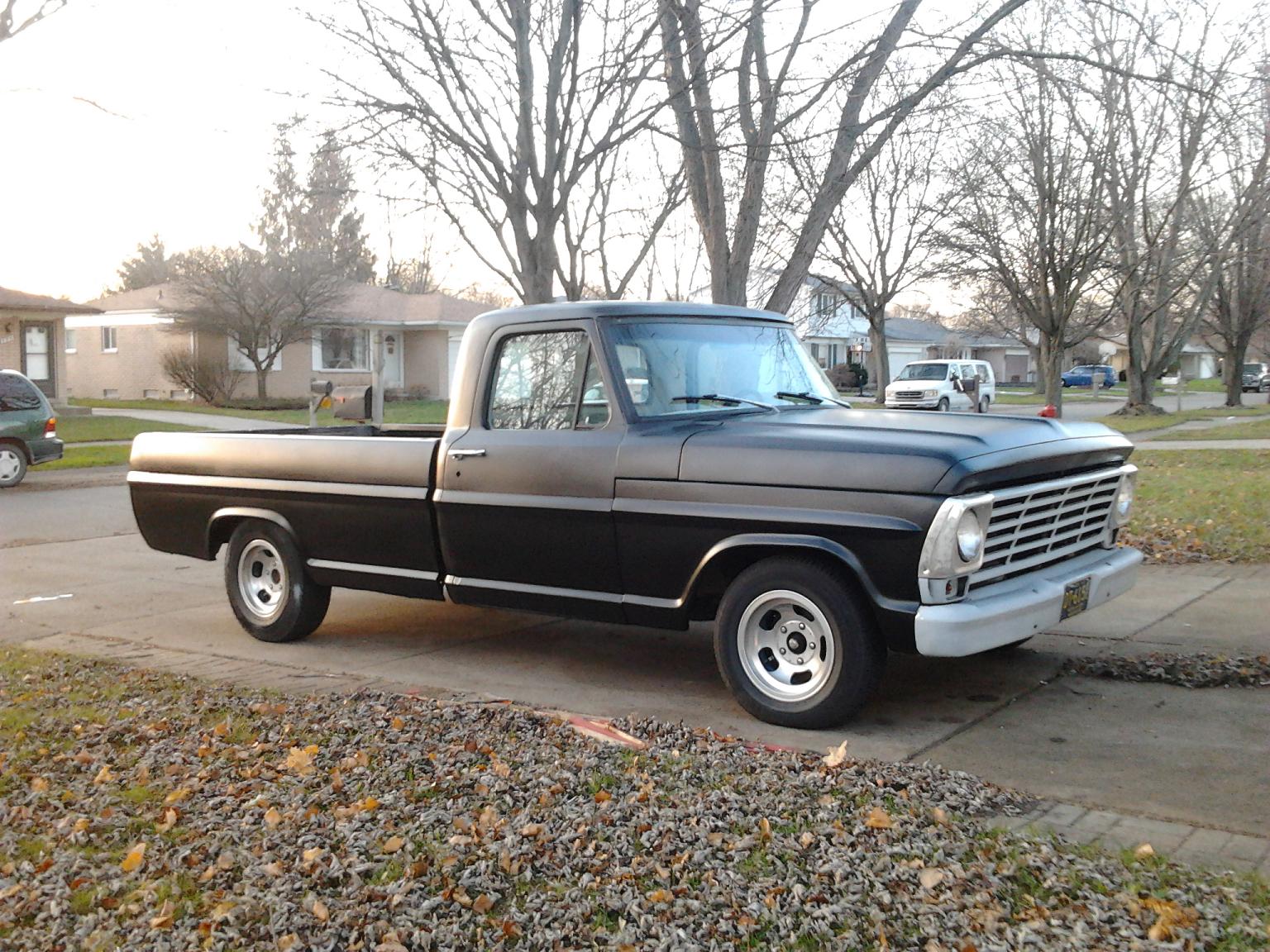

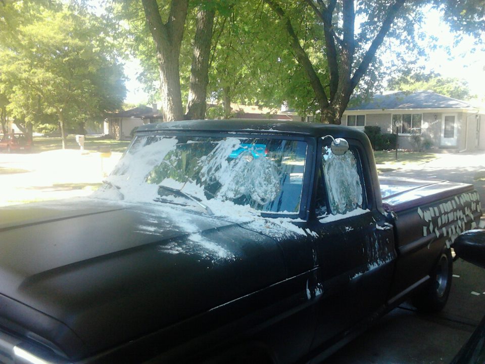

    I painted my truck last fall with rusteoleum satin enamel cut it with acetone per the directions on the can
    came out great held up through a michigan winter and is left outside all the time
    even held up to the scrubbing it took to get my sons ex girlfriends prank off it
