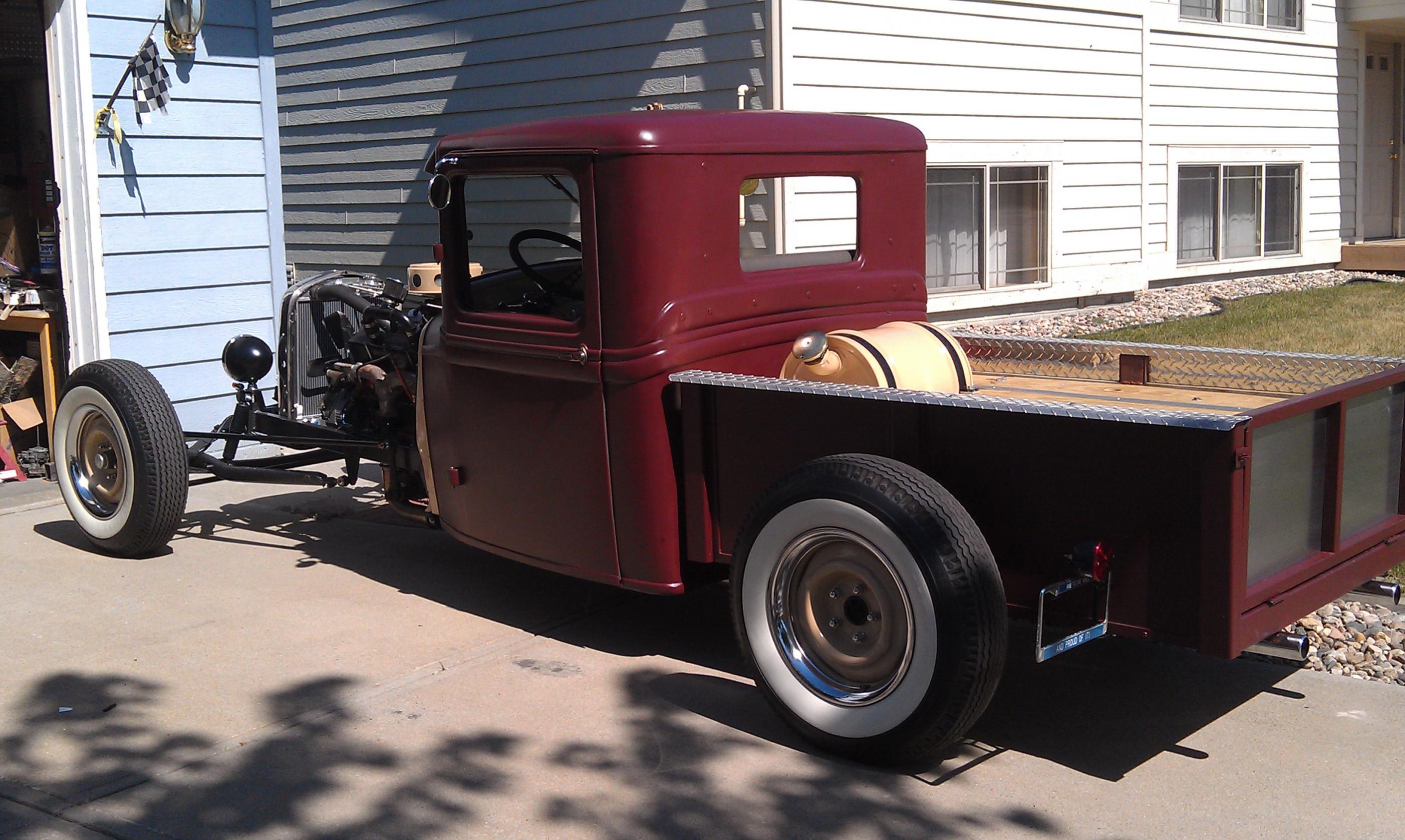

    A picture is worth 10,000 words. Your truck looks great.

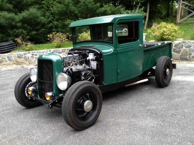

    I wondered how you got that color. I like it a lot.
    Here's mine. Rustoleum rattle can Oregano satin. My truck looked like **** when I got it. No, it was not "patina" it was ****ina!:D
    I didn't want the standard gray or red oxide primer, found Duplicolor self etching primer in a sort of avocado color. Big mistake. It faded badly, looked like hell. Redid it in the Oregano and I've been happy. My plan? I have no space to do a full tear down, can't have a derelict in the driveway so I am doing Everything on it before cosmetics. I retire in 2-4 years and will blow it all apart then for "real" paint.

    That green truck above proves that with proper prep you can get a good driver quality finish.
