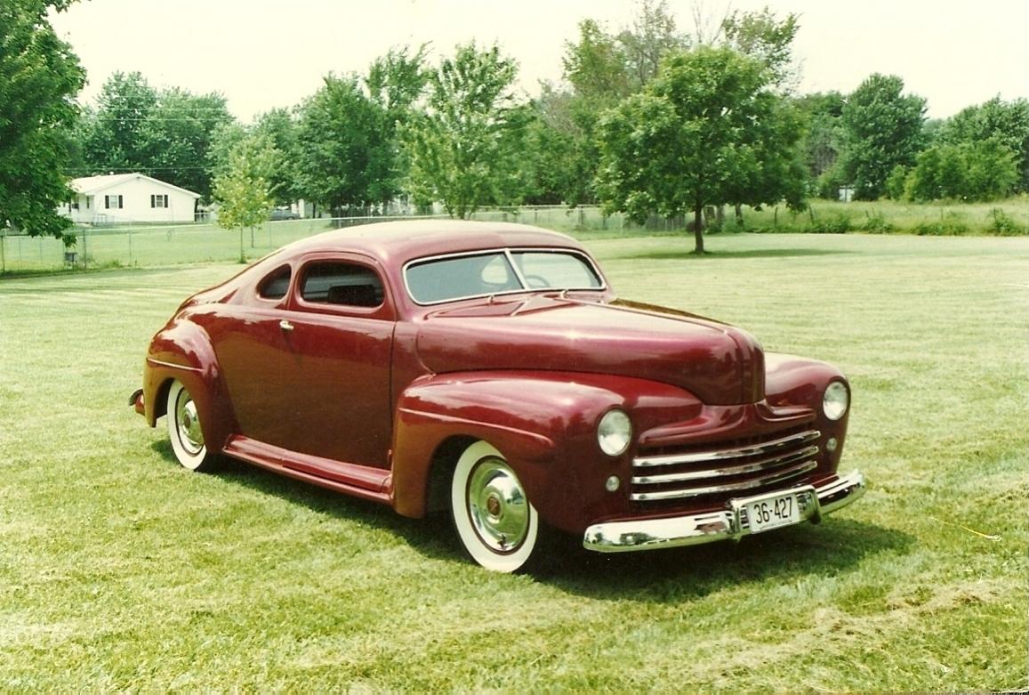

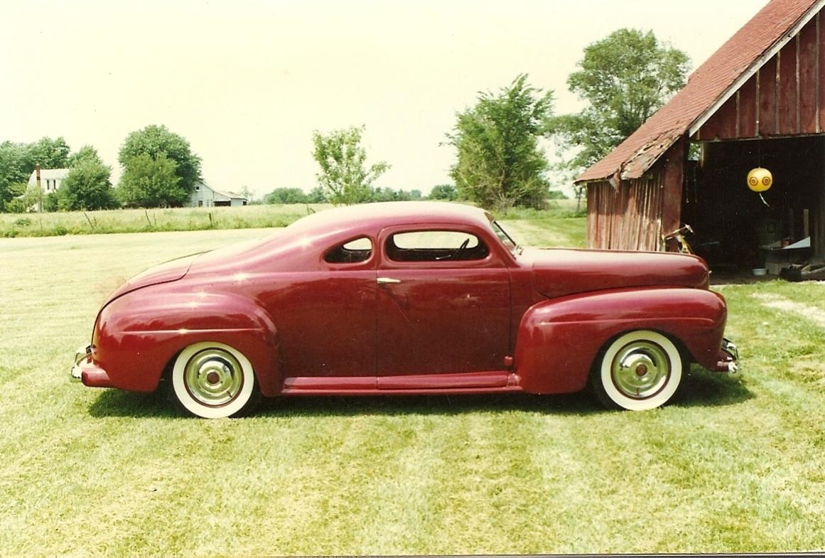

    I don't know if this will help you or not with the 1/4 windows. I have scanned some photo's from the late 80's I took of this car after I finished it.
    The owner had the '48 chopped by Doug Thompson in the mid 80's. The owner then had me do the rest of the work.
    It was a pleasure to meet and go to Doug's shop. He was a very friendly person to talk to and gave me lots of advice while I was building the coupe.
    I think he is one of the best customizers ever.

    WOW that is a great car... of co**** its a short door coupe with much different proportions that need a different approach. But no matter what... that is a fantastic custom. I'm a big fan of Doughs work and I had never seen this one before. He did a great job on the chop, and you on the rest of the work... if you have more photos of it... please scan and post.

    I agree 100% Dougs work is fantastic, I dont know if I have ever seen the business coupe above before though , do you know its whereabouts today?

    I apologize for overlooking the fact that your car is a long door coupe. I was so drawn in by your 1/4 window question I didn't stop to think about the difference in the doors.
    Rikster is correct...... 2 different cars...... completely.
    I'll see if the original customer has any more pictures. He sold it in the 90's. I have no idea where it went.
    I was in my early 30's when I did the car and never thought about taking pictures of cars that I was working on. You are doing a great job on do***enting your build with pictures and text.
