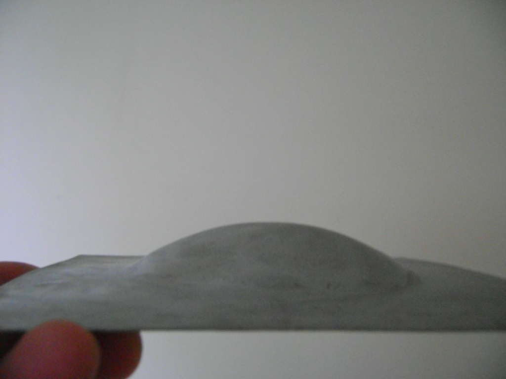

    But I tell ya... If I would have had my e-wheel and planishing hammer (both cheaply built by me) when I used to do this stuff for a living I would have been able to do a lot nicer work with a lot less effort and body fill.
    The attached pics show a 1' sq piece that I beat the **** out of with a ball-peen hammer, then plannished it and wheeled it.
    Once you have them.. they are useful.

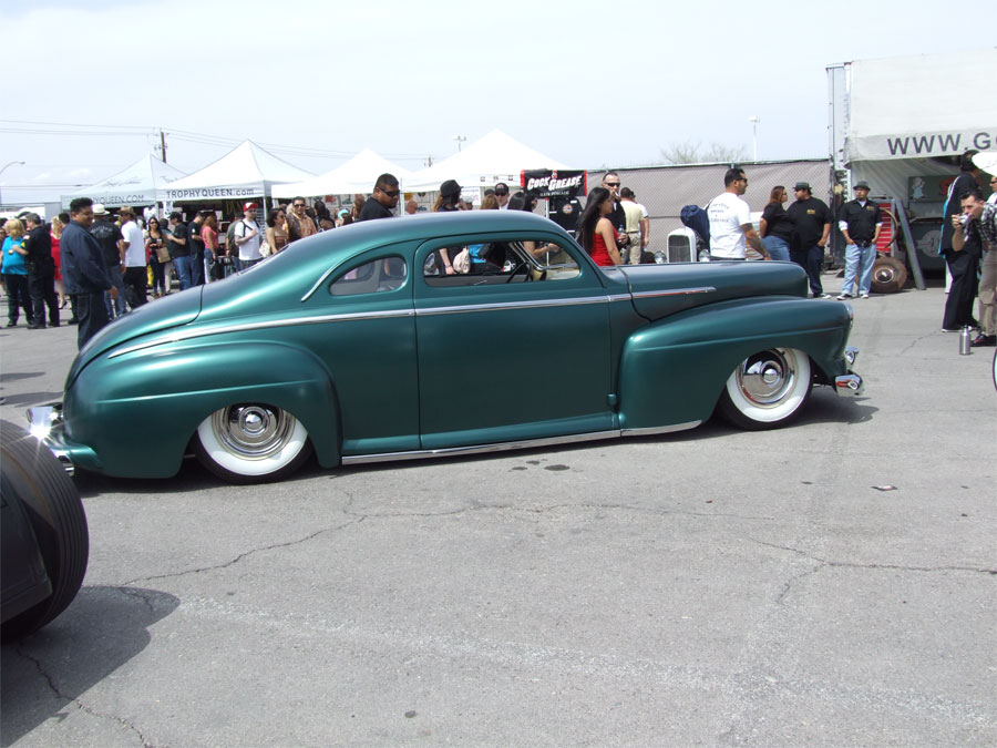

  17. Kool kemp , I love what you have achieved so far,you have great skills and imagination.
    I love the profile that Rikster has photoshopped for you but I would love to see a pic with the driprail put back on as I think it would make it look swoopier and the door and quarter window would better flow together.

    Found a pic of a car that has the drip rail to hopefully show what I mean.

    To me the drip rail results in conflicting lines on the C-Pillar when you chop the top like it was done on the green car, and on Steve's and many others. It only looks "good" when you vied the car from a dead-on side view. If not then the drip rail does do strange things in my eyes...
    Take a look at the photo of the same car below. And how the shape of the C-Pillar is completely different than the drip rail. This really does not help with the flow of this type of body... at least thats my opinion
    Atwater Mike and kidcampbell71 like this.
  22. I see what you mean with the C pillar but this could be over come by making the drip rail flow more with the c pillar.
    More like this.
    kidcampbell71 likes this.

    We all have different opinions on drip rails. I myself don`t like a car that is smooth and everything is filled.To me it looks to thick,or a sod box.That`s the bodyman in me,But that is just my take on customs,everyone is different. I like seeing drip rails cause it makes the roof look lower. That dark green one is nice,the drip rail don`t flow with the rear window that good but other then that is it sweet.

    I always like the front on this car (till the B-Pillars). But the chop has some issues in my eyes. The rear quarter windows are to short, and the rear of the top could have been chopped half an inch or so more to get a perfect balance... or perhaps call it a late 40's perfect custom. Also the forward angle on the B-Pillar could have been done a bit more dramatical...
