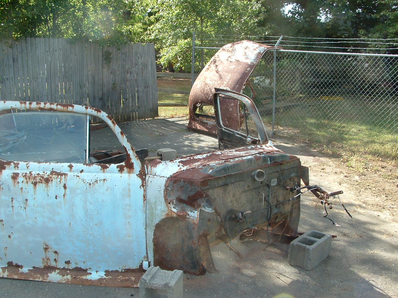

    I have somehow overlooked this thread til now but I got to hand it to you Koolkemp, that is some bad*** workmanship you got going on there! I got 3 of these 46-48's, well 2 1/2, (see pic's!) and this is the inspiration I needed to get off my *** and get back on it. The black car has a righteous body thats begging to be chopped. Thats what I been saving the other 1/2 car for! Again very good looking work!
