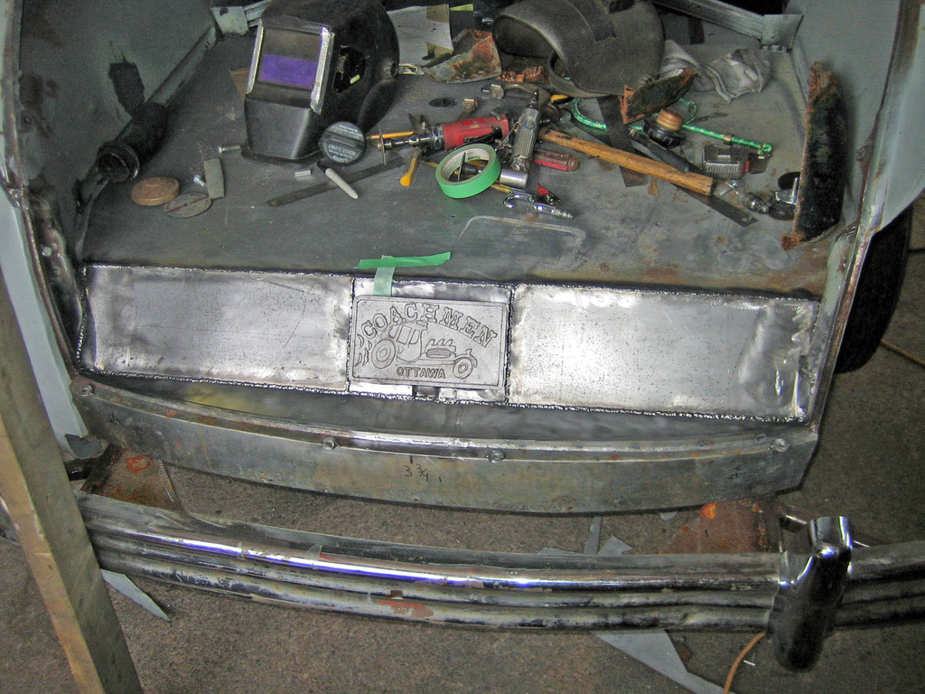

    Well I promised everyone some pics before I went back to work, and since thats tomorrow here ya go lol! I didnt get a whole lot done on the car...spent the better part of a week getting a winter beater put together for the wife, got real live electricity in the shop, (no more extension cords from the house!)
    got to spend some time with my brother and his family who were here from Ottawa for the holidays, dealt with my wife and daughter both being sick and have been sick myself for the last few days as well...all in all a great little holiday:rolleyes:
    So I decided on a set up for the gas tank filler, there just wasnt enough room to run it to the original gas door without using up some of the little trunk space I have left, so I used a filler neck I robbed from a friends old S10 cleaned it up (had to fix a rust hole in it ,surprise !) and fitted her up to the 55 chevy tank I am using
    I cut out the gas door from the S10 as well but I didnt have enough room to run it after I sectioned it so I just used the opening...
    Then I was able to finally finish off the back of the trunk floor and get it all welded up solid, and finished up the weatherstrip lip as well...
    I am not quite sure what I will do for a door yet, I was thinking of taking a plaque from my club in my hometown and maybe hinging it ...or cutting a chunk of 1/8 stainless I have and making a door from that ...
    I got another couple of hours of welding on the trunk area then it should all be done, I will probably bolt up then weld on the rear fenders after that, that would give me an excuse to ***emble the english wheel so I can shape some nice strips of metal to mold in the rear fenders :D

    Love the plaque idea!! Good show, impressed that you got anything done over the holidays. I didn't. :(

    Ya.. the plaque idea is great. Go for it.
