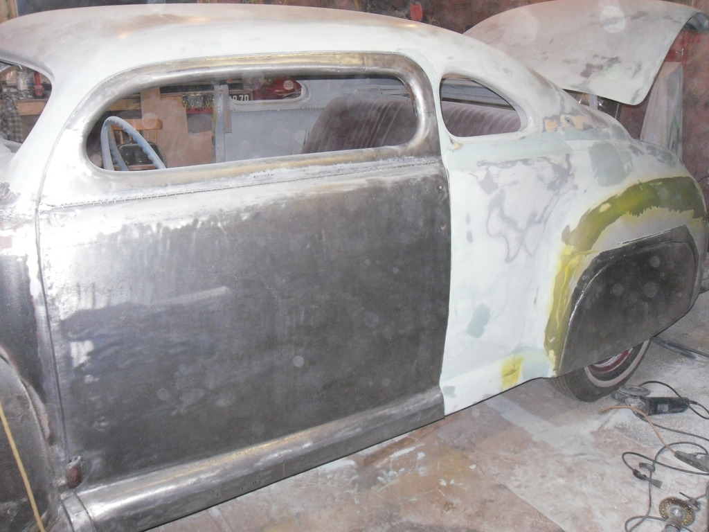

    About as exciting as it gets ! I have been trying to get it fairly straight...less work to do later I am close to ready to get a fresh coat of epoxy on the roof/quarters and trunk lid, buts its still a little too cold to paint...which is how and why I kinda got carried away getting the mud work doneat least now I will be able to seal up the basic shell and get going on the rest of the panels. Anyways you guys seem to like pics :rolleyes: so heres a few boring bodywork ones. The yellow zinc primer is to keep the flas rust away from the bare metal spots where I have broken through the stuff epoxy on the car now.
    Door gap looked like **** so same idea as the other side 1/8 rod fully welded on..
    Bit of fine tuning later on and it will look pretty decent...
    I hated this side of the splash panel its pretty much covered by the bumper but I still had to re do it.Went super fast with the shrinker, new piece cut/formed and welded up in about 35 mins !
    Cleaned up and the offending area removed..
    Welded up ....notice I cut it too short and had to weld the end back on :rolleyes:
    kidcampbell71 likes this.
  23. The doors gap looks great. What a big difference on the before an after!
  24. koolkemp
    Joined: May 7, 2004
    Posts: 6,006
    koolkemp
    This trunk gap drove me nuts till I fixed it this weekend...doesnt look like much but its much betters and I can live with it..it will get some fine tuning later anyways. The gap was too wide, and lower than the trunk skin in some spots and higher in others.I cut the whole edge off and did some reshaping then welded a piece of rod in, but it looks so much better.I forgot to take pics before but I am sure you could see it somewhere else in this thread.
    Splash pan is all moded in..
    See nothin to exciting to look at but a bunch of work nonethe less! I am looking forward to seeing it all primed up hopefully soon.
