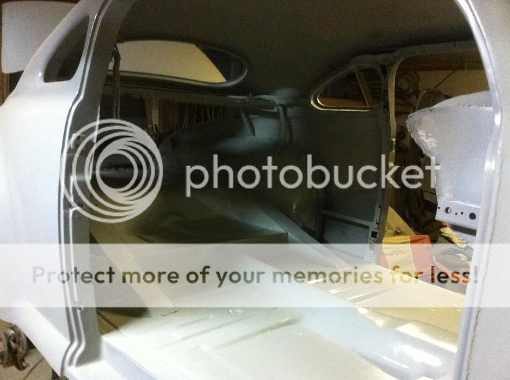

  7. koolkemp
    Joined: May 7, 2004
    Posts: 6,006
    koolkemp
    Thanks for the kind words guys, I had been in bed with the flu until yest, started feeling ****ty new years day ,dragged my *** in to work last wed then felt like dying...I have never been so sick in my whole life as this last week, spent 8 hrs in the ER and an ambulance ride to Halifax thurs night for a CT scan (they thought I might have been having a brain bleed) came back to work today but I probably should have stayed home. Mrs Koolkemp and my daughter are sick too but didnt get it as severe as I did...I wouldnt have wished this misery on my worst enemy! 4 litres of iv fluid ,another bag of some pain killer then finally morphine to try and help with the head pain :eek: Hopefully I will feel a little better by the weekend and might get a little time in the shop...heres a few ****py iphone pics from new years day when I got the primer on the floors and the cowl. I havent had the energy to take any more pics with the real camera.

    We've had some of that crud around here, nasty stuff! My 2-cents on your cowl vent; you've blasted the bad stuff out, metal prep it and use a non-hygroscopic epoxy like J. B. Weld. You can form it and it works about like body filler. Nobody would know, 'cept all of us Hambers!!! What's the weather like up there??

    Believe me this thought has crossed my mind, I blasted the underside as well so its nice and clean...POR15 then some epoxy? Its either that or make a hammerform, I havent got a chance in hell of getting a donor cowl top around here lol! I really thought I was done with the rust on this thing! We just got our first snow a couple of days before Christmas, nice and sunny +5' celcius, dont remember what that is in normal temps anymore !

    Everything I read is that POR15 doesn't like being on super clean metal but maybe ok on blasted?
    I hope it holds well for you so I'll try it myself. ;) As you have learned... we have RUST here like few others have.

    POR-15 works only on rusty metal. On clean metal it will peel off. So use JB Weld or Allmetal filler or lead or something. Or let it rust a little first.

    ditto on the POR-15 on clean metal, it needs the rust to react with.

    It works as good or better on blasted metal than on rust.
    Sand blasting gives it an even better porous surface than using the marine clean etch that they sell to use it on "clean" metal, try it out and see what you think!

    I'll take your word on the sandblasted steel, who can doubt it based on your work
    Just bare metal seems to be the problem

    Iknow all about using it on bare smooth steel...learned that lesson along time ago :eek:
