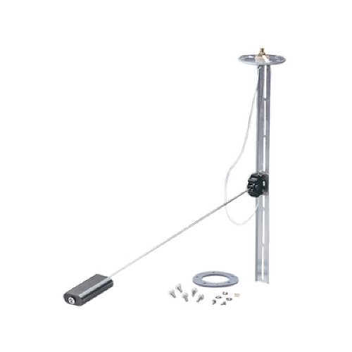

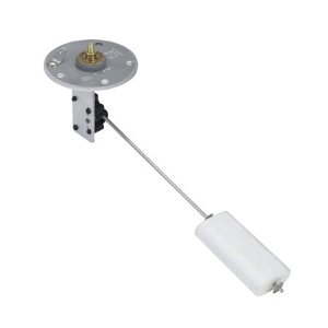

    Can you run a sending unit in them ?
  5. JAWS
    Joined: Jul 22, 2005
    Posts: 1,849
    JAWS
    Yeah. Have to seal up the hole, but it's like doing any other custom tank. A universal sender or one matched to a gauge that is universalish, is what I've used in the past.
    They are round and have five holes for mounting screws and you cut the float arm to length.
    I think even some of the bladders have a provision for them.

    Steve, Jaws nailed it. The sender and gauge need to be compatible. There are a couple ways to do this but if you can get a matched set out of the gate its not such a pain in the *** calibrating them. Hows the rest of the car coming?

    With the 59 dash/guages I think they were 0-30 ohms I will have to check, it would have worked with the 55 tank sender cause they are the same ohm value ...I spent last weekend underneath it got all the underbody rocker guarded , a whole gallon and 2 spray bombs :eek: used up all I had in stock lol.I then brushed on a good coat of tremclad gloss black ...got the frame prepped and shot with some black epoxy primer , and will give the underbody and frame a last coat of semigloss black tremclad this weekend and call the underside done....I hope ! I can start cleaning up the motor/trans and give it its rattlecan r/b :rolleyes: and maybe get it in the ch***is soon, I am really wanting to get it bolted down for the last time, but it will be easier to do the exhaust and plumbing with the body lifted up so it will be awhile before I get there but its on the horizon! I will get some pics up this weekend I promise !
