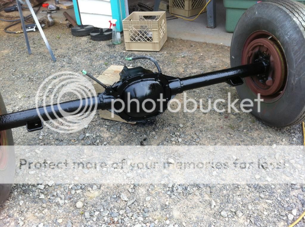

    Ok got some ****py iphone pics for you guys ! The sequence my be a bit out of order but I think you guys can figure it all out :D
    Decided to box and enlarge the c notch a bit
    Got the rear end blasted and painted...
