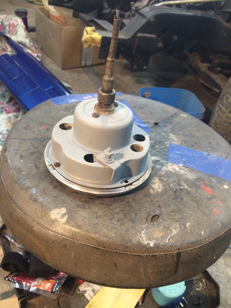

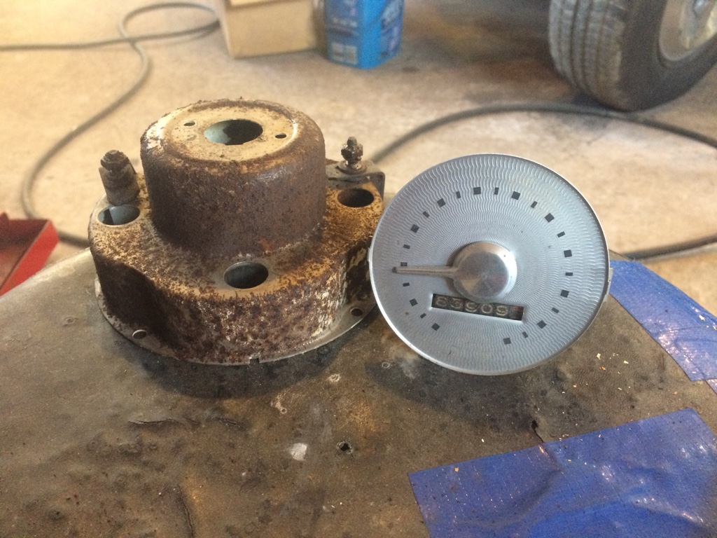

    A bit of progress on the 47... I figured finding the 49 Merc dash bits and ***embling it might take me a full day of puttering , well 3 days later it's presentable enough to put in . [​IMG]
    It two days to find the speedo that had somehow migrated to the ba*****t in a box of unrelated parts.
    It was pretty scabby so I cleaned it up and actually got it un seized . Anyone know if a GM cable might screw into it?
    [​IMG][​IMG][​IMG]

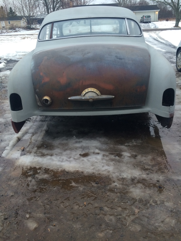

    I could use the help to get the Juncury outside. I've added some extra metal to it , getting heavier lol![​IMG]
