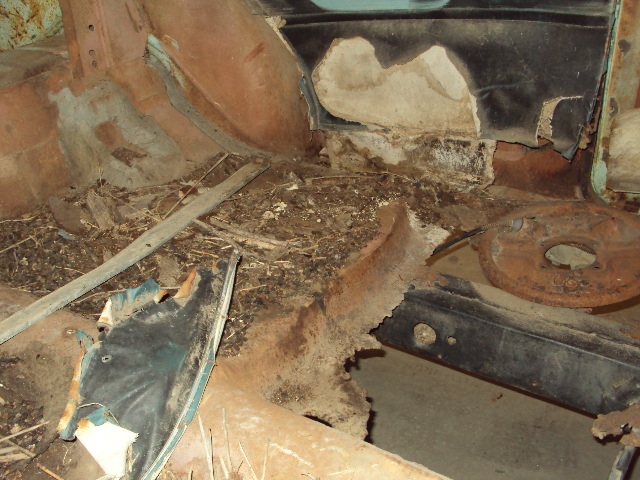

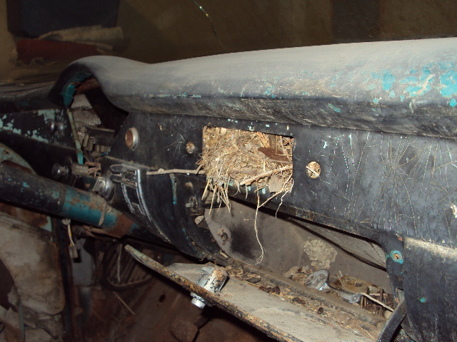

    Great job!! Here was mine when I got it home. Pack rats had been in it. :)
    It cleaned up rather well though.

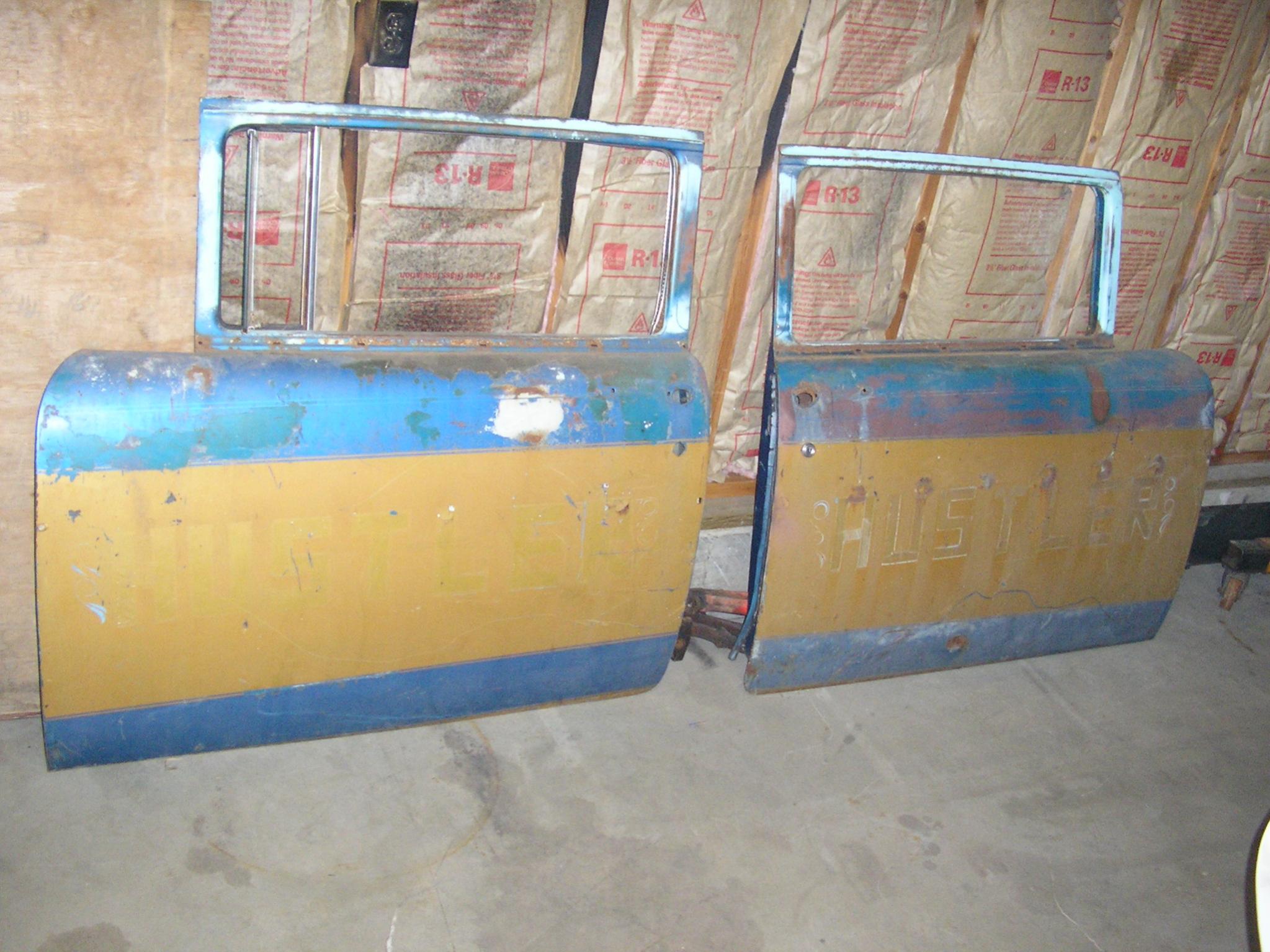

    Since my welder seems to have taken a "dirt-nap" , decided to work at rebuilding the doors. The old g***er doors say "HUSTLER"... they appear to be 57 doors (based on the trim hole configuration). These doors have been gutted so I am going to put all of the inner-structure back so the doors latch properly and gl*** can be installed in the original fashion. The rusty 2 door, doors are donating the necessary parts along with some interchangeable 4 door, door pieces.

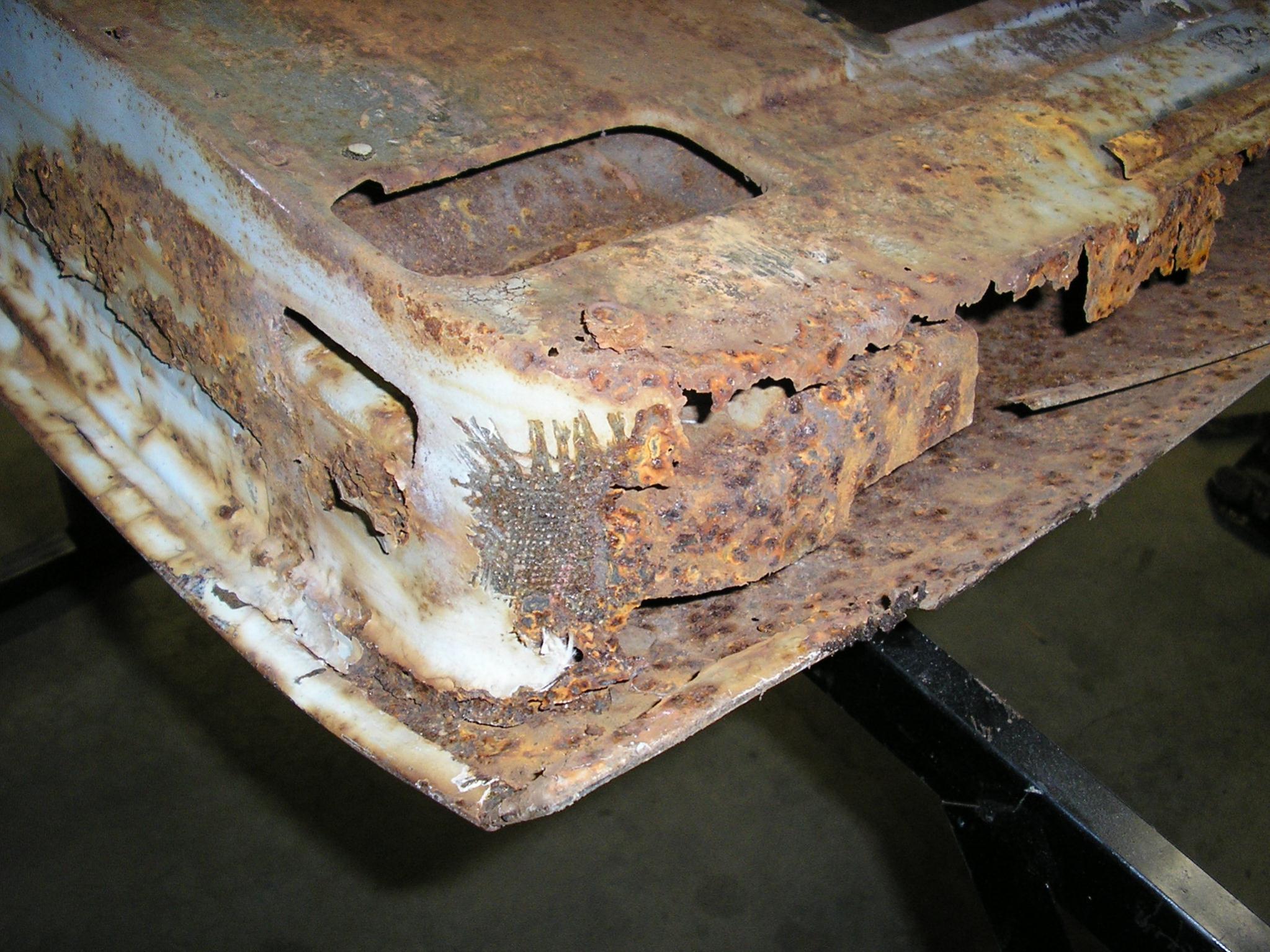

    Here what I started with

    Looks like you had some pack rats too!:eek:

    FYI, 55 and 57 doors are the same (minus the trim holes). On 56 doors the lock position is closer to the handle.

    Funny you mention that, because when I had my '56 years ago everyone thought I was crazy when I told them the 55 and 57 doors are different!

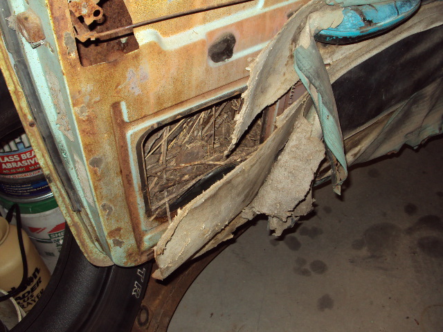

    barn find 001.jpg Started cutting pieces from the very rusty pair of doors that came with the matching body...atleast it was a set!
    I plan to use the inners to repair these gutted old g***er doors. I want windows that roll up and wing vents, so between the two, should work out well!
