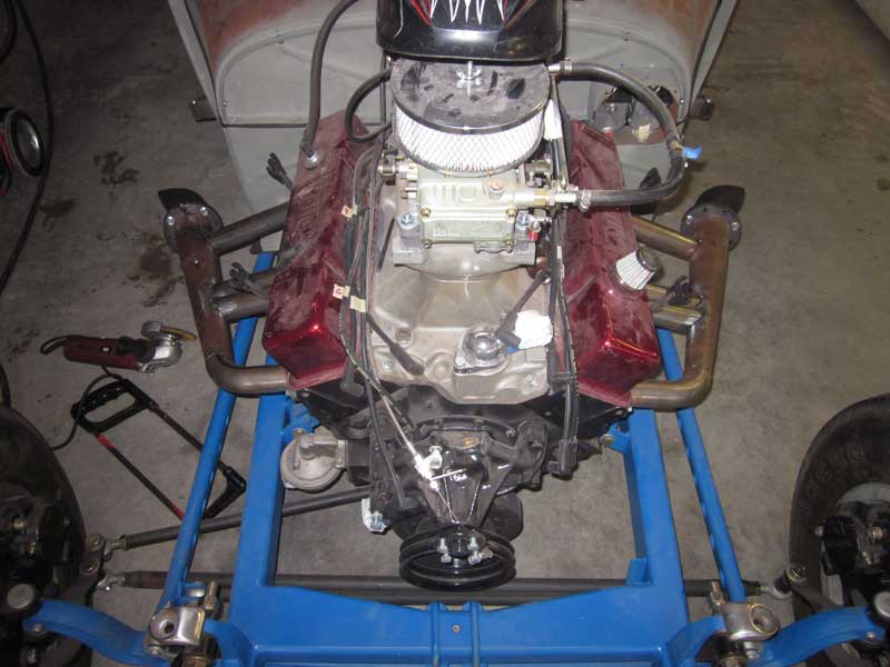

    Rusty Cheese

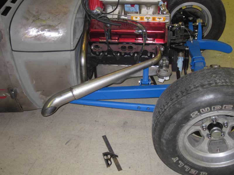

    Header kit... pain in the @ss!!

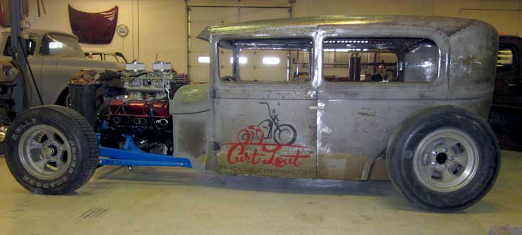

    This is where were at now...

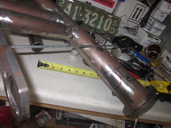

    Rusty Cheese

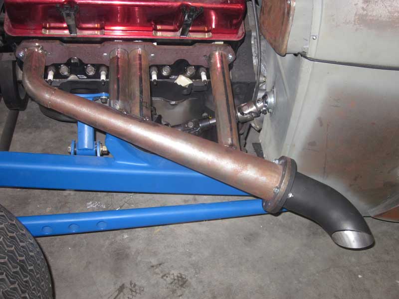

    Header kit... NEVER doing that again!

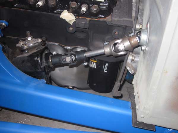

    Rusty Cheese

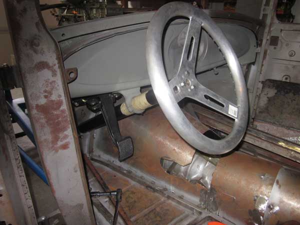

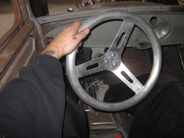

    steering hooked up. not much room when you are 6'2"...

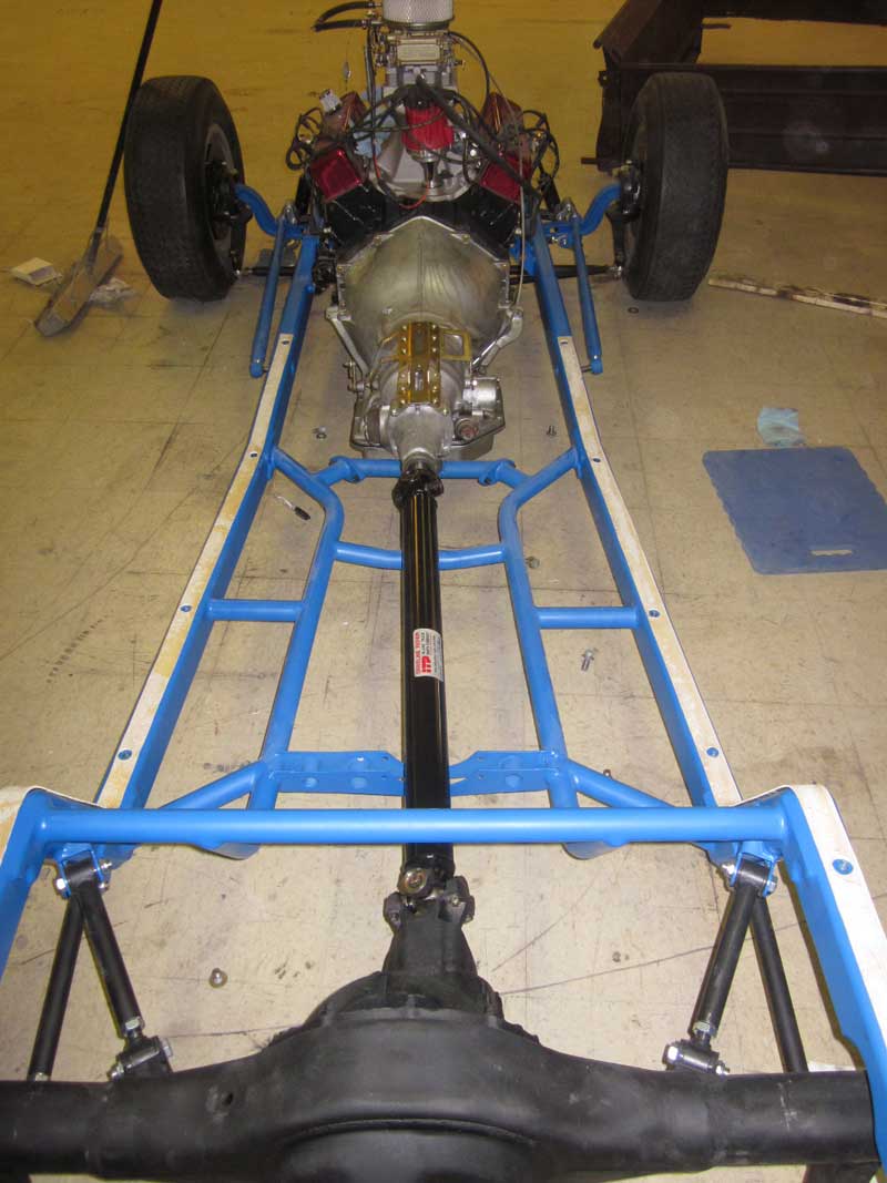

    Not sure if anyone asked - and maybe it's obvious, but why is the driveshaft loop off-center?
  23. Rusty Cheese
    Joined: Oct 11, 2010
    Posts: 336
    Rusty Cheese
    Thanks!
    Because the rear-end third member is not centered on the axle...

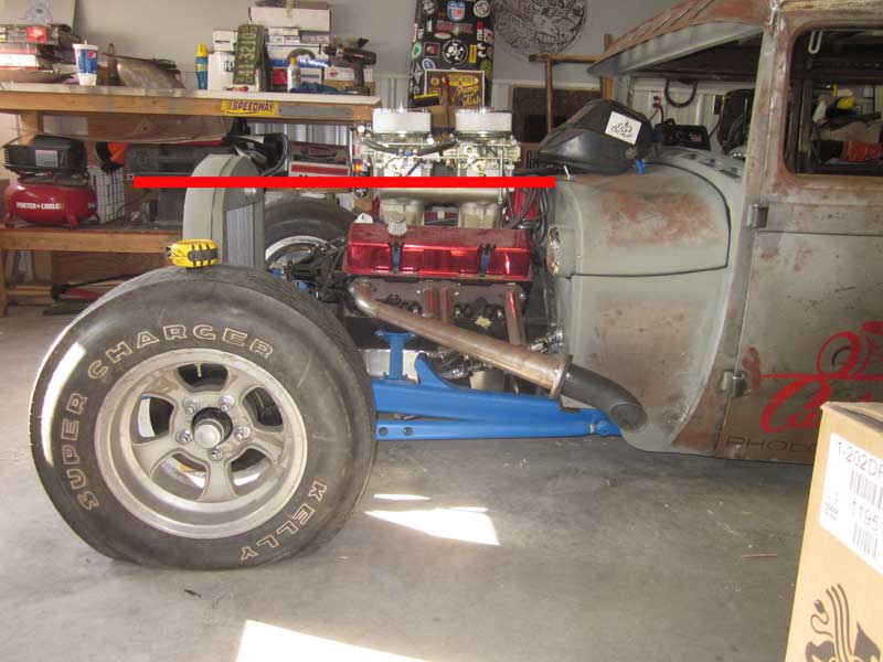

    Rusty Cheese

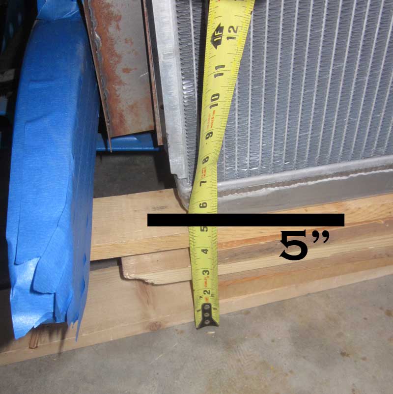

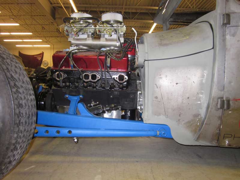

    Something I've been putting off is mounting the radiator... I wanted the top of the radiator to be level with the top of the cowl but it only gave me 2" of ground clearance. So I moved it up. It looks good from the front because the carbs hide the height. Not so great from the side, but i dont want to rip my radiator to hell going over a bump. I settled for 5" of clearance.

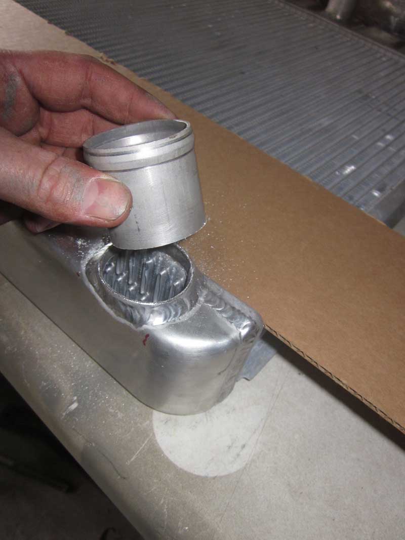

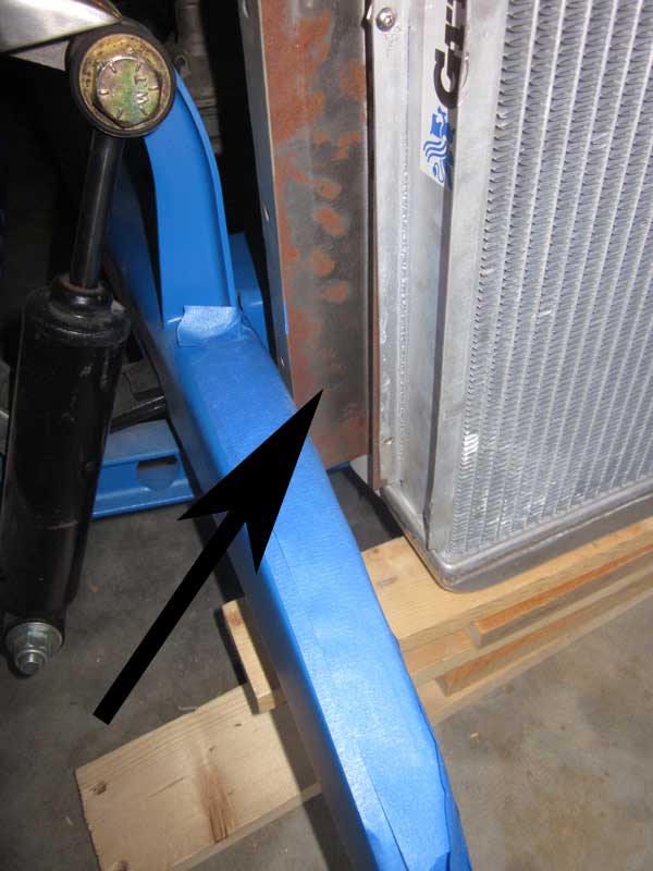

    Im just mocking this all up and trying to work out some issues, that's why I didnt air up the tire. The issue im running into is the bottom radiator hose to the water pump. The axle and the crossmember is in the way.
  27. Rusty Cheese
    Posts: 336
    Rusty Cheese
    So my buddy came up with the idea of cutting it off and moving it up... Watch and see.
  28. Rusty Cheese
    Posts: 336
    Rusty Cheese

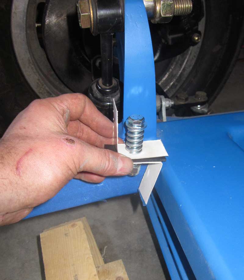

    Time to get some aluminum and bust out the new part. But I still need to figure out how to mount the radiator, so i think a couple simple L shaped brackets will work. Not much work today, but lots of issues solved. Thanks "J" buddy.

    Great build with a lot of great pics and detail. This was a well do***ented build and I appreciate it as I am in the same process with a 28 sedan.
    Can I ask, what was such a PITA with the lake style headers?
