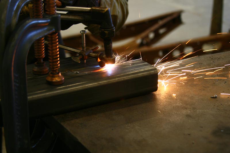

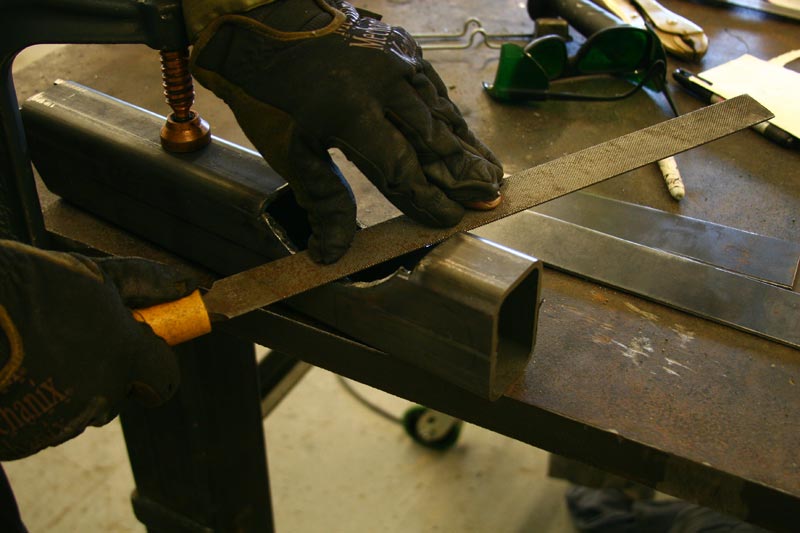

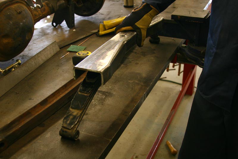

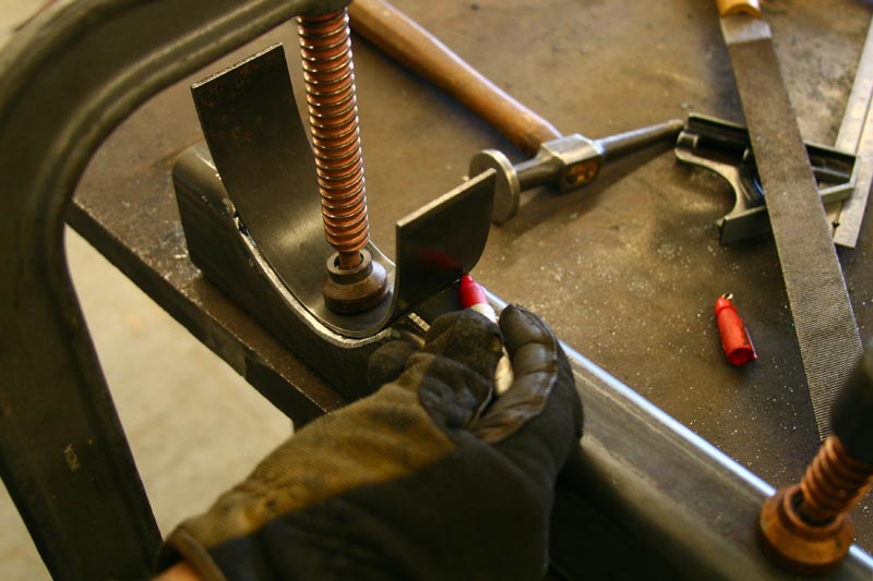

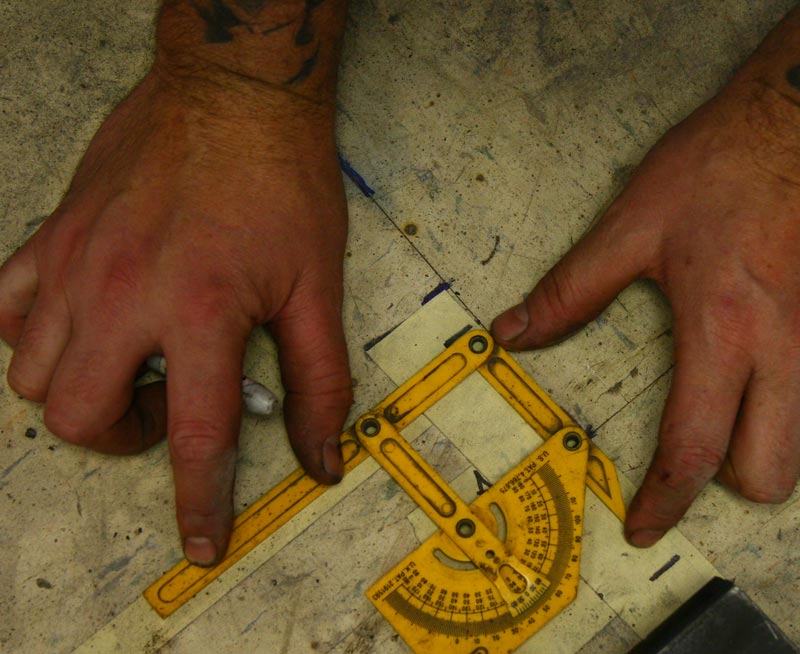

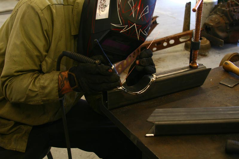

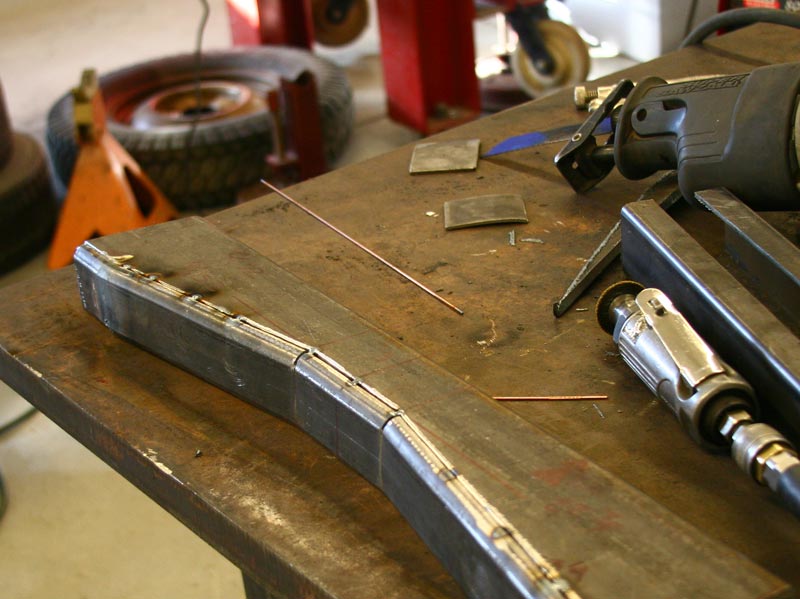

    C-notch time. My instructor had this home made handy dandy comp*** for the cutting torch that worked like a charm.
  2. Rusty Cheese
    Joined: Oct 11, 2010
    Posts: 336
    Rusty Cheese

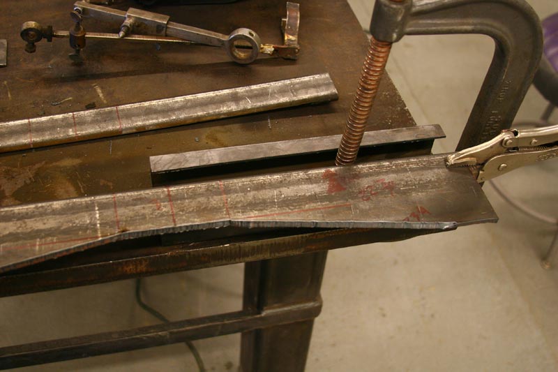

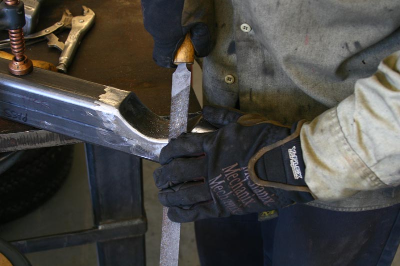

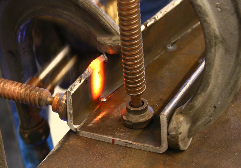

    The C clamp worked great to **** the strap into the c-notch. Cut the ends off and TIG, Grind repeat. OHH ya, then file and make pretty!

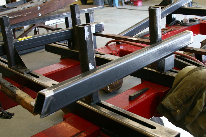

    Cross Member time...

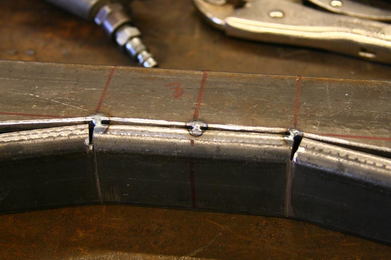

    Rusty Cheese

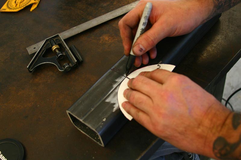

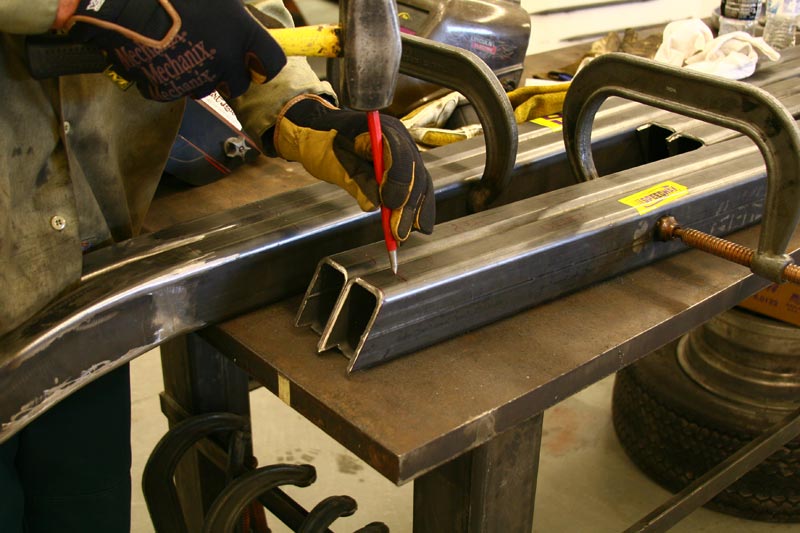

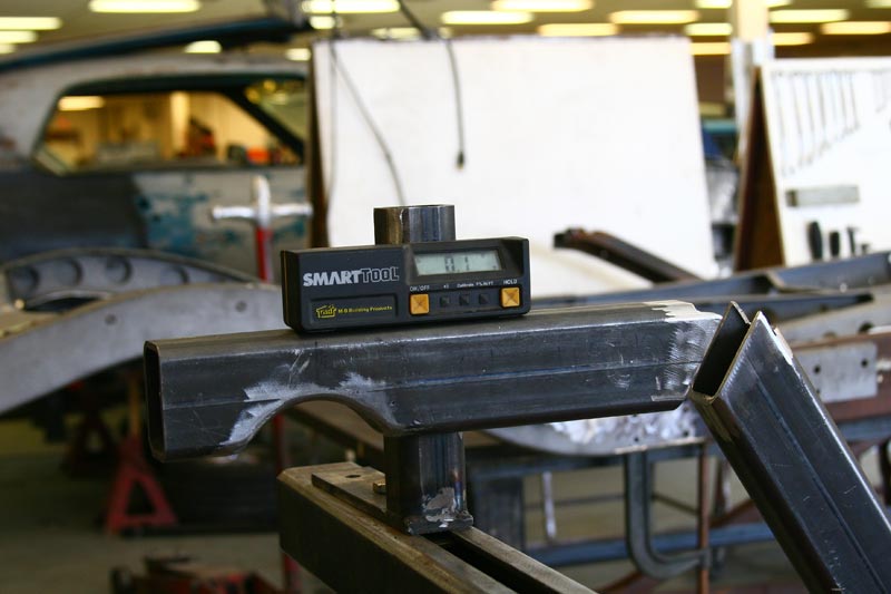

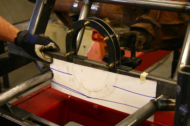

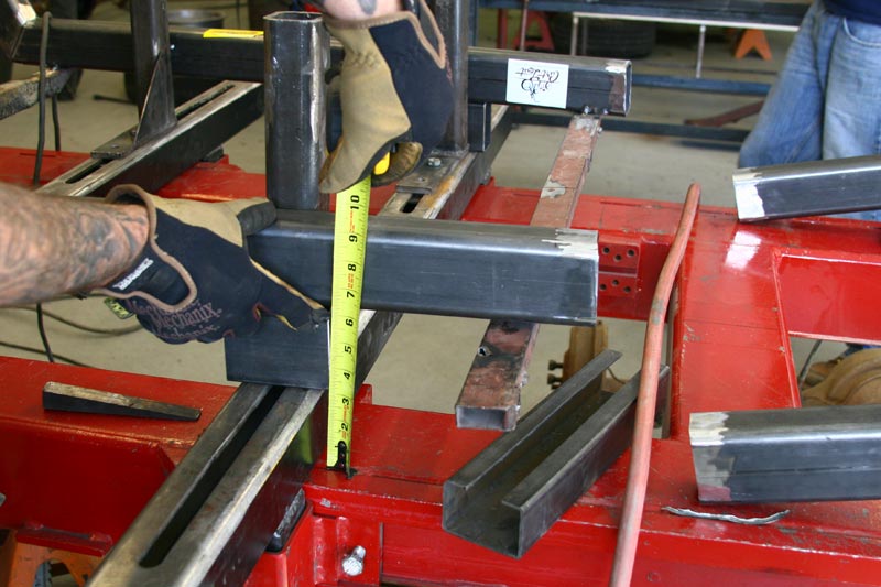

    Going back to check some measurements on the frame layout... started by cutting up a piece of box tubing.
  11. Rusty Cheese
    Posts: 336
    Rusty Cheese

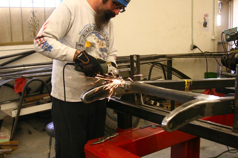

    Grinding. Scored the metal for a nice clean bend.
  12. Rusty Cheese
    Posts: 336

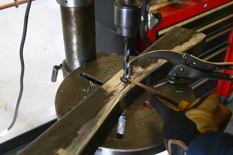

    Rusty Cheese

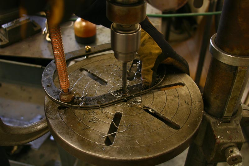

    heat, bend, tack weld. then drill the hole too big. OOPS.

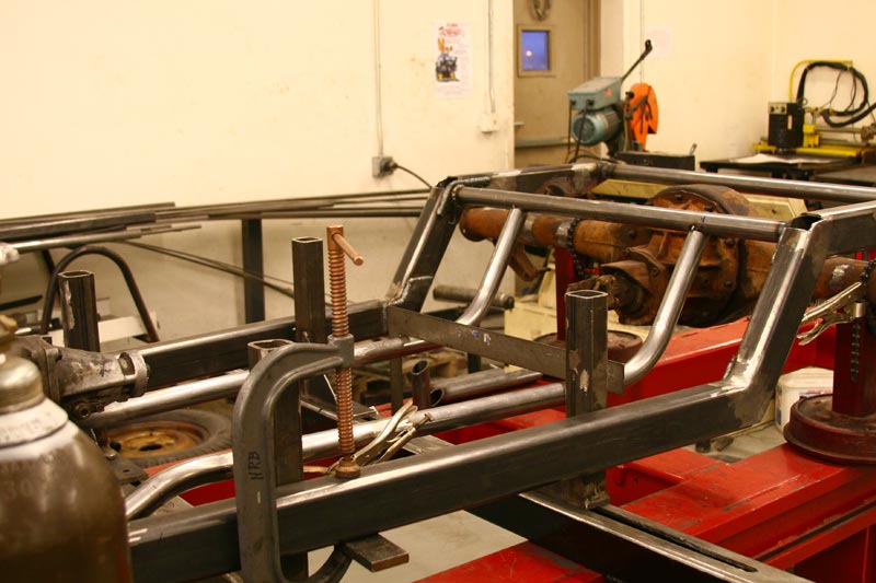

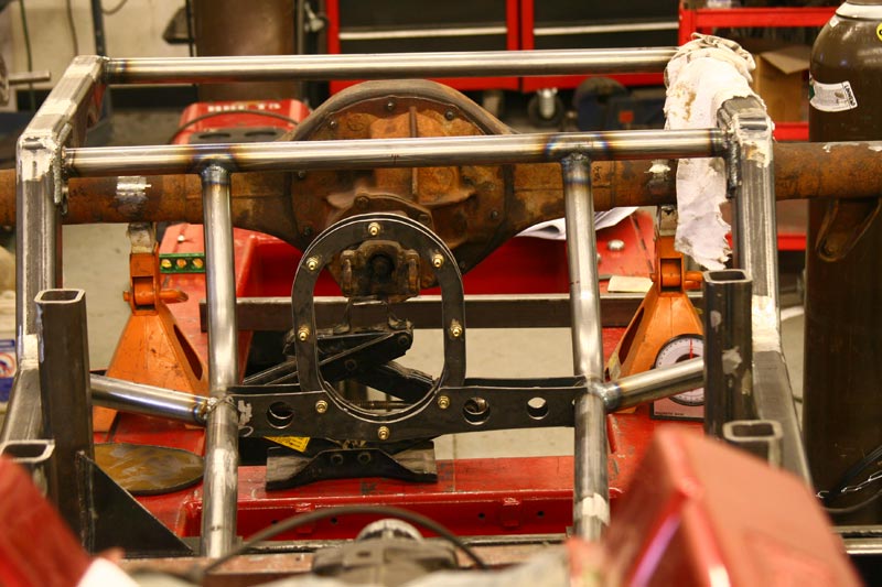

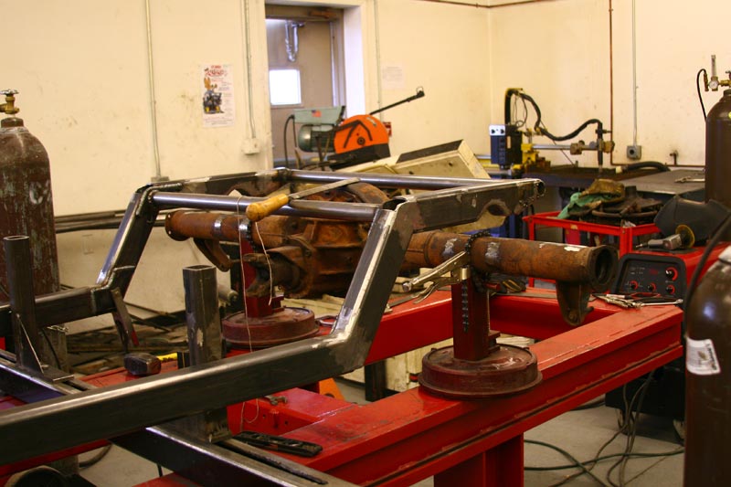

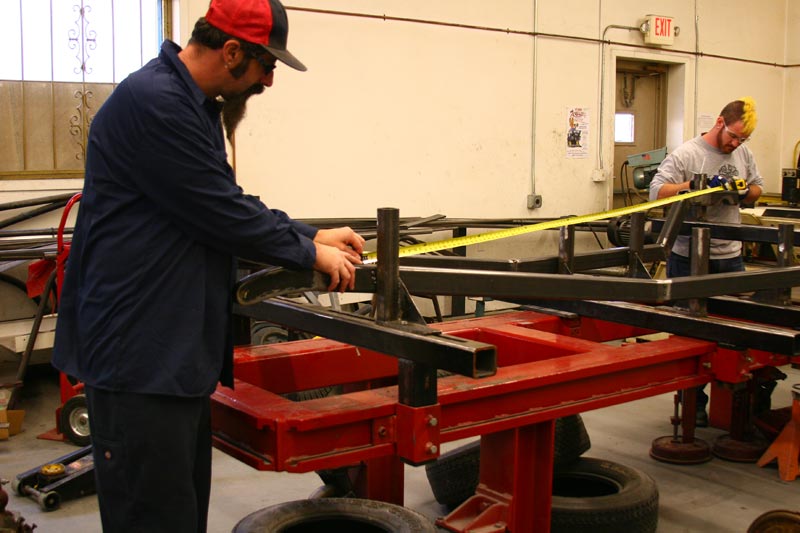

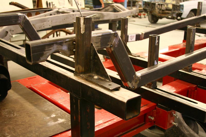

    Lets build the frame!
    I made symmetrical punches for proper measurements.
    Ride height set at 6"
    Tacked to the frame bench, centered with the laser.

    Rusty Cheese
    Moving on to the rear Z.

    Rusty Cheese

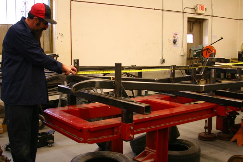

    Final check to make sure we are square with the world.
    Looks good. Time to weld and make pretty.

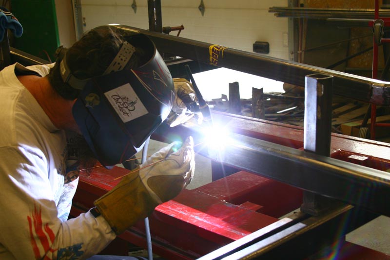

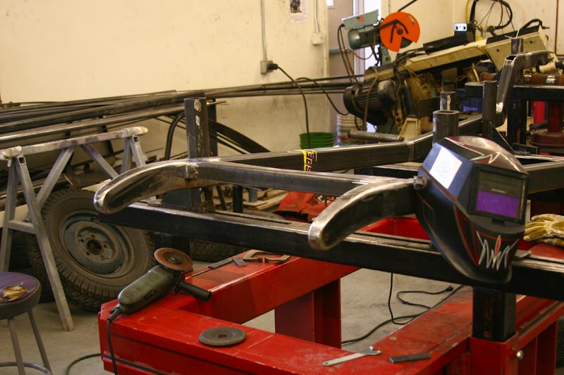

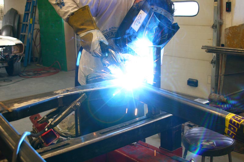

    Time to weld in the front cross member.
    Look mom no hands...

    Action shot.

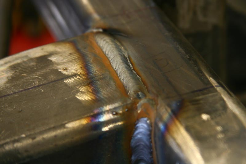

    Rusty Cheese

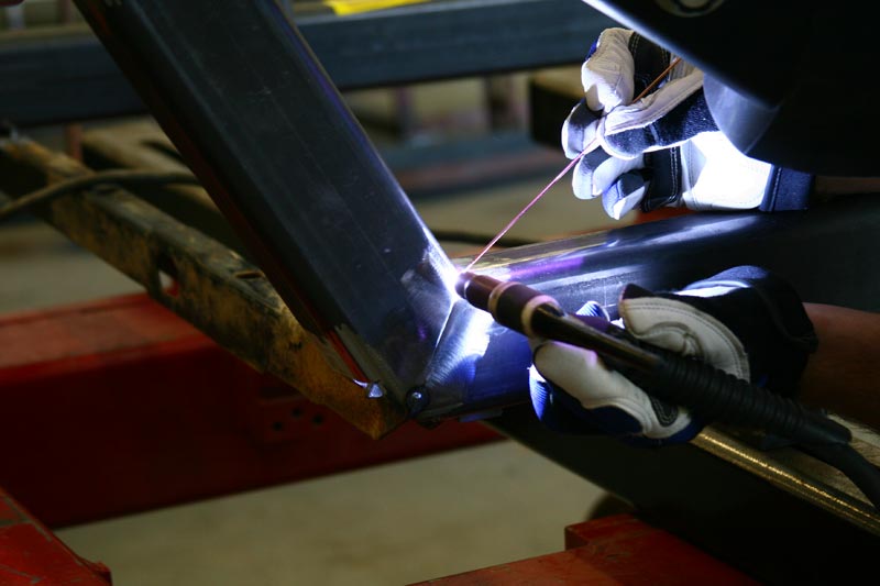

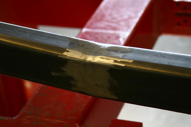

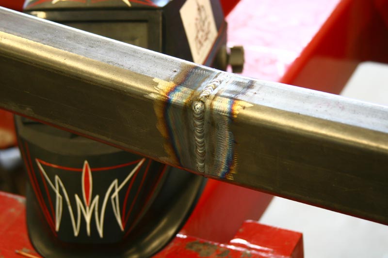

    MIG over the TIG, Grind and make pretty. Sure looks easy in the photos...

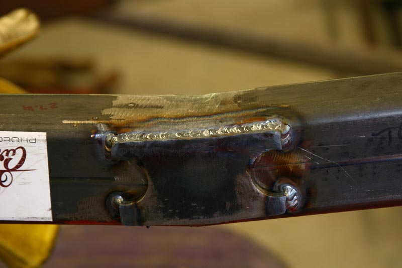

    Rusty Cheese

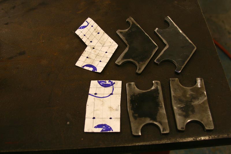

    more brackets. not bad for someone who never welded before i went to this school...

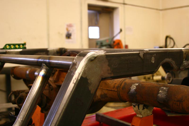

    Rear kickup, coming together.

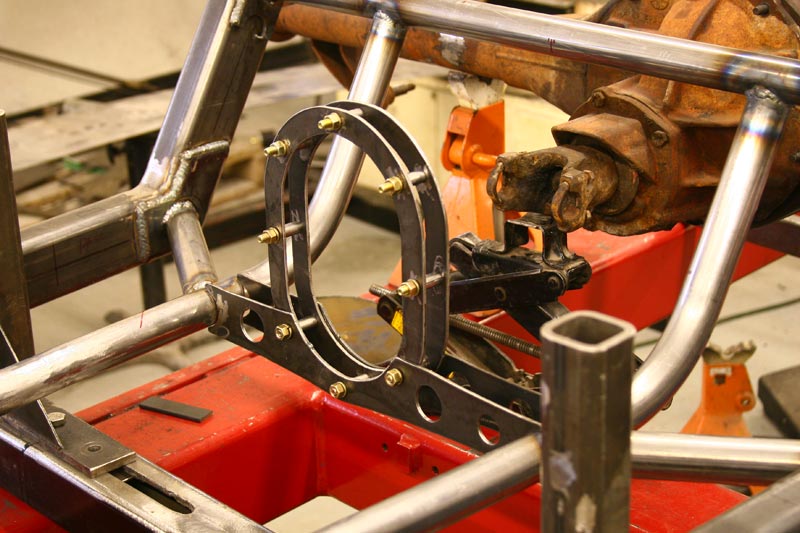

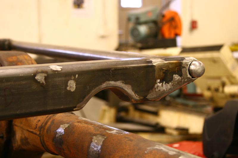

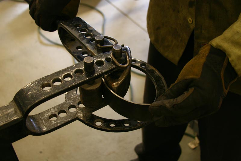

    Ok here is my favorite part so far...
    The drive shaft safety loop.
