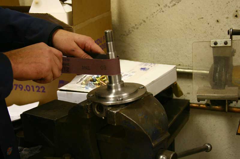

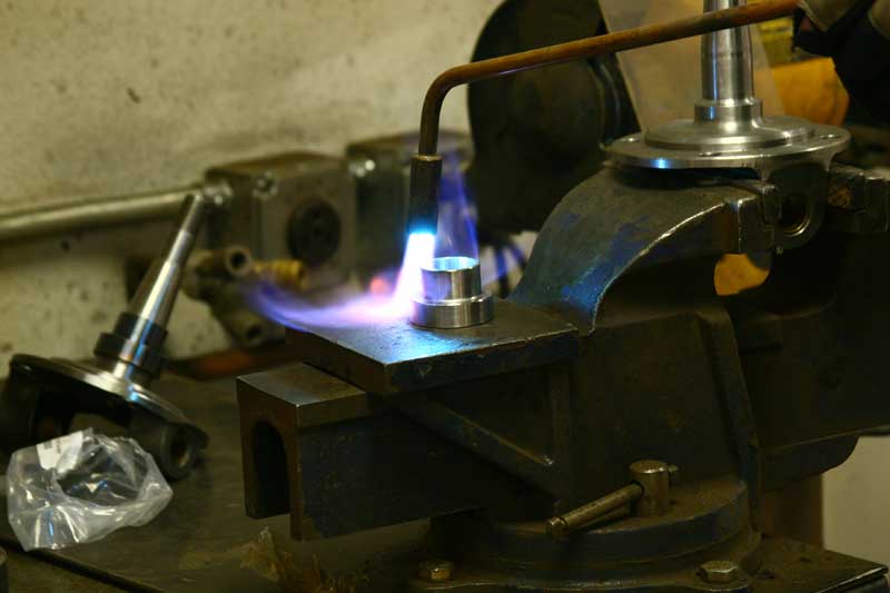

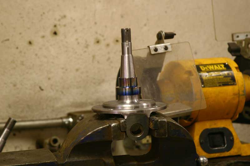

    Rusty Cheese

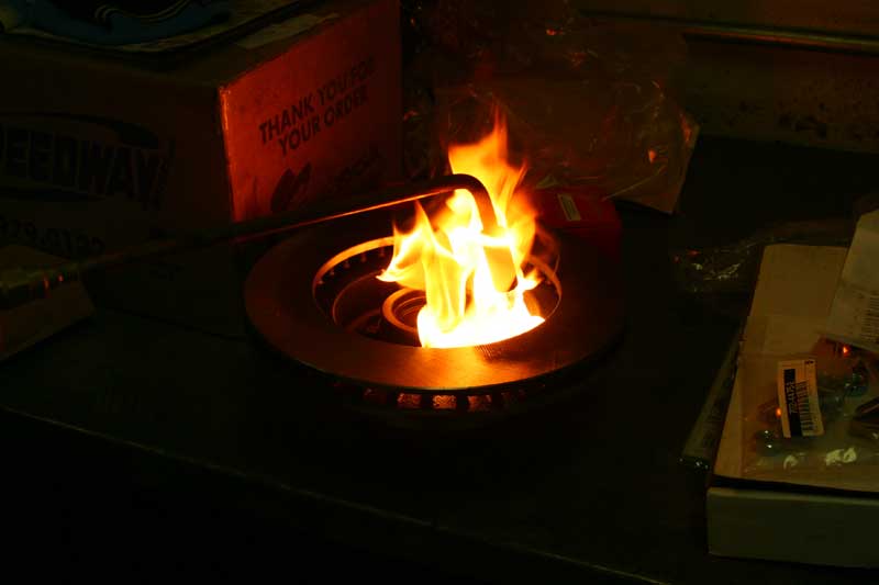

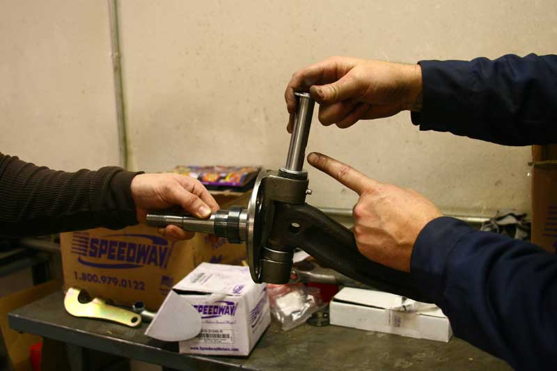

    First time front end install... Ohh clean new parts...
    We heated up the seal and bearing adapter so it would slide right on. glowing blue hot and slid right on.

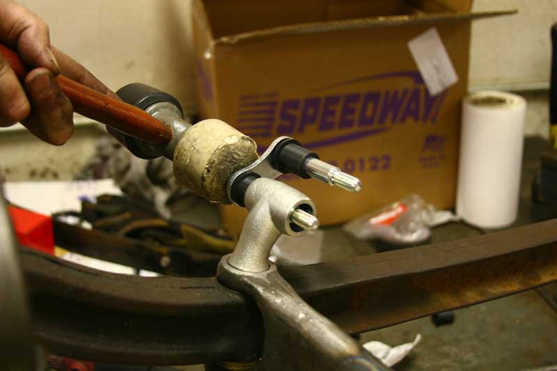

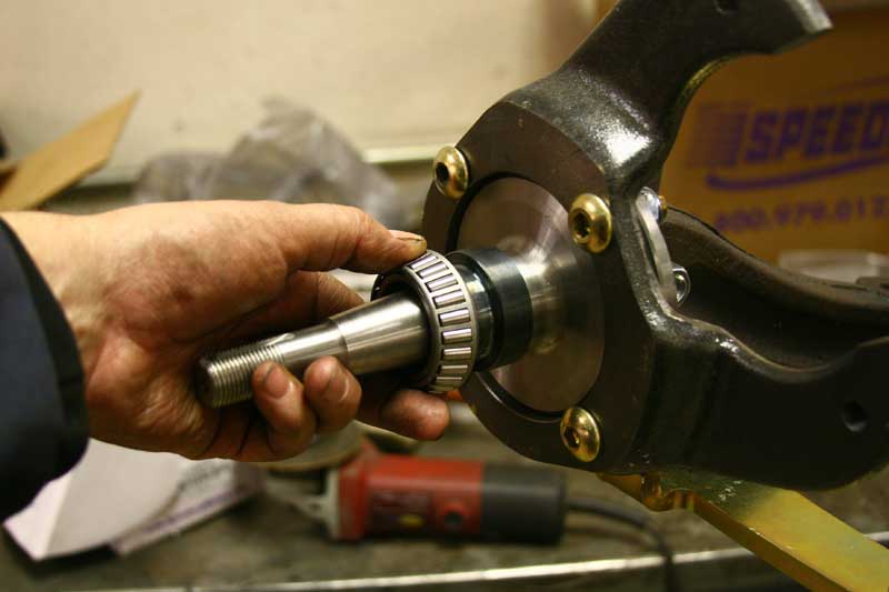

    Rusty Cheese
    Next we took a torch a black smudged the area... why might you ask. well next i MIGed some tack welds to the bearing race that needed to be removed. the black smug keeps the slag from the MIG from sticking to any parts. THANKS Jamie, kool trick. the heat from the MIG made the race slide ride out with just a slight tap. Then installed the new race.

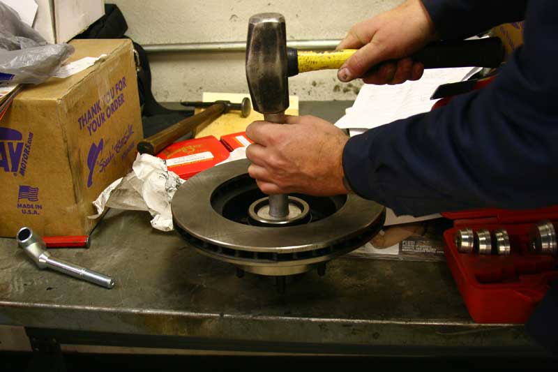

    Rusty Cheese

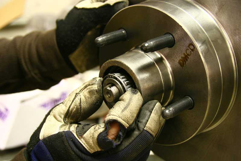

    next all the rotor bits and pieces. this is just mock up so we didn't pack and bearings...

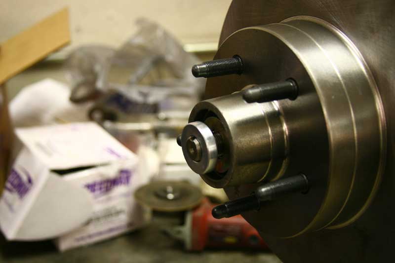

    Rusty Cheese
    spin the rotor while tightening the nut.

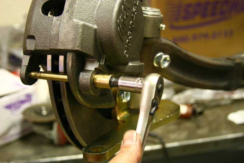

    Rusty Cheese
    brake caliper is next, mockup so no pads yet. i decided to flip the bones for clearance reasons.

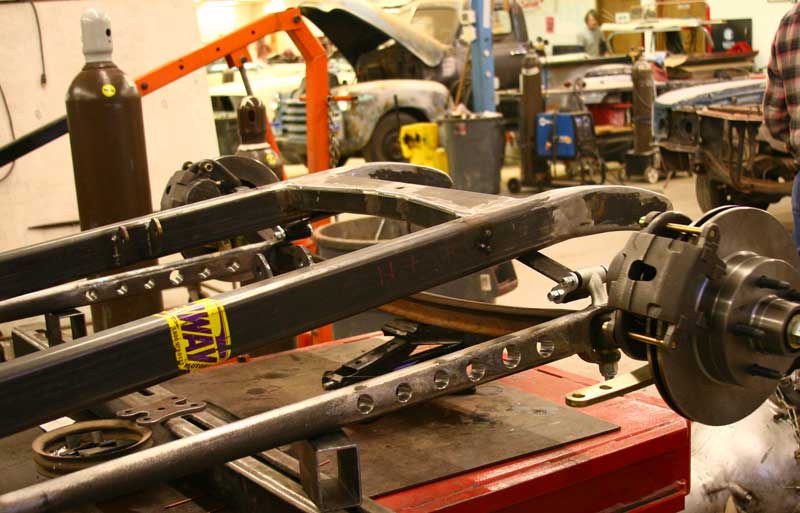

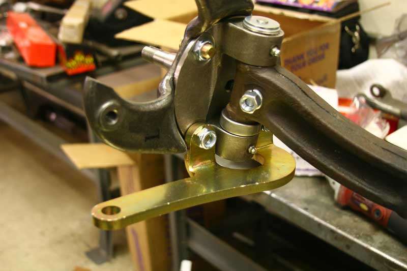

    Rusty Cheese
    Front end looks good, looks like i need to notch the front for more clearance.

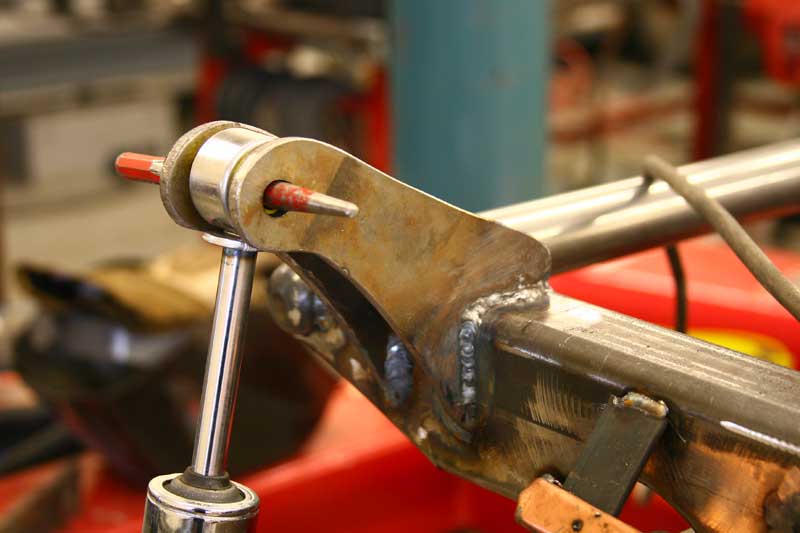

    Rusty Cheese
    Round shock eye mount for the wish bones. that is red reflecting from the frame bench not a contaminated weld...

    It looked fairly contaminated to me.......just kidding. Welds look great Curt. Good thing I showed you how to make it look good.
