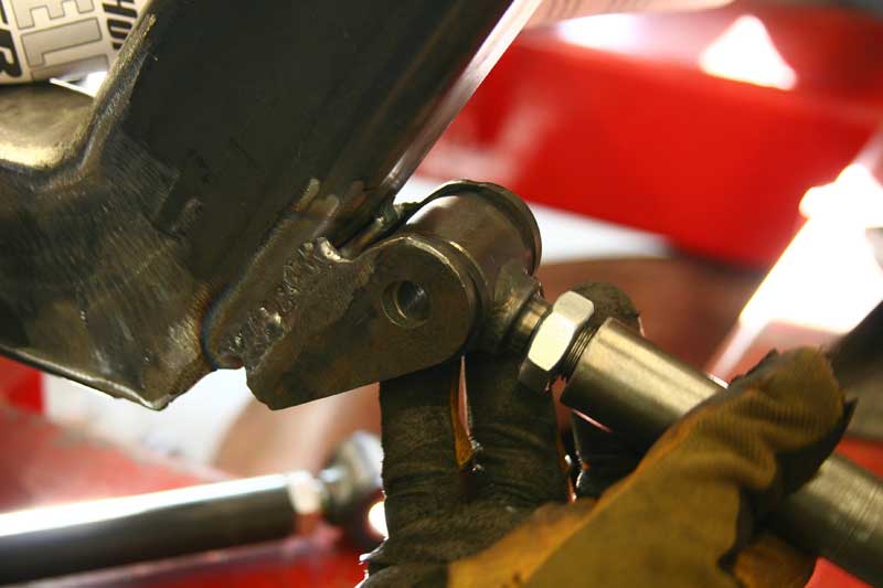

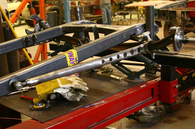

    Ok time to pie cut the wishbones and get them into place.
  3. Rusty Cheese
    Joined: Oct 11, 2010
    Posts: 336
    Rusty Cheese
    A little TIG welding and we should be good to go.
  4. Rusty Cheese
    Posts: 336
    Rusty Cheese
    Oh ya making progress.

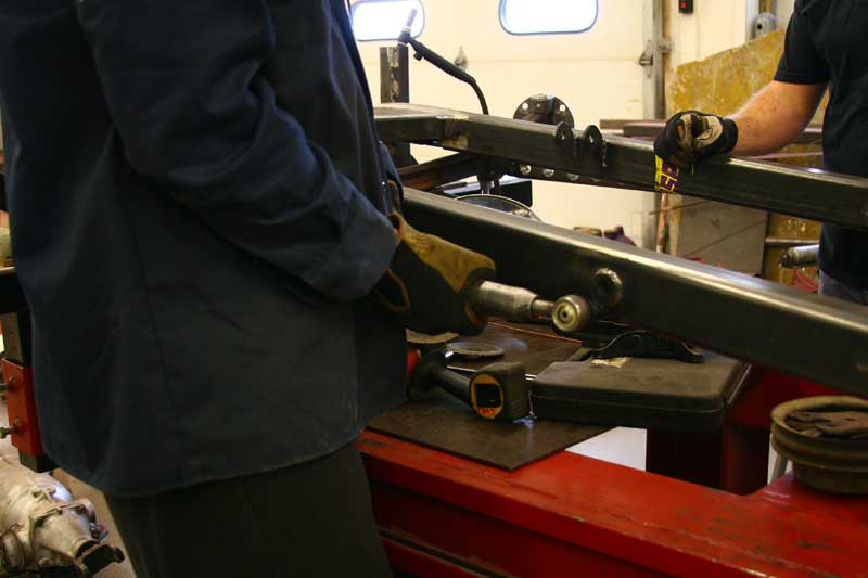

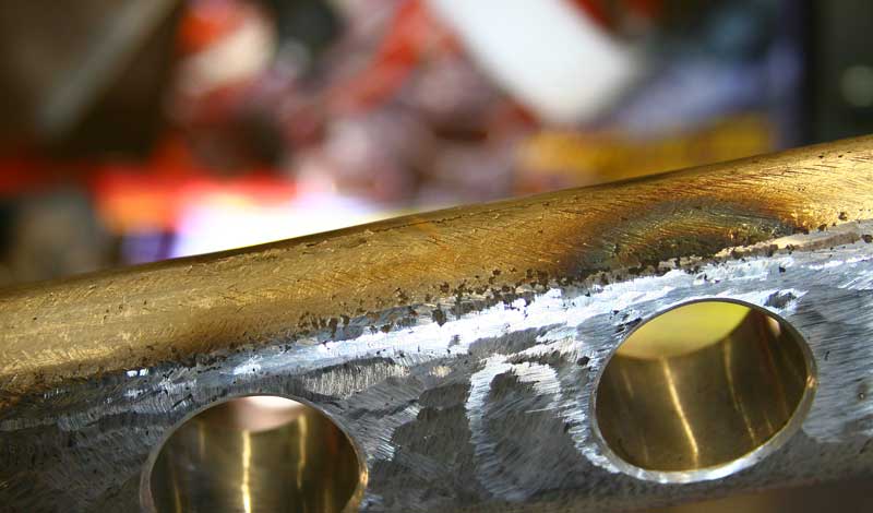

  5. Rusty Cheese
    Posts: 336

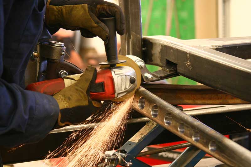

    Rusty Cheese
    We noticed some hair line cracks where the factory welds were cleaned up. So a clean cut and new welds should do the trick...

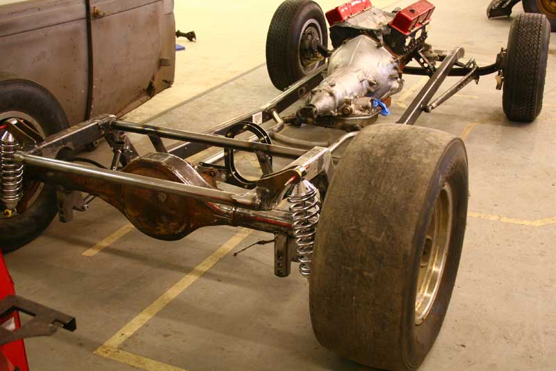

  6. Rusty Cheese
    Posts: 336
    Rusty Cheese
    Rear end...

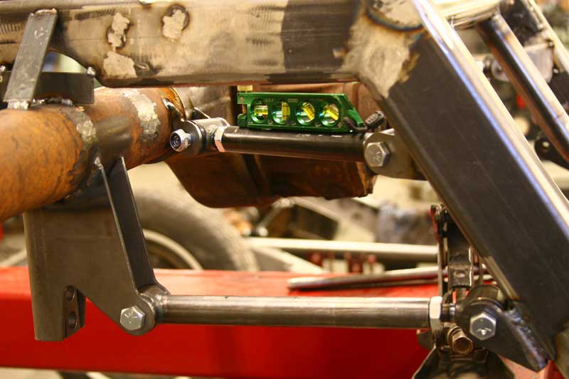

  11. weldtoride
    Joined: Jun 14, 2008
    Posts: 260
    weldtoride
    Thanks for a really good thread, I am a subscriber and enjoy your tech posts, please keep it coming. I have a question about the green level in post #96, it looks like it has both 30 and 45 degree vials, and is magnetic. Who makes it? I tried to blow up the photo to find out but my monitor resolution isn't good enough. Thanks again.
  12. Rusty Cheese
    Posts: 336
    Rusty Cheese
    Im not sure who makes it, I'll check tomorrow. Yes it is magnetic and it is a life saver... It really helps free up your hands.

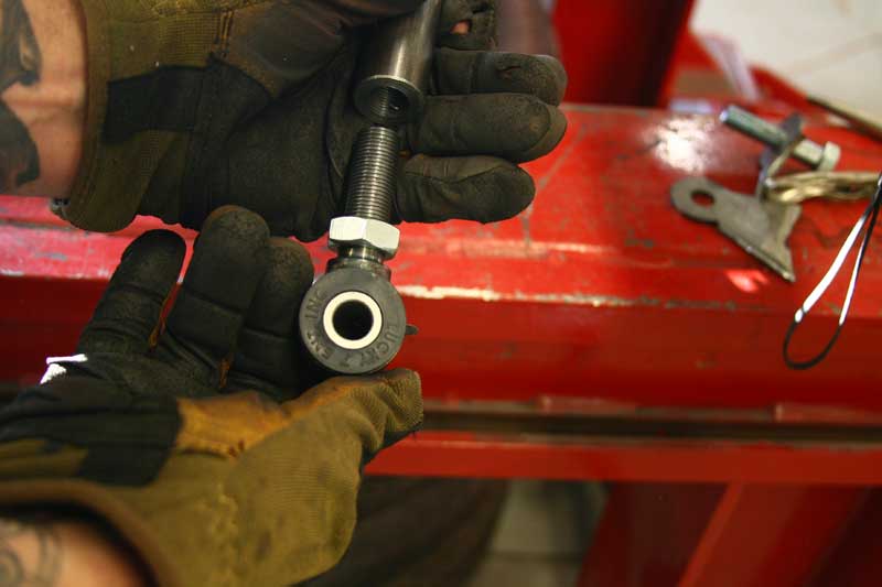

  13. Rusty Cheese
    Posts: 336
    Rusty Cheese

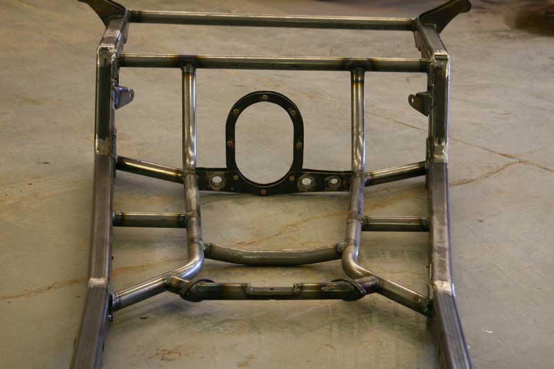

    All right lets get to the triangulated (mini) four bar.
  14. Rusty Cheese
    Posts: 336
    Rusty Cheese
    Upper triangulated arm.
  15. Rusty Cheese
    Posts: 336
    Rusty Cheese
    Lower...
    Finished photo from p***enger side.

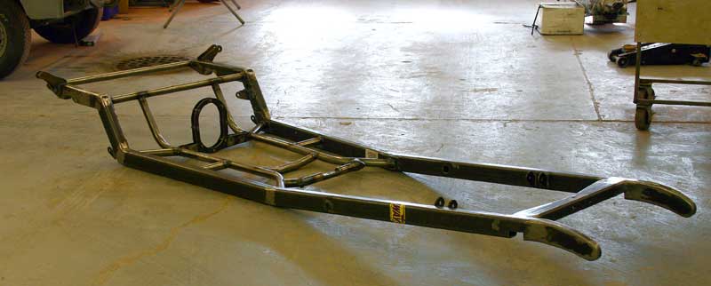

  16. Rusty Cheese
    Posts: 336
    Rusty Cheese
    Oh ya! The frame is off the bench and on the ground!

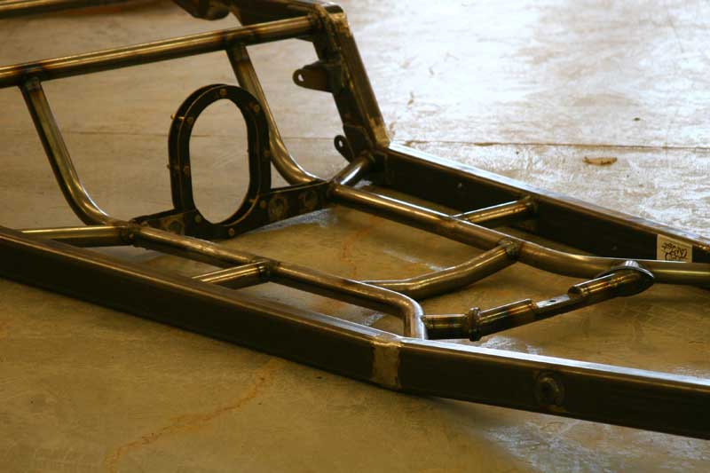

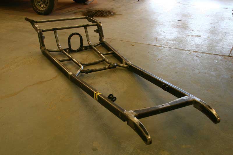

  18. Rusty Cheese
    Posts: 336
    Rusty Cheese
    One more photo that shows the kick-up better...

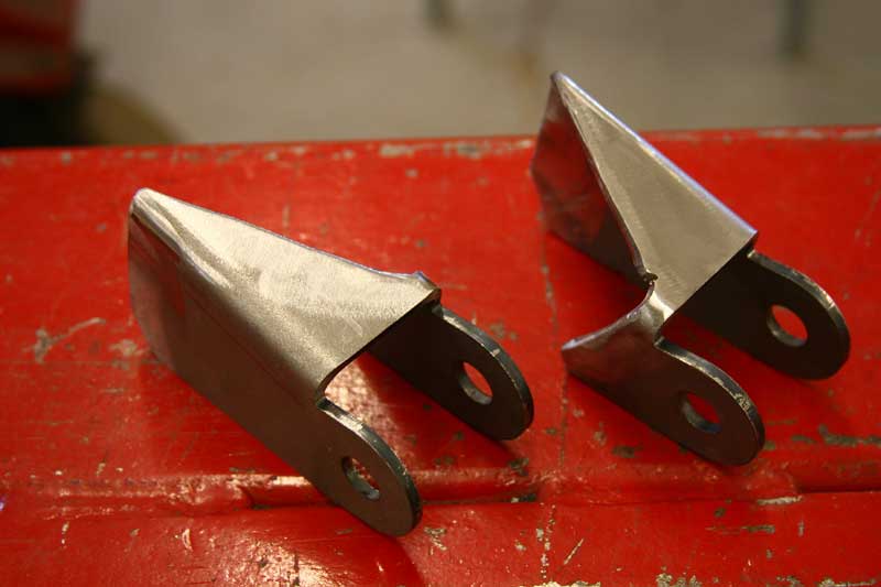

  25. Rusty Cheese
    Posts: 336
    Rusty Cheese
    To quote my instructor, "A ch***is is just one big bracket with lots of little brackets".

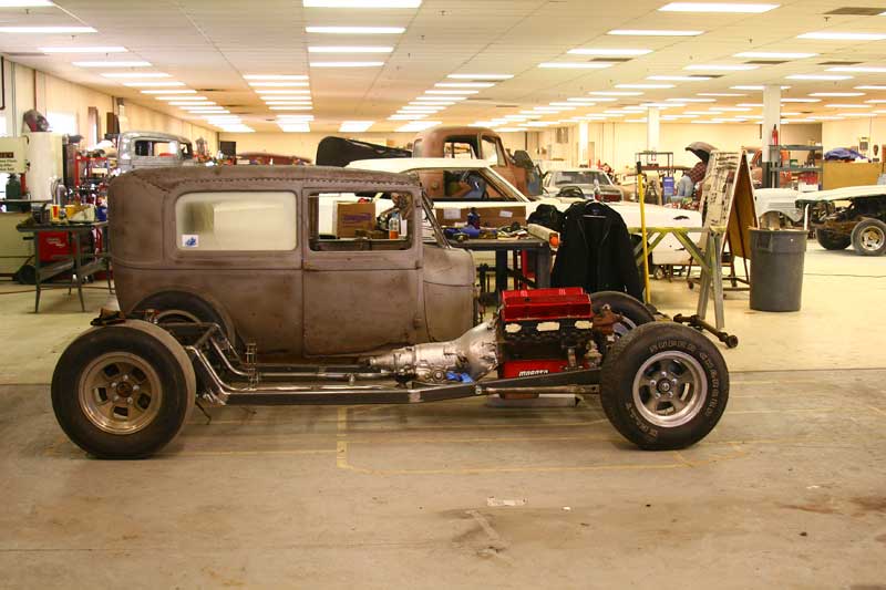

  26. Rusty Cheese
    Posts: 336
    Rusty Cheese
    This is my bracket with lots of little brackets...
