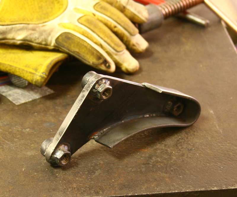

    Rusty Cheese

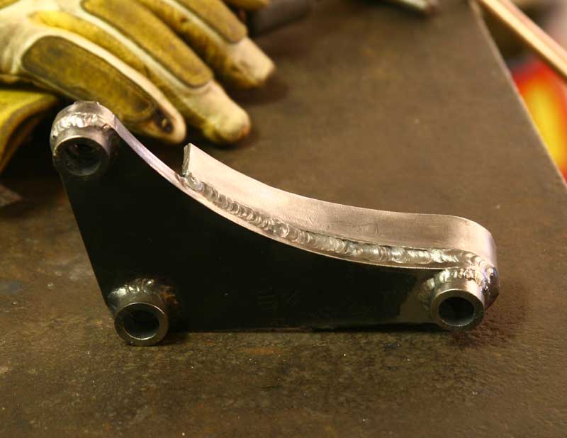

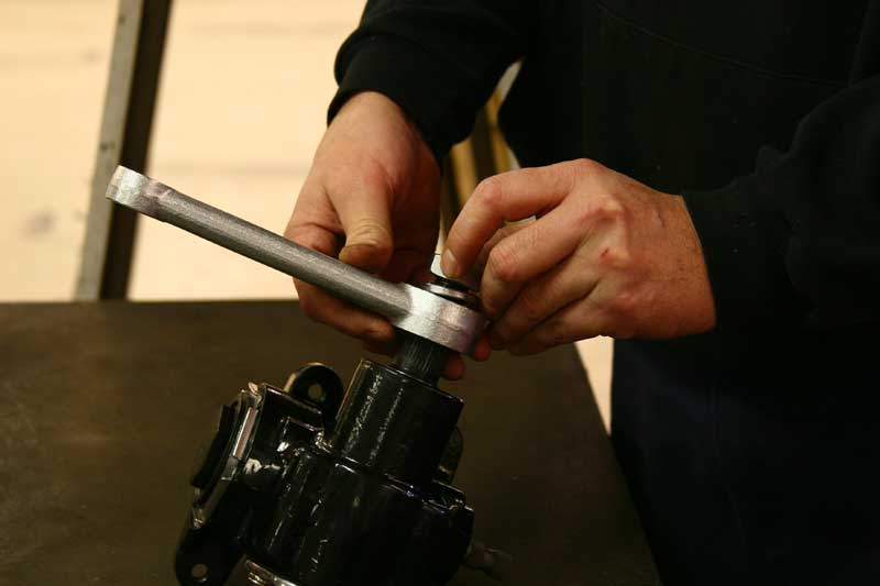

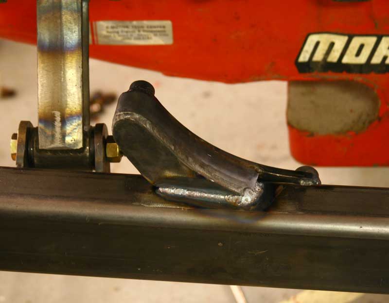

    working on the vega steering box bracket.
  3. Rusty Cheese
    Joined: Oct 11, 2010
    Posts: 336
    Rusty Cheese
    This is what the bracket looks like on the frame. I'll finish welding it and mount the box tomorrow.

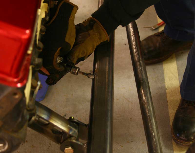

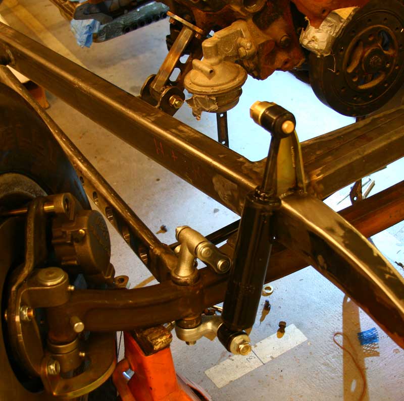

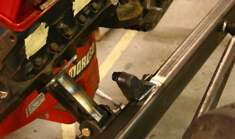

    the front shock mount is the only one that was purchased...
  6. Rusty Cheese
    Posts: 336
    Rusty Cheese
    U-bolts are on the cross member...

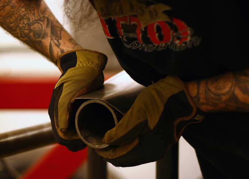

    HOT ROD BODY!

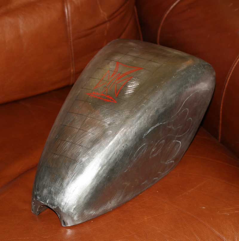

    HRB will teach you both automotive and motorcycle custom sheet metal fabrication. Students will gain valuable experience from lecture and extensive lab (hands-on) opportunities, including studying the skills necessary to design and fabricate custom sheet metal panels. Student will learn to use the tools of the professional sheet metal fabricator. Bag and mallet, English wheel, bead roller, power hammer and pullmax machine are all explored. Student will also learn to use the planishing hammer, shrinker/stretcher, hammer forms, and venerable combination of the hammer & dolly.
    Students will again begin with educational competencies in metal finishing along with MIG, TIG and Oxy-Acetylene welding. Other competencies include sheet metal panel restoration and fabrication of miniature roll pan. Complex curves are further examined while students fabricate a custom motorcycle gas tank from scratch. Automotive body construction aspects including firewalls, floor boards, rocker panels, and pillars are all explained as students prepare to execute advance sheet metal customization tasks. Sectioning, frenching, channeling, nosing, decking, shaving, and the granddaddy of all customization skills Top Chopping are all covered. Live work can include any of the above depending on the skills of the student and the student projects in the shop. Students are required to keep an hourly work log and do***ent their work with pictures for portfolio development. The resume building seminar is given during Hot Rod Body cl***; and any student not enrolled in HRB throughout their program may also attend.

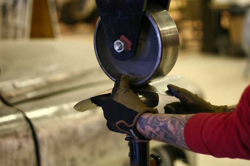

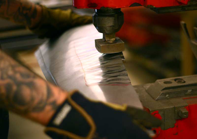

    Look for upcoming tech articles in World of Rods magazine...
    First I made a pattern of the piece getting replaced. It is a complicated compound curve. going along the body and the top of roof line. the red markings are where the paper pattern wrinkled, so that area will be shrunk on the sheet metal
  13. Rusty Cheese
    Posts: 336
    Rusty Cheese
    Used the english wheel to smooth it out. Do the above steps for a few hours and see if it fits...

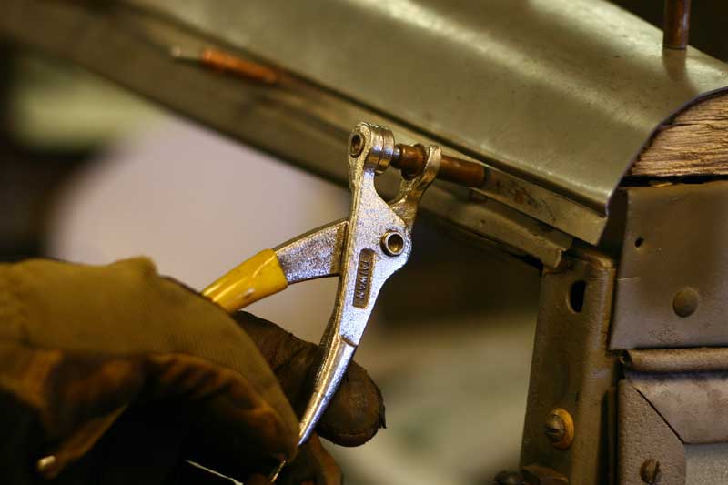

    Here are the clekos going into place.

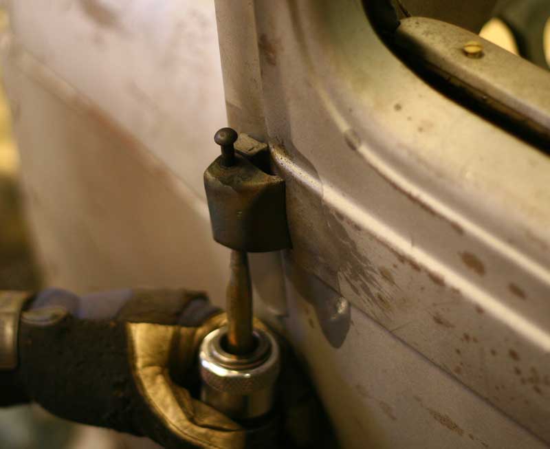

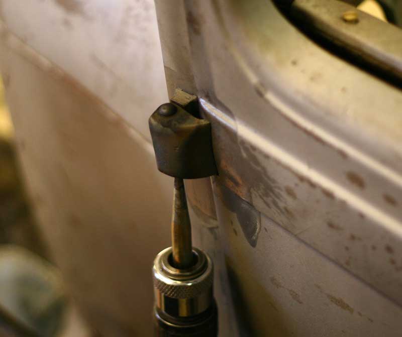

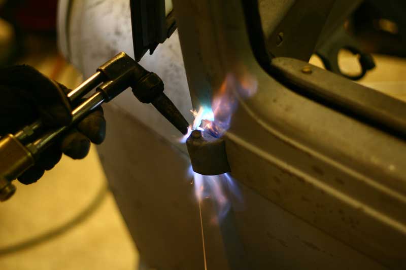

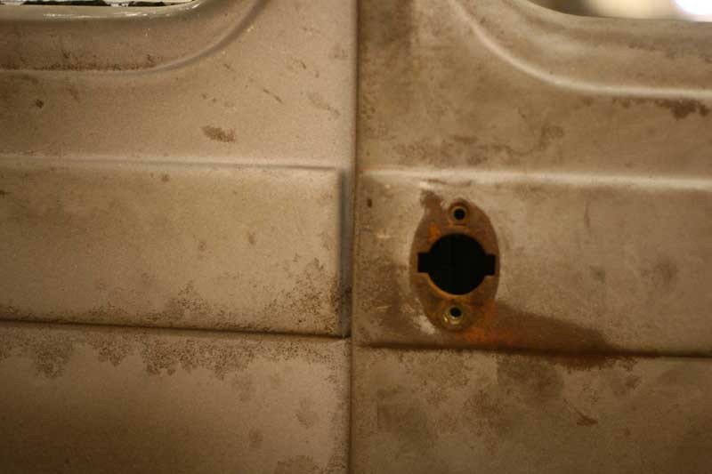

    we spent a better half of a day drilling, heating, pounding and cursing trying to get the pins out of the p***enger side door. one my my instructors read about using candle wax to remove rusty bolts on the HAMB. so the next day we tried it. it worked like a champ we had all three out in about 15 mins. heat up the metal, pour some wax on it, and pound them out. we also drove one out with just a punch. just that easy!

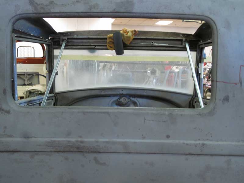

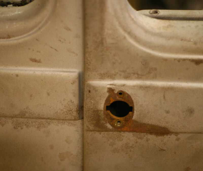

    working on the door gap and reinforcing the cab

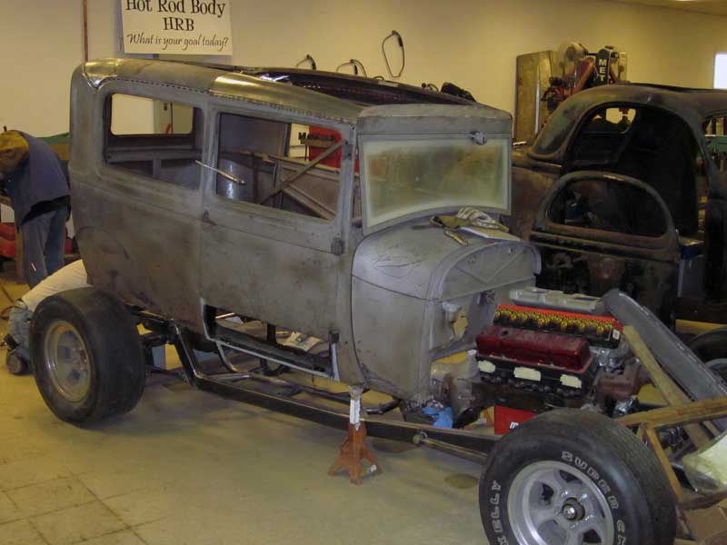

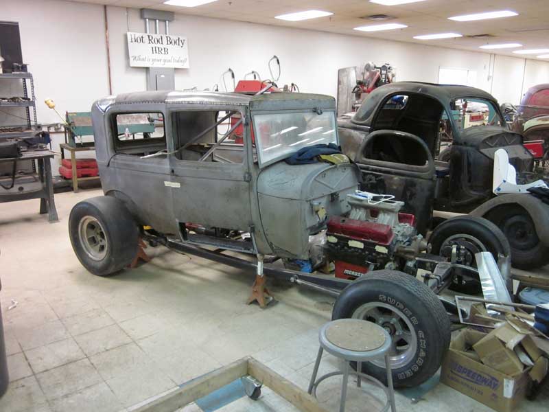

    The Munster Mobile... gotta start cutting somewhere.
  22. Rusty Cheese
    Posts: 336
    Rusty Cheese
    Getting closer...
  23. Rusty Cheese
    Posts: 336
    Rusty Cheese

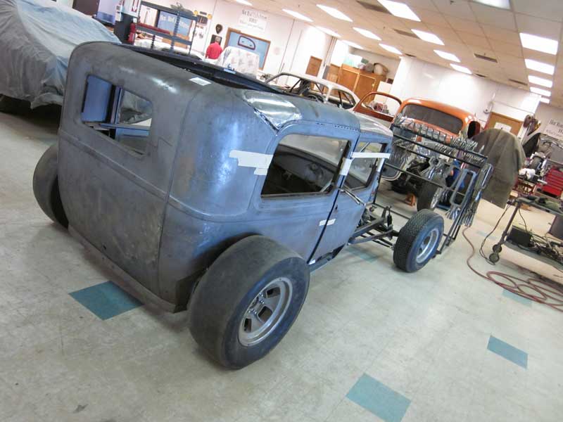

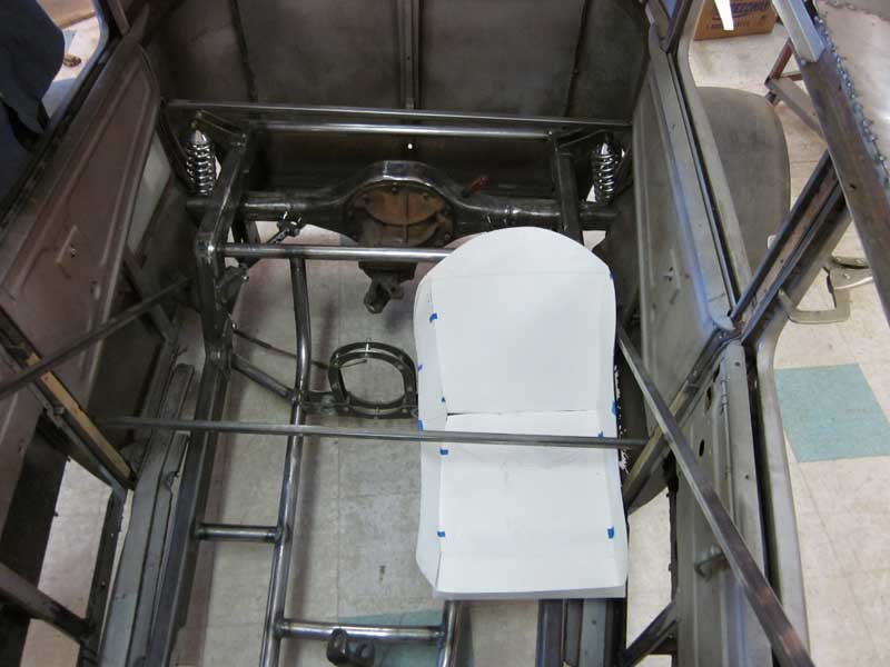

    All braced up and looking good, very close to ride height.

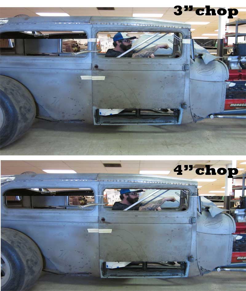

  24. Rusty Cheese
    Posts: 336

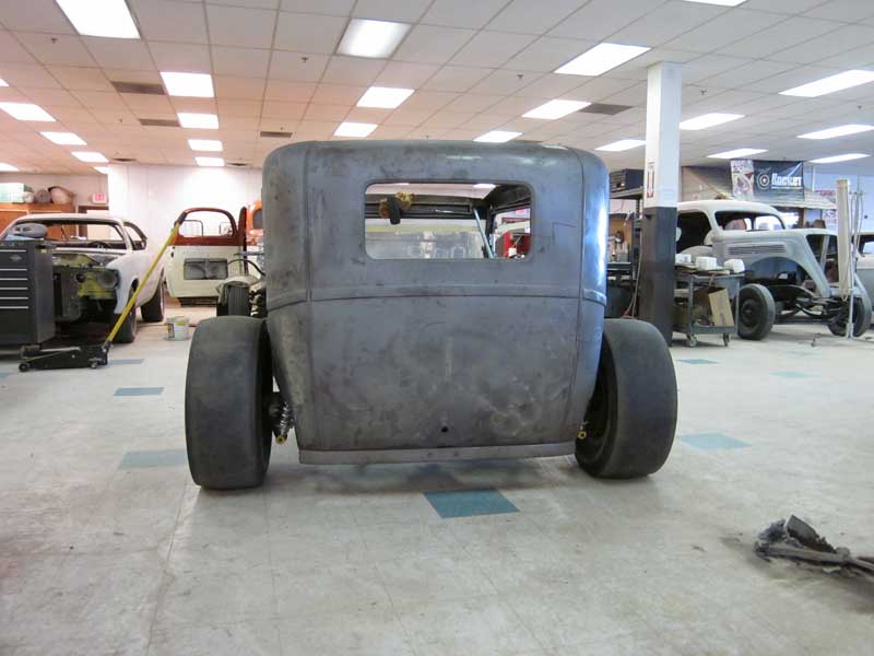

    Rusty Cheese

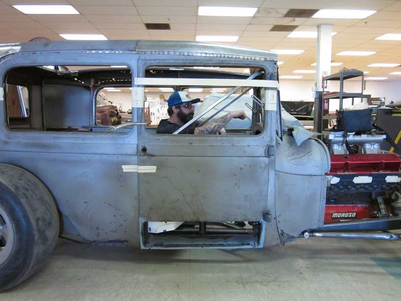

    How much to chop that is the question... 3 or 4 inches??
  25. Rusty Cheese
    Posts: 336
    Rusty Cheese
    Last image photoshoped at 3" chop...

    hey curt, it looks *****in, your making good progress. i like the 4 inch chop

  28. HotRod33
    Joined: Oct 5, 2008
    Posts: 2,570
    HotRod33
    A 4 inch chop will look great........
  29. Rusty Cheese
    Posts: 336
    Rusty Cheese
    Looks like lots of votes for 4''... i think i'm going to do 3" and if i don't like it i can take off another inch.
  30. pregrid
    Joined: Jan 8, 2009
    Posts: 176
    pregrid
    question is, will you have enough head room with the 4" chop?
