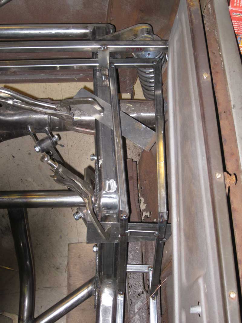

  5. Rusty Cheese
    Joined: Oct 11, 2010
    Posts: 336
    Rusty Cheese
    3/4 box tubing, making the floor... slow but steady.

  9. Malcolm
    Joined: Feb 9, 2006
    Posts: 8,205
    Malcolm
    from Nebraska
    The floor structure is looking good! I'm interested in seeing what you plan on doing to connect the structure to the frame and to the body.
    I'll be making new subrails for my 'A' Roadster on '32 rails soon, and I'm looking for some ideas / how-to...

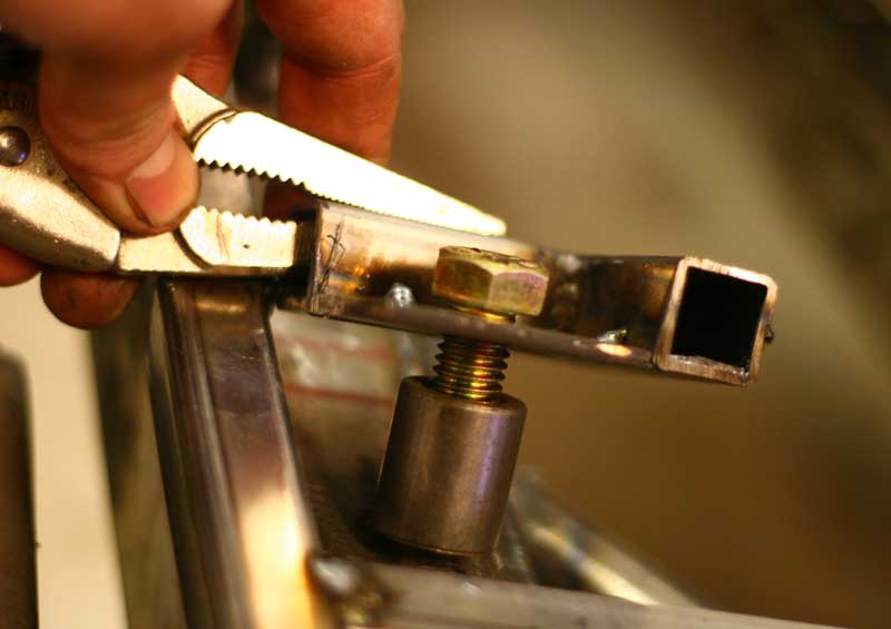

  10. Rusty Cheese
    Posts: 336
    Rusty Cheese
    Rusty Cheese

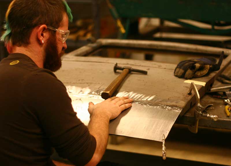

  12. Rusty Cheese
    Posts: 336
    Rusty Cheese
    oh ya BUNG KING.com. tell him to make more hot rod parts!

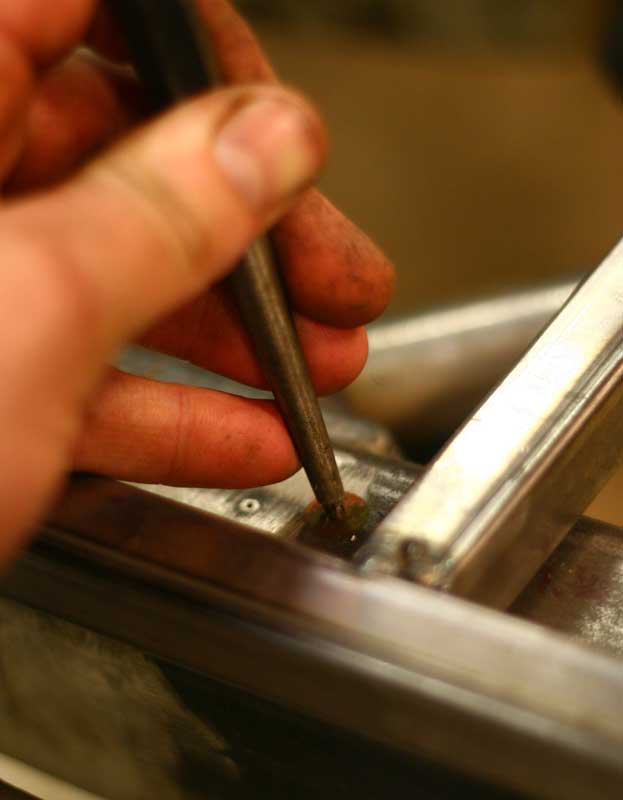

    dont drop the bung into the hole after lunch. it ****s. not that i did that...
    clean your metal!!!!!
    Posts: 336
    Rusty Cheese
    nice tig next to my mig... not bad for a couple students.
    thanks for all your help today kellan. he came over and helped on my build while he was waiting for his deck lid to cool...

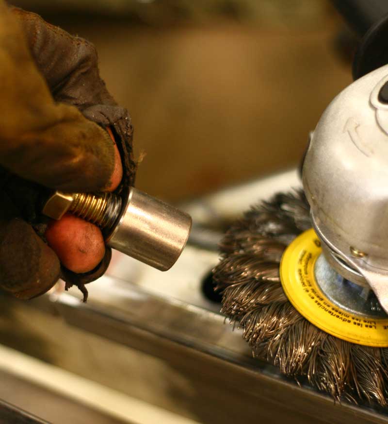

    dont forget to chase the threads after they KOOL!

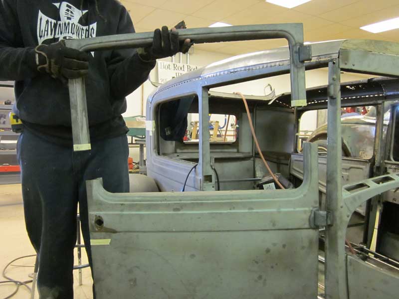

  23. Rusty Cheese
    Posts: 336
    Rusty Cheese

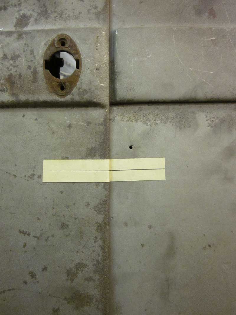

    The moment we've all been waiting for. CHOP TOP TIME!
    Door aligned and marked with pen not a marker. Lets start cutting!

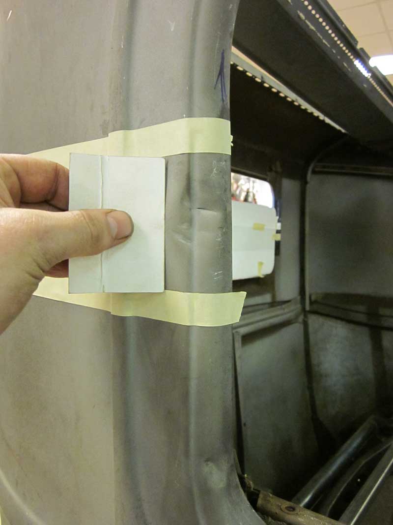

  24. Rusty Cheese
    Posts: 336
    Rusty Cheese

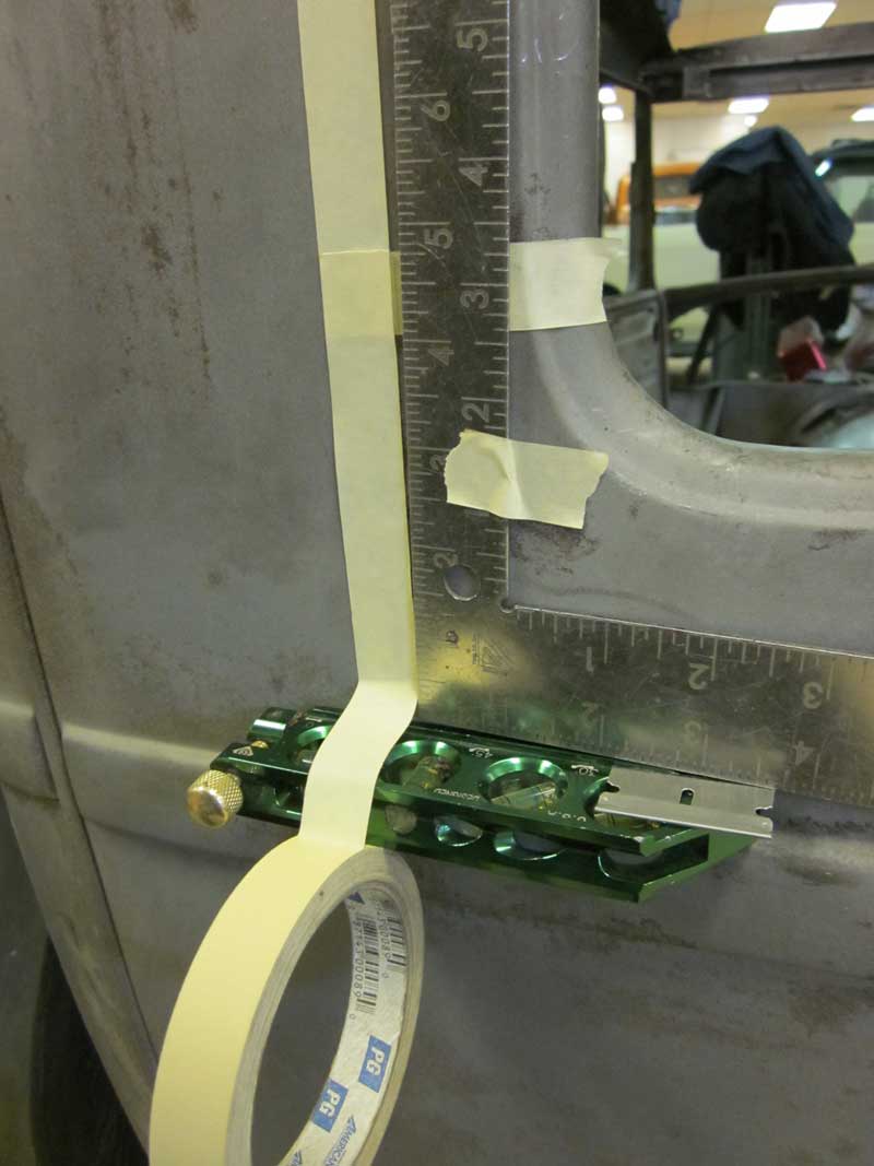

    Measure three times cut once, after lunch...
  25. Rusty Cheese
    Posts: 336
    Rusty Cheese

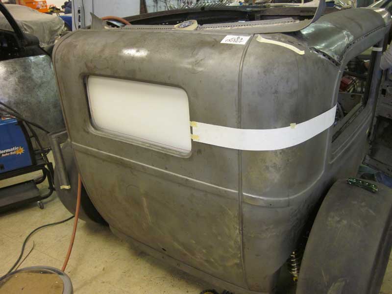

    so after lunch I had my buddy check out the layout for the chop. he noticed that i was really close to the bottom radius of the window. hard to weld and grind in that area. i wanted to go that close for a staggered cut by the rear window opening. what to do???
  26. Rusty Cheese
    Posts: 336
    Rusty Cheese
    so we decided to cut the three inches out of this bad spot on the rear p***enger window. so no more staggered cut, lets just get to cutting it up!

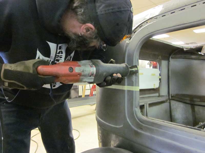

    more photos of the chop... started with a saws-all then used a cutting wheel. too excited to take more photos when i was cutting.

    thats where all the tools went. there she is with a 3'' chop.
