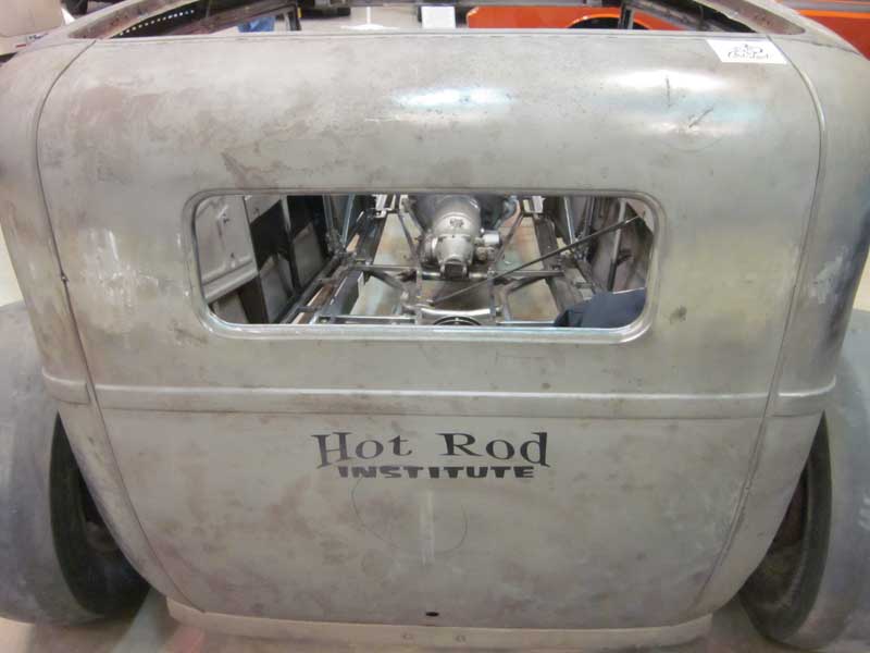

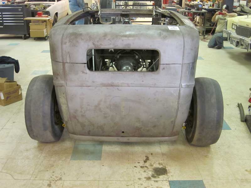

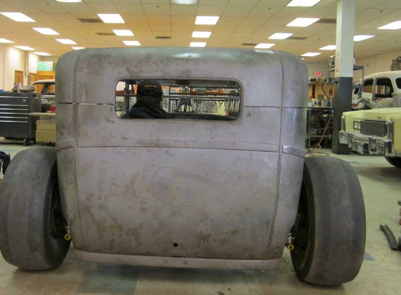

    mess all cleaned up, lets take a look.
  2. Rusty Cheese
    Joined: Oct 11, 2010
    Posts: 336
    Rusty Cheese
    view is great, yes we braced the inside...

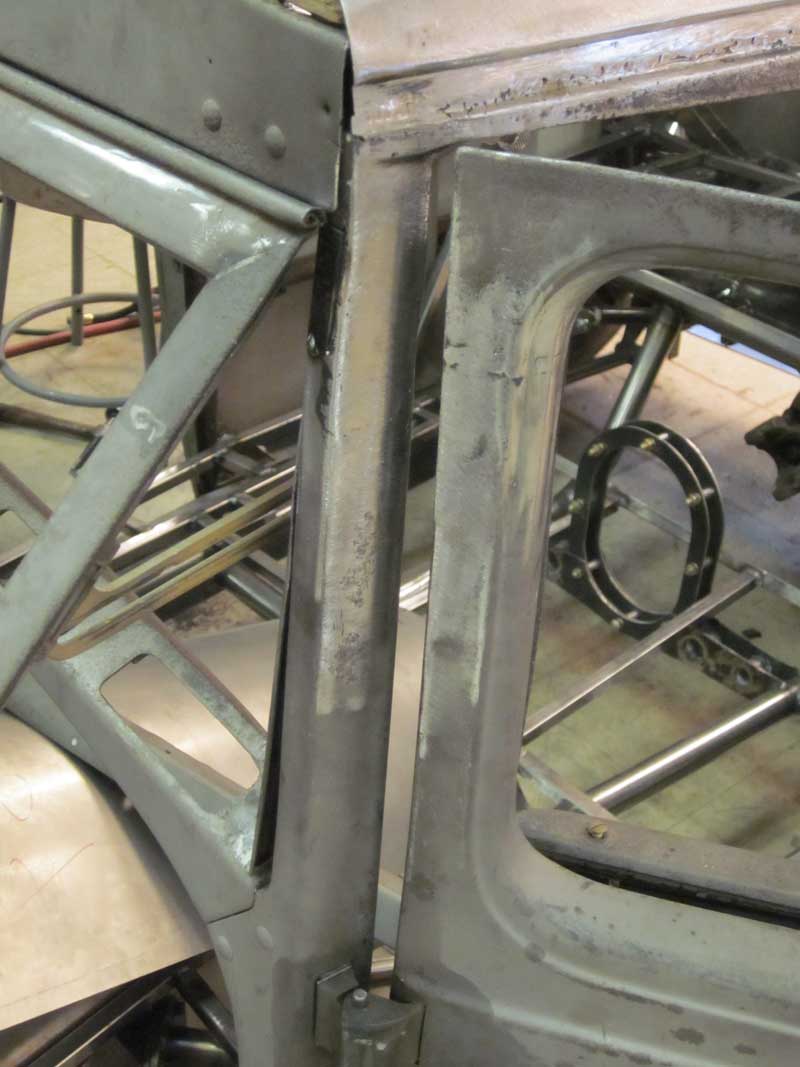

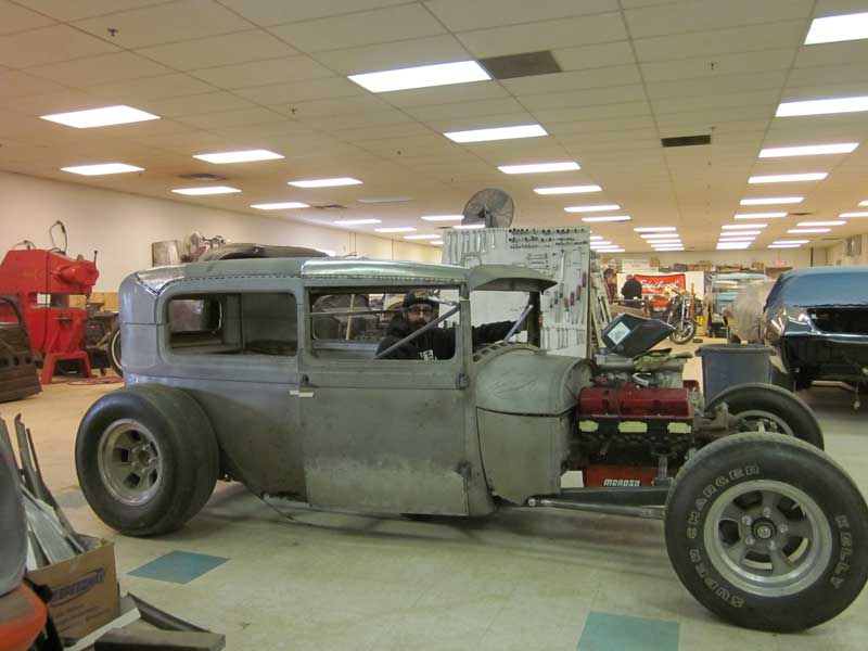

    bracing the roof, a look with the top off.

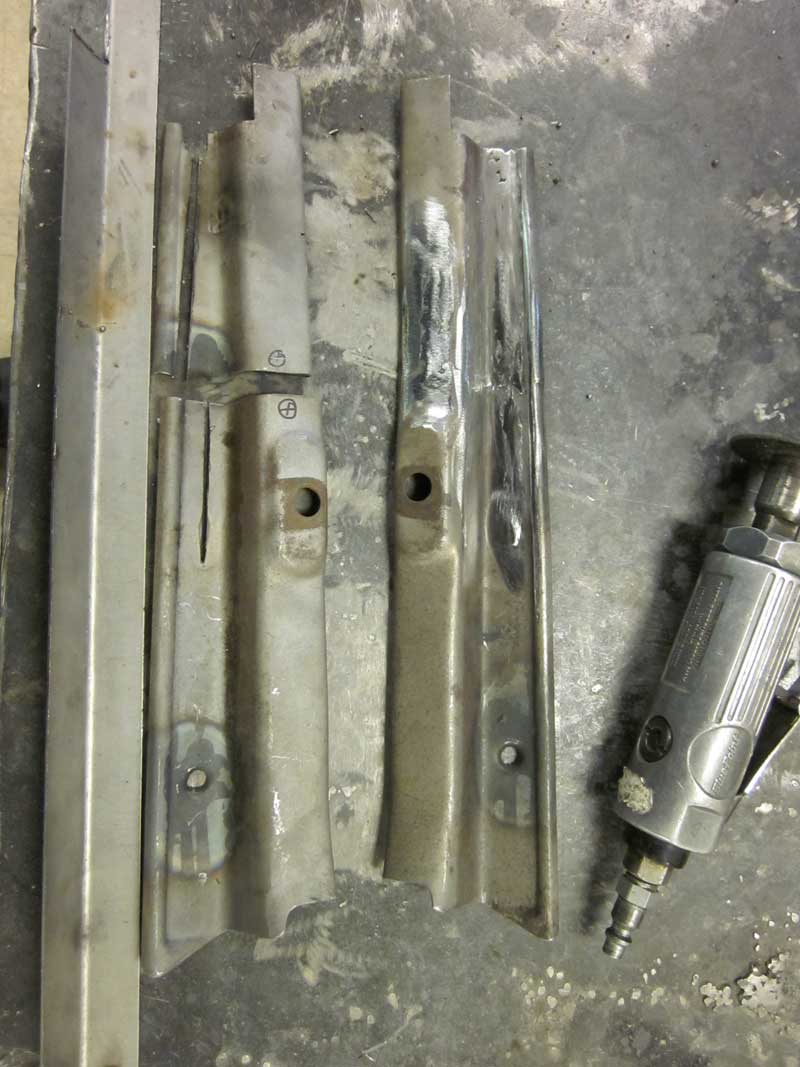

  5. Rusty Cheese
    Posts: 336
    Rusty Cheese

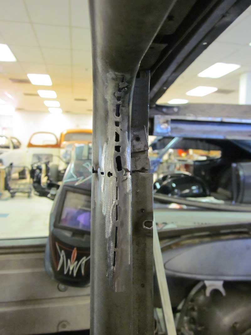

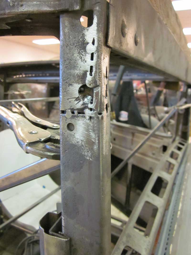

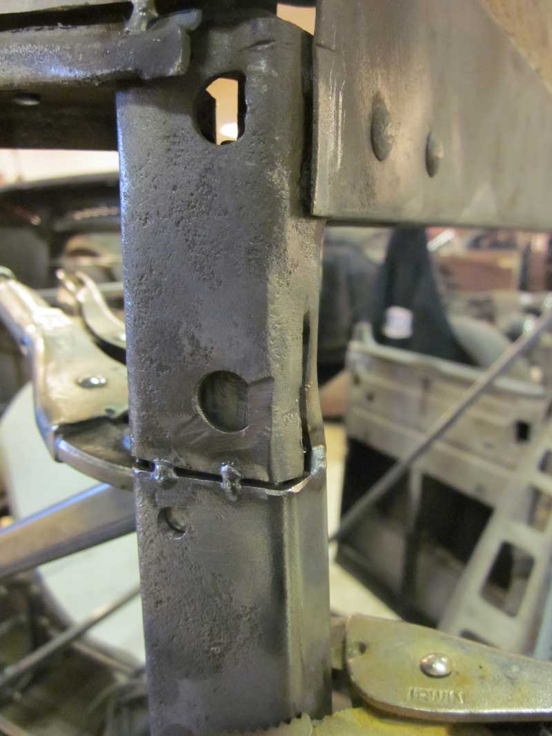

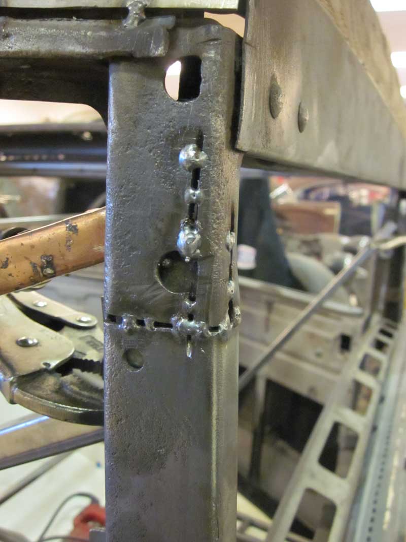

    A-pillar was sleeved and needs some work...
  6. Rusty Cheese
    Posts: 336
    Rusty Cheese

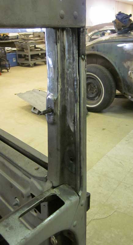

    looking better

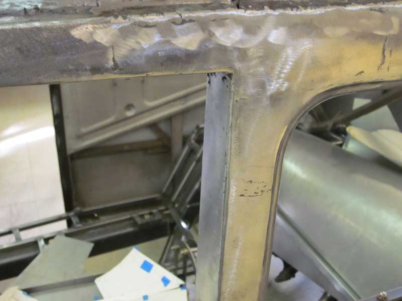

    Rusty Cheese

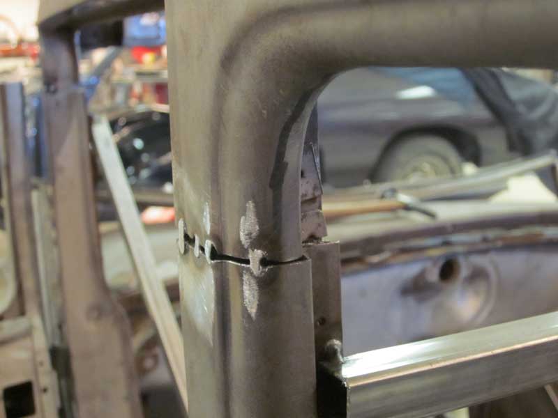

    B-pillar, looking toward front of the car.

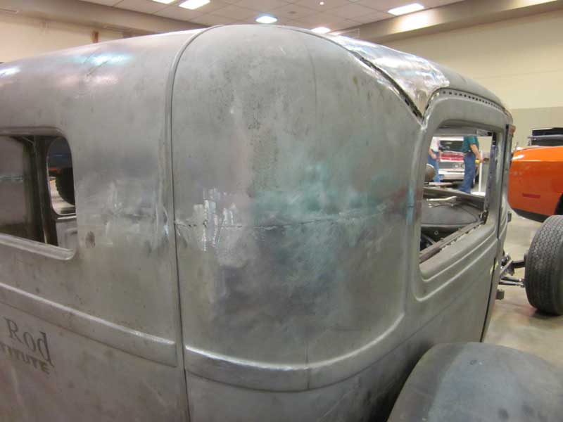

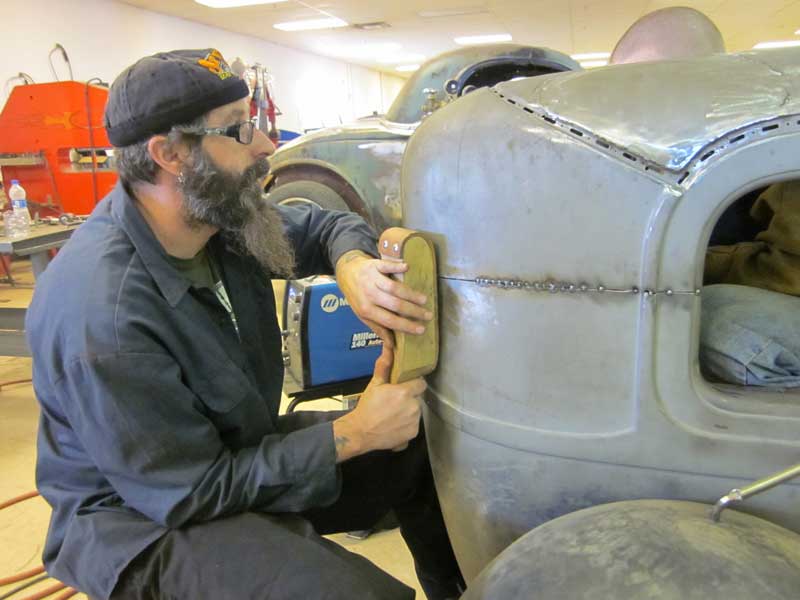

  9. Rusty Cheese
    Posts: 336
    Rusty Cheese

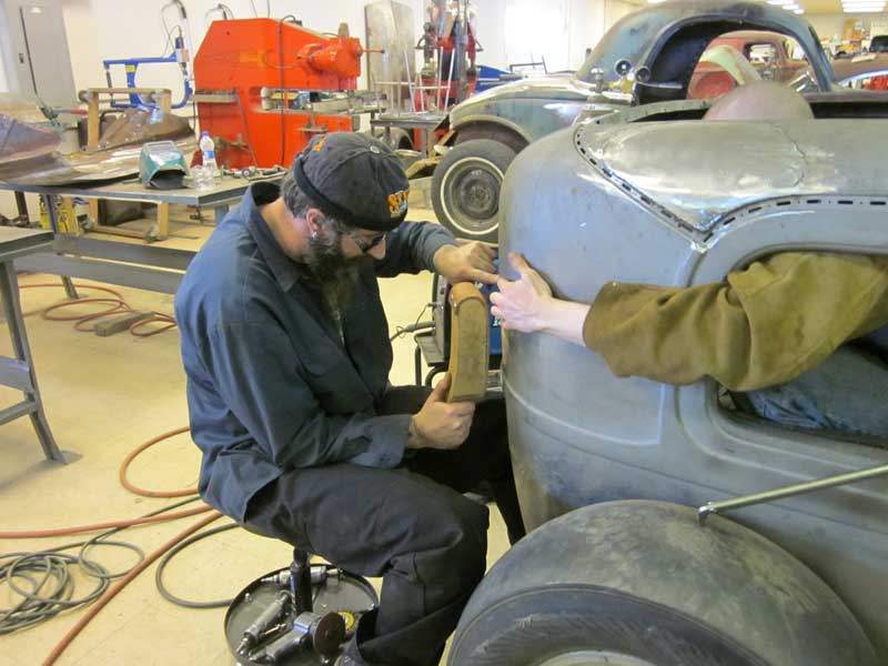

    instead of making any more cuts we decided to stretch the bottom to fit the top, and shrink the top as we went around the radius. worked well, lots of work and defiantly a two man job. couldn't have done it with out you "Fomocokid"!
    Check out the "Fomocokid" 35 build in the background!

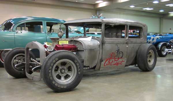

    COUNTS CAR SHOW: in Rapid City So Dak last weekend. Photos of the the metal finished chop & my little hot rodder.

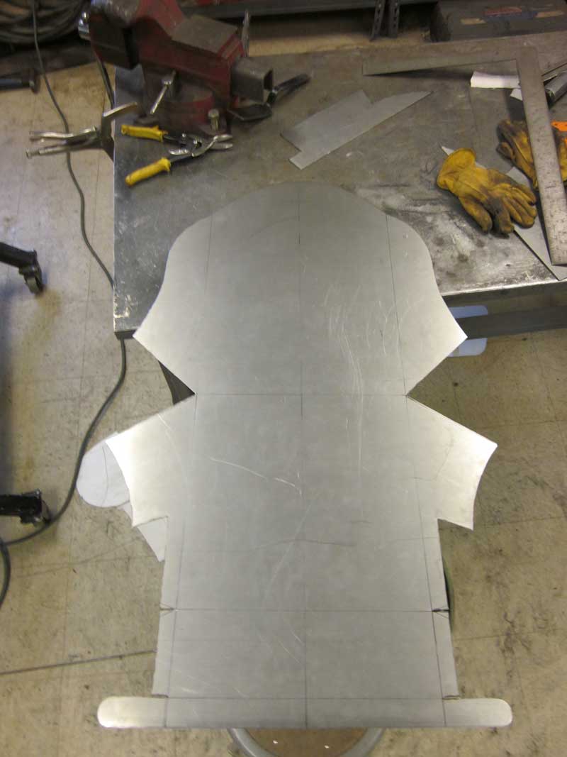

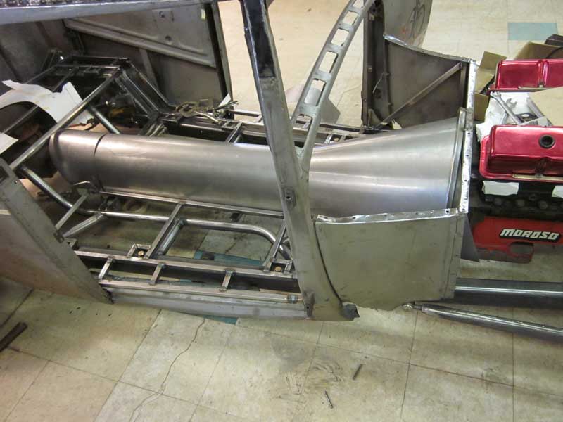

    Mock up of the ****** tunnel.
