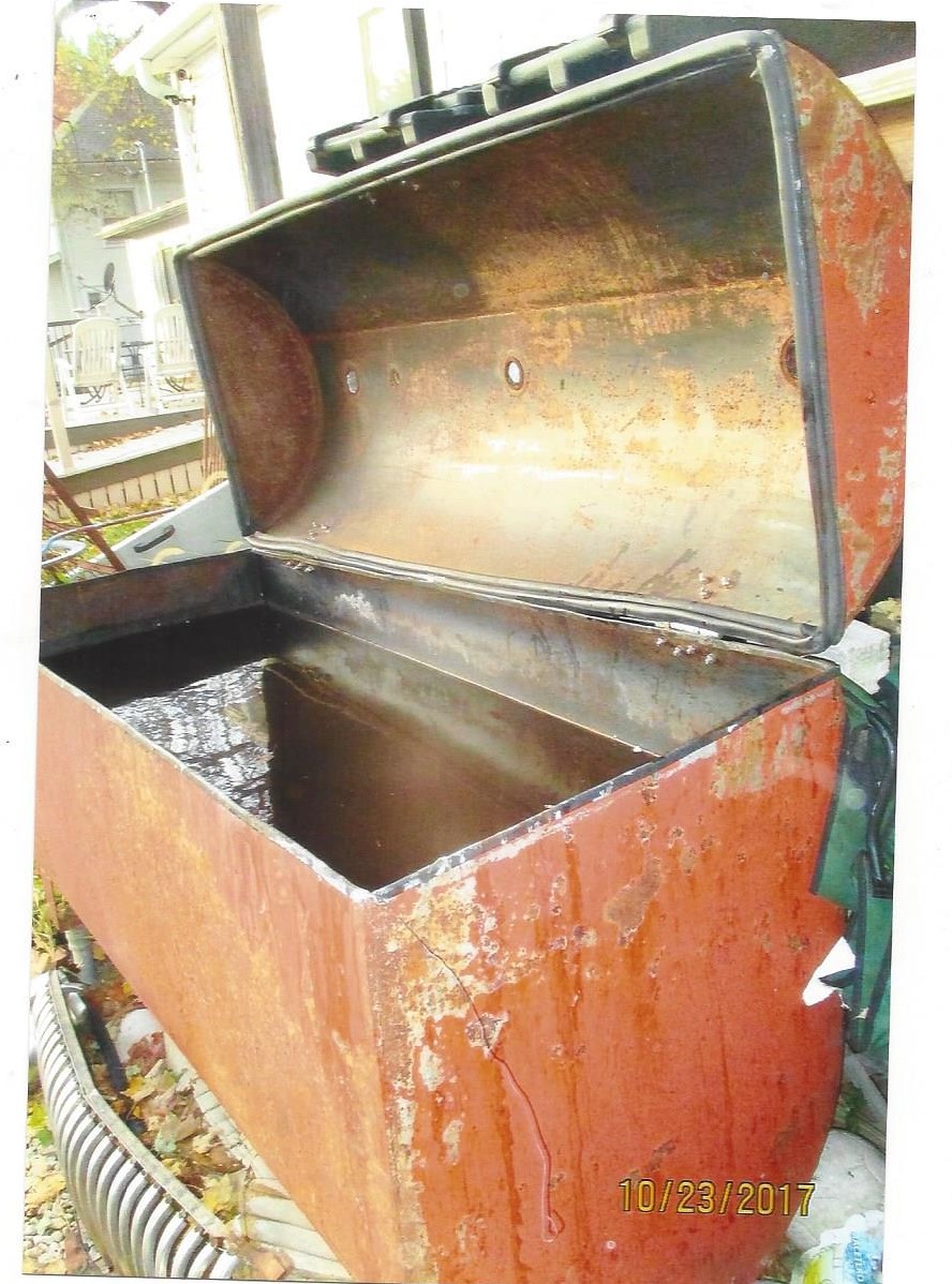

    Citric Acid, food grade mixed with water. 15 minutes in the tank. Scan0488.jpg Scan0491.jpg
