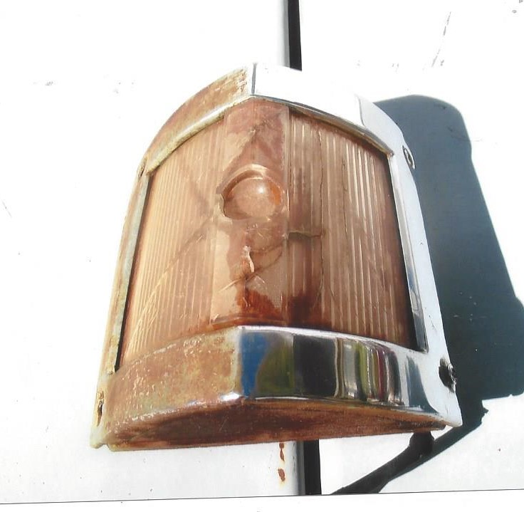

    Like I said earlier, Noxon is good if you can find it, Dupont makes something similar in a plastic bottle. Use flannel or cheese cloth so you don't scratch it up more... unless the bumpers are that bad. The parking light bezels look worse, I'd dip those in acetic acid, but check them after about 4 hours. Those.could also be blasted and powder coated/

    My prediction is that most of it should clean up pretty good with the SOS pads but this bezel may require a little silver cheat paint blended in where the chrome is completely missing., or replacement depending on what one wants.

  21. I would look for a better used one, then try the acid thing on the old one.........and post your results.

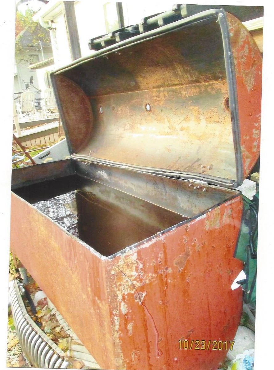

    I had this 37 Desoto bumper in my tank for 3 weeks. No polishing and no rubbing. Just hosed it off at the car wash and put a light coat of chrome polish on it to preserve it. Scan0785.jpg I left it in a little to long (Copper plate showing) as the other two bumpers look much better.

    The oxalic acid works. Do not do any cast or pot metal parts though, they will disappear. I have had similar results to what Slow motion posted. I plan on doing my bumper when I am ready to put it on. I just add oxalid powder to enough water to cover whatever part and leave it overnight. Rinse with water and done.
