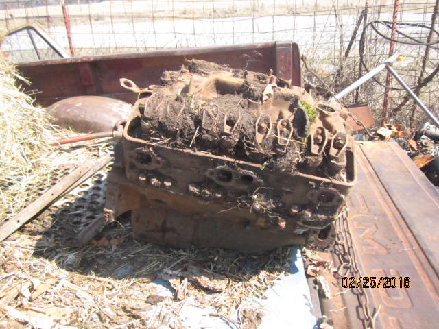

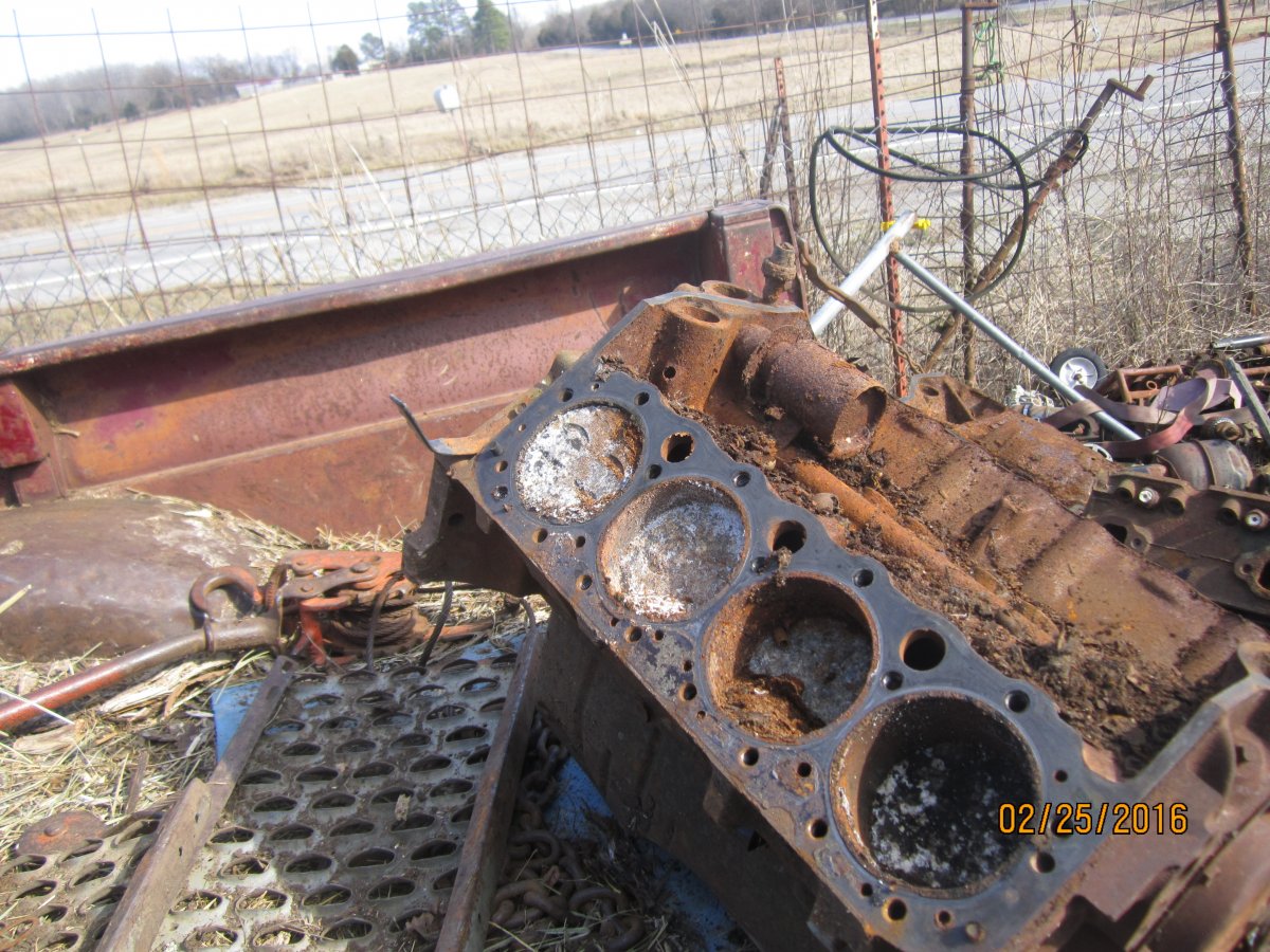

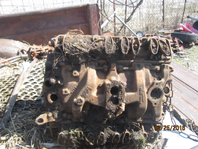

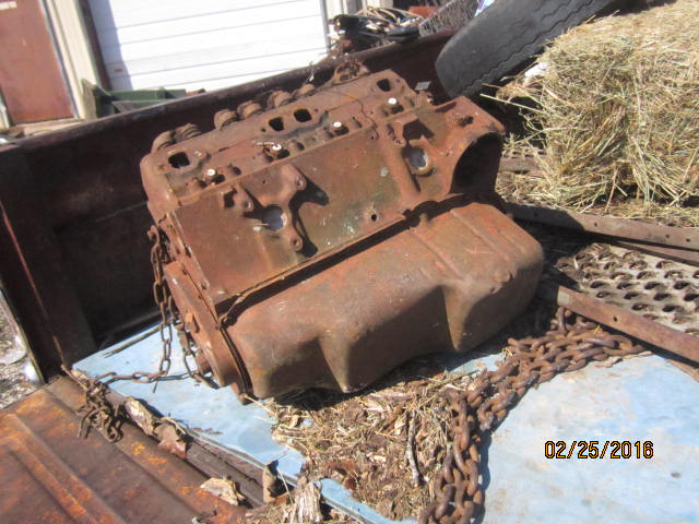

  1. About thirty years ago I bought at a auction for $22.50 . A 1959 chevy Viking. Someone had started installing a 283 engine from likely a 65 car. A few years later my daily was a 61 short bed. It had a small journal 327 in it. the clutch started slipping. and it was the small clutch. the Viking had a 11 inch clutch. And the 327 was tired and I didn't want to chance a rod bearing failure and ruin the crank. So the 283 was installed in the Pk. The rings must have been stuck Because It drank oil. Used a quart every 20 miles. I ran it for a month. It was pulled and set in a car trunk. The car soon was solkd for s****. And the 283 was set next to a tree and covered up. The engine got uncovered and set for 25 years. The intake against the dirt and the oil pan to the sky. I got to reading the post on here about a broken 283. So today I went over to my other place and loaded up the mill. It is really rusty and crusty. My plant is to build it and spend as little money as possible. So ive used the air hose and blew the soil off & tore it down. There is some really horrible looking cyl rust and the crank is a cast crank. Ive started soaking the cyls with ****** fluid. It may nee rusty crusty 283 001.JPG rusty crusty 283 002.JPG rusty crusty 283 003.JPG rusty crusty 283 004.JPG rusty crusty 283 005.JPG d a rebore. Ive got some used oversize pistons. Eny road this zombie engine might come alive again.

    Intriguing project, I will be amazed if you can rebuild this engine without replacing nearly every part. I like to be amazed.
  4. Not actually a rebuild. a overhaul kinda. After I remove the pistons & crankshaft I will put the block in a electrosisis vat with powdered mol***es. Not goung to use the can lifters or cyl heads. Would prefer to use new rings and bearings. Ive got a 305 with a bad crank. I will use those heads and cam. If it need,s a rebore I have some good used oversize pistons.

    WOW! I don't know if you're an optimist, or I'm a pessimist (always thought I was a realist) , but that's way more than I'd ever take on. Every machined surface is going to need work. I'd save the high capacity oil pan, and maybe the chains and lift tabs. Maybe you're just pulling our leg; you should have been a chiropractor! Good luck.

    Watching with interest. What are the heads, 520's? Somewhere around 80% of the stuff guys say is "unbuildable" on here, I'd call an ok core.

    Deck surface looks fine to me.

  12. The heads are the powerpack with a pyramid. I will sand the deck with 320 wet or dry and diesel until it looks like chrome. Ive has planty of experience with rusty cyls. All the ld farm tractors had a exhaust that pointed to the sky. And Ive bought several that had rained full. tear them down and just fix what was bad. Sometimes pull a used sleeve and piston ***embly from another engine and put it back together without any new parts. Even reuse the head gasket. Use it myself or it Makes a good auction sale tractor. There is guy over on the Tri Five chevy forum that has spent some where in the neighborhood of 20 thousand on a 409 and it still has problems. Im thinking around $200 on this rusty 283engine

    The cylindrical thing in the lifter valley is for the road draft tube, correct? Mine is so nasty and gunked up it isn't funny so I have not taken a good look at it, how does it work?
  21. yes that is a baffle can for the road draft or PCV. it simply keeps the oil in the engine and lets crankcase vapors out.
