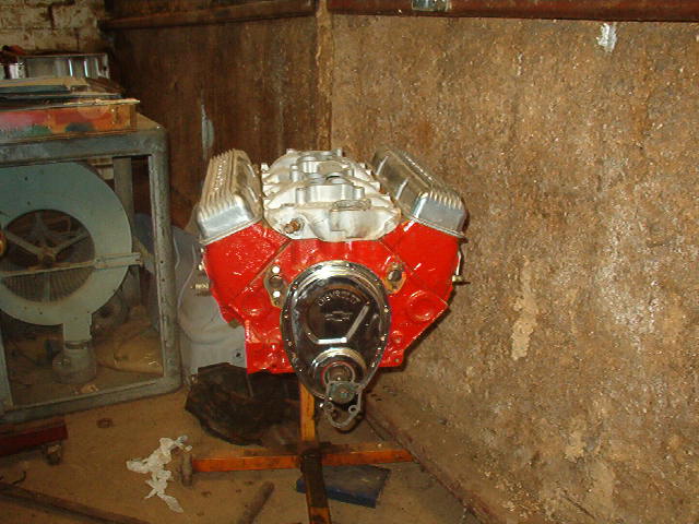

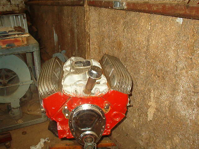

  13. 399.jpg Ok heres a picture of the engine I built for my 55 handyman wagon. the 327 block has new rings and bearings. I was in a 69 chevy wagom my brother in law bought new. The heads are stagger bolt extensively reworked 57 heads that came on the first 55 cheve I ever owned. The valve covers are some cal custom finned one,s I bought when I was a teen. the intake a C4B ive had for decades. It has a new 30-30 cam. Now ive got 202 heads that have all new valves ect. and plenty of different intakes. And I know the cam leaves a lot to be desired. But I wanted to use my old parts. I also have a set of corvette valve covers and a two four intake that could go on it. 398.jpg
